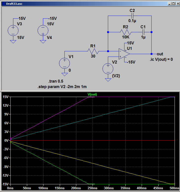

1.I tried simulating the same circuit standalone. But the output always saturates for both AC and DC signals. The values selected are R1= 30 ohms. Rbias is open. R2=10K, C1=1uf, c2= 0.1uf. Vref was made 0V and changed to other values, still output saturates. Where am I going wrong?

The type 2 circuit is an integrator, so even with identical Vin and Vref, the input offset of the opamp will be integrated, eventually railing the output of the opamp.

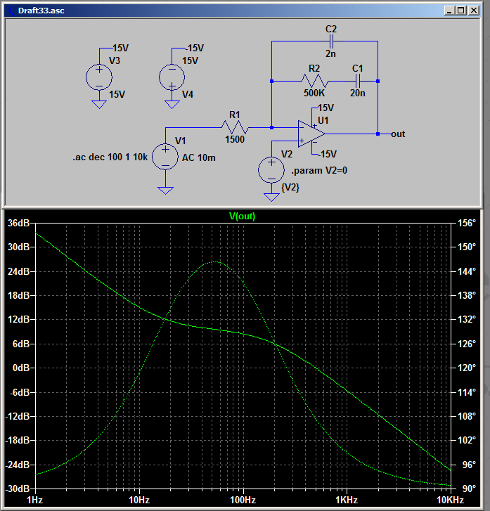

In order to simulate the open-loop frequency response of this circuit, you will have "close the loop" for DC, or use an "ideal" opamp which has zero offset referred to its inputs.
The simulation shows an ideal, zero-offset amplifier from the LTSpice library. I make the offset -2mV (green), -1mV, o, +1mV, and finally +2mV (violet). If I force V(out) to zero at the beginning, the simulation shows how fast the amplifier rails just integrating the offset.
Since the ideal amplifier holds its output constant with respect to the dc bias problem, it is possible to see a Bode plot with a 10mVac input. I question why R1 is so low?

So make R2=500K and recompute
Does this have the same Bode Plot?

There will be no saturation in "real" feedback system. The saturation you are seeing is because you are trying to simulate only the compensation circuit in isolation from the rest of the system.
