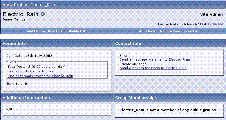

This is an old thread and it says on Electric Rain's profile he hasn't been here since 5th March 2004 so I can assume he's no longer with us :(
But he's a site admin, wtf?
He's listed as a site admin in his public profile... I would guess that it is out of date information?
What I did , and I can only assume Hero999 did also, is click on Electric Rains' name as a link, and you get a pull down list offering to see their public profile amongst other things. When you click to view their profile, in his case it says "site admin" instead of something like "electronics god", etc.
I'm sure it is either a left-over from the old board, maybe the databases' did not transfer all fields correctly, and only active members were "cleaned-up"
the profile shows as site admin
