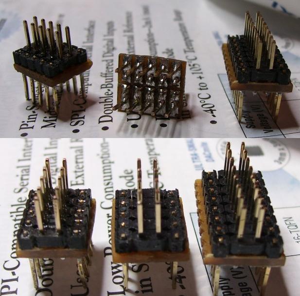

Not that I am being lazy, just a little frustrated. I've paged thru my mouser/digikey/etc catalogs looking for some 2 row headers that have a long enough tail to split and bend to fit the midline of a breadboard row. I know they're out there, I've seen them used in project photos often but no part numbers or references are given. Would someone kindly toss some appropriate part# references or URLs please? :)

Maybe I'm missing the point here..but I just use these:
Then bend the 'long leg' at a right angle to the plastic holder, and straighten out the ither side..
Failing that, knocking up a simple adapter on stripboard works.
Blueteeth
standard male header pins, 2.54mm or .1in the problem with inverting typical pins such as above is that often the tail side is too short for a socket to maintain connection without popping off. i have found some that are made by various mfrs with a mating length of .5in and a tail length of .8in which would work perfectly -- but of my growing list of supply sites, nobody carries them.

But if what you need is a pin header that will stay put in the breadboard you can solder the short ends of 2 together and have long pins on both ends. I use a post it note with the glue sides up to hold the little bits in place while I make the first joint. A bit of liquid flux helps.
aye, i mean for one row to span the inner column of the left hand side and the other row to span the inner column of the right hand side. i might have to do that in the short term but i'm still looking for long tail headers for the future connectors =]

I know this is really geeky but when I prototype with breadboards I always need double row headers for IDC cables (AVR pinout, PIC dev boards. LCD's etc..) I tried looking for the long pin headers, but gave up. So, 3 minutes with standard single row headers and stripboard...I built these.
You only need to cut between the rows of pins, I did it with a craft knife. The cool thing about this is you can make a 2x20 double row header, then cut it up into smaller ways, that way you only really need to make a couple of these.

My thoughts were he was after an IDC header which would span the gap on a breadboard, so I thought of an IDC header for wire wrap which he could bend the tails at 90 degrees twice to cross that span.

thank ya guys. you know, you can never find all the pages in your history that you "just visited" over the last ~72 hours where you saw various things. i know somewhere on ladyada's (adafruit) site i saw pix of these long tail headers. nor can i find the reference in the forums that led me to it. nor on avrfreaks :-X oh well. when i find them again, i'll try to find this topic and bump it with a url or two.
in the mean time i think i'll go with the small board idea that most people seem to be using. SparkFun has a simple one for a buck at https://www.sparkfun.com/commerce/product_info.php?products_id=8508 and i've been re-learning a few things in eagle making my own design. i figure if i'm going to do a board, i might as well try to learn something additional in the process.

Fyi, I found a website (www.samtec.com) that lets you build a part number bit by bit and then order samples of it. Thusly you can build the headers that I'm looking for. TSW-150-28-G-D-001 should do nicely. .230in mating length with .8in tail length.
