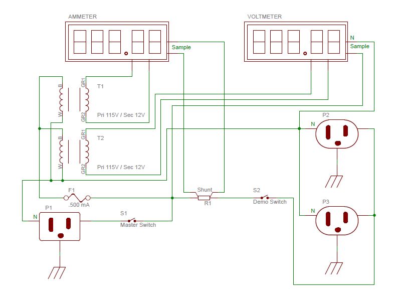

I have this design for North America:
Note: my drawing is not perfect, P1 is the power source from the house 110V.
The purpose of this circuit is to plug a motor or other devices in P2 or P3 and get the Amps reading while monitoring the supplied voltage.
Now I need to reproduce this for example: Dubai on 220 Volts.
Questions:
1 - Can I connect two 110V transformer's primary in serial and still get the 12 Volts secondary from each?
2 - Do I need to double the shunt resistor to get accurate Amp readings?
3 - Does the 50hz affect anything in the circuit?

1- Only if they are two identical transformers and the secondaries feed identical loads. You might get away with it, but 220VAC transformers are readily available. In your case I would get a single 220Volt transformer with two isolated secondaries. Search for brand name Signal Transformer, DPC or DST series and choose one with the appropriate power your displays need. Wire the two primary windings in parallel for 110VAC, or in series for 220VAC. Use the two secondaries individually for your two displays.
2- Only if you change the scaling on the Amp display too. The voltage across the shunt for a given current won't change just because the system voltage doubles.
3- In most cases, no.

Don't do it.
As I said before, you can only series two identical primaries if the outputs of both are loaded equally. If one output is loaded and the other isn't, then they will have different primary currents. This mismatch will show up as an imbalance when you try to series connect them, resulting in different voltages across the two primaries.
Both my transformers are identical, If I connect the primaries in series and drive the ammeter with just one transformer, when you say it will create an imbalance are we talking about a few volts or enough to blow the transformers?
The ammeter requires 8 to 12 volts AC so if the voltage drops by as much as 4 volts I am still ok.
If not, can I calculate the current used by the ammeter and connect a resistance as a dummy load on the other transformer?

You can't to it. It will have an adverse effect, even if there's only a slight imbalance. The only way to use two identical transformers' primaries in series is to also have the secondaries in series (or parallel) so they can share the load.

I only need one source of power so if I connect the secondary in parallel am I good to go?

If that is the case, instead of putting the two transformers in series with the secondaries providing separate supplies, think about this:
Where you have to power the meter from 240v, use two transformers in each position. ie a total of four transformers for each unit.
Connect the primaries in series to give the 240v operation, and connect the secondaries in parallel to give the 12v for the meter.
While this looks to be an extravagant waste of transformers, if you already have them at low cost, and there is sufficient space in to box to accommodate them, why not use them?
I have found a voltmeter that doesn't need to be powered from a low voltage so only the Ammeter will be powered.
The voltmeter I have is powered directly from the live where it gets its sampling from and supports up to 500Volts. Therefore I would keep my original 2 transformers, connect the primary in series and secondary in parallel.

If the voltmeter works directly from the supply, then using two transformers for the ammeter makes sense to me.
I don't think that you will have problems with smoke and flames!;)

I am looking at a next revision for my project using this transformer: https://www.farnell.com/datasheets/92146.pdf
I will make a small PCB with two headers and heat shrink tube.
The specs call for 230V primary with no indication of max. If fed with 250V I am safe with an extra volt on the secondary but can the primary take the extra 20 Volts?
In my original design I have a fuse in line with the transformer as I was using surplus stock, for this new transformer based on the indication "INHERENTLY SHORT CIRCUIT PROOF TRANSFORMER" can I safely remove the fuse?
There is a transformer design called "Energy limiting" and a short on it's output causes the transformer to heat up a bit, but no damage occurs. You sometimes find these on Furnaces.
