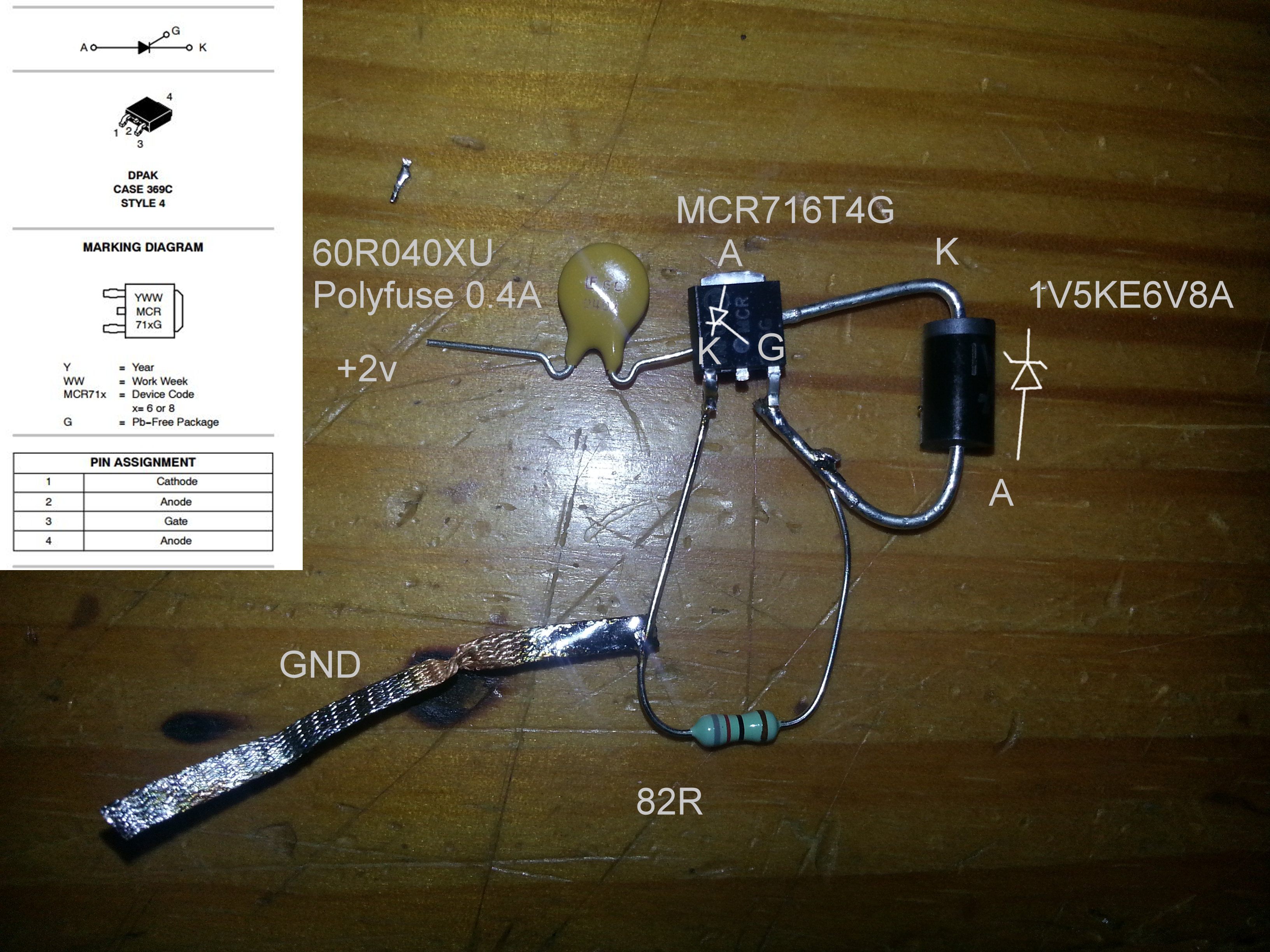

Hi all,
Well it was the lack of caps causing the MCU reset and I have taken the advice of NOT using a TVR but instead I chose a crowbar circuit. This time I have provided everything, even a picture of the circuit (all be it a few component thrown together very quickly to test it). this circuit does not behave as I think it should and that is, using a bench PSU at 2v the polyfuse is activating as if there is a dead short and I cannot understand why, from what I understand this should be OK upto 6.8v approx then the SCR should conduct as the zener breaks down and activate the polyfuse.
P.S. please forgive the nasty solder braid as a earth wire but it was to hand and I hope this time I have given enough information. also I will be putting a cap in there but wanted to get it working first.
Steve

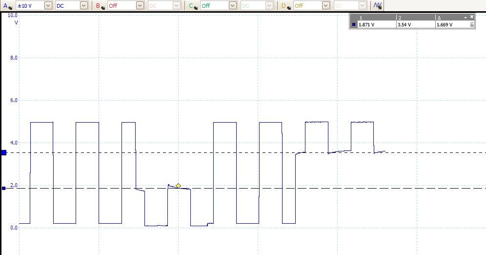

Hi all,
I am beginning to despair with electronics as I hate keep asking what I feel are stupid questions! but here I go again.
The EL7232 is a push pull line driver capable of sourcing / sinking 2A between 4.5v and 16v but the inputs can be operated from 3.3v
Here is what I do:
1A 5v regulator MC7805CDTRKG
EL7232
Atxmega running at 3.3v
The 5v regulator supplies only the EL7232, I have a separate regulator for the MCU
Set pin 1 (3-STATE for line A) high at (3.3v)
Cycle PIN 2 high and low at 3 second intervals, this should drive the output, pin 7, high / low (inverted)
To test the "PULL UP" I connect the output it to ground via 6ohm resistor, I see the output drop from 5v to 1.73v and it see it drawing 290ma approx
To test the "PULL DOWN" I connect the same resistor to the output of the 5v regulator and I see 3.54v and drawing again 290ma approx.
So here are my questions
  • Why does the EL7232 not pull harder and keep the line high / low as it cycles
  • Why do I only see 290ma through the resistor when it should be 833ma approx (5v/6ohm = 0.8333)
Is this something to to with VCC to the EL being 5v and the pins being driven at 3.3v?
I hope someone can help and please please please do not get pissed off with me, I do spend a lot of time trying to figure it out before thinking of posting, maybe too long!
Steve

All you need to apply is Ohm's Law with an understanding of each driver output impedance and the power dissipation temperature rise.
However, you do need to provide a full schematic with photo of layout for details.
The 3 terminal regulator is a regulated Emitter Follower with current sense with OCP and OTP internal.
The EL7232 is a logic level MOSFET half-bridge switch with 3~5 Ohms RdsOn which will not draw 2A under the circumstances. Use a better Half-Bridge design to exceed the load and transient load and supply currents with minimal drop ( ie <2% ), keep in mind the ESR of load caps and Diodes.(LEDs) can be computed or measured.
I suspect your load ESR is very low with ? uF of capacitance. therefore reduce this and put before switch only using small caps on MCU. ( <=0.01)
LOad surge on pulsed voltage can be analyzed once entire design is known.
Use Ohm's Law for voltage division using ESR's or supply more info and ask specifics.
