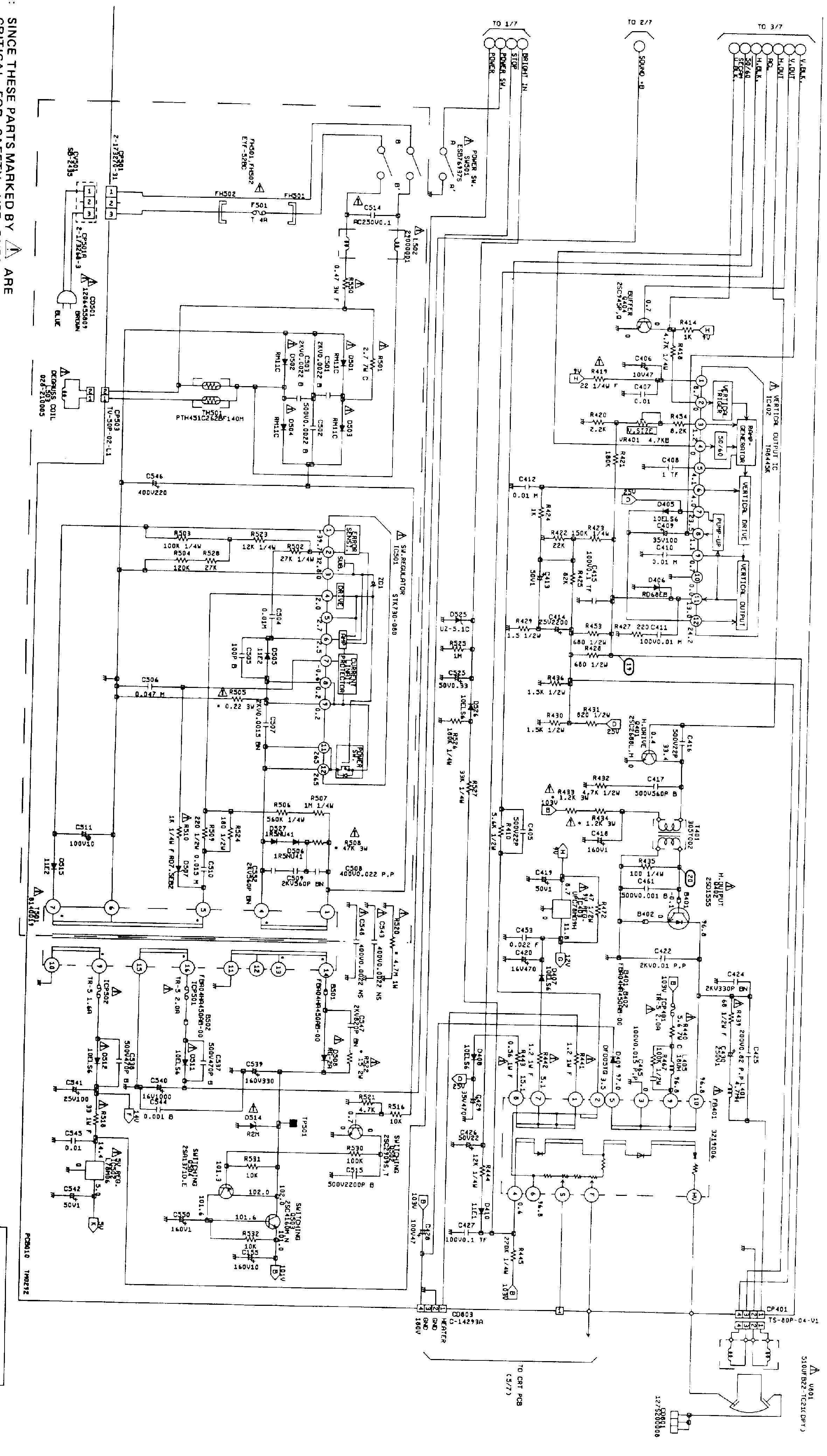

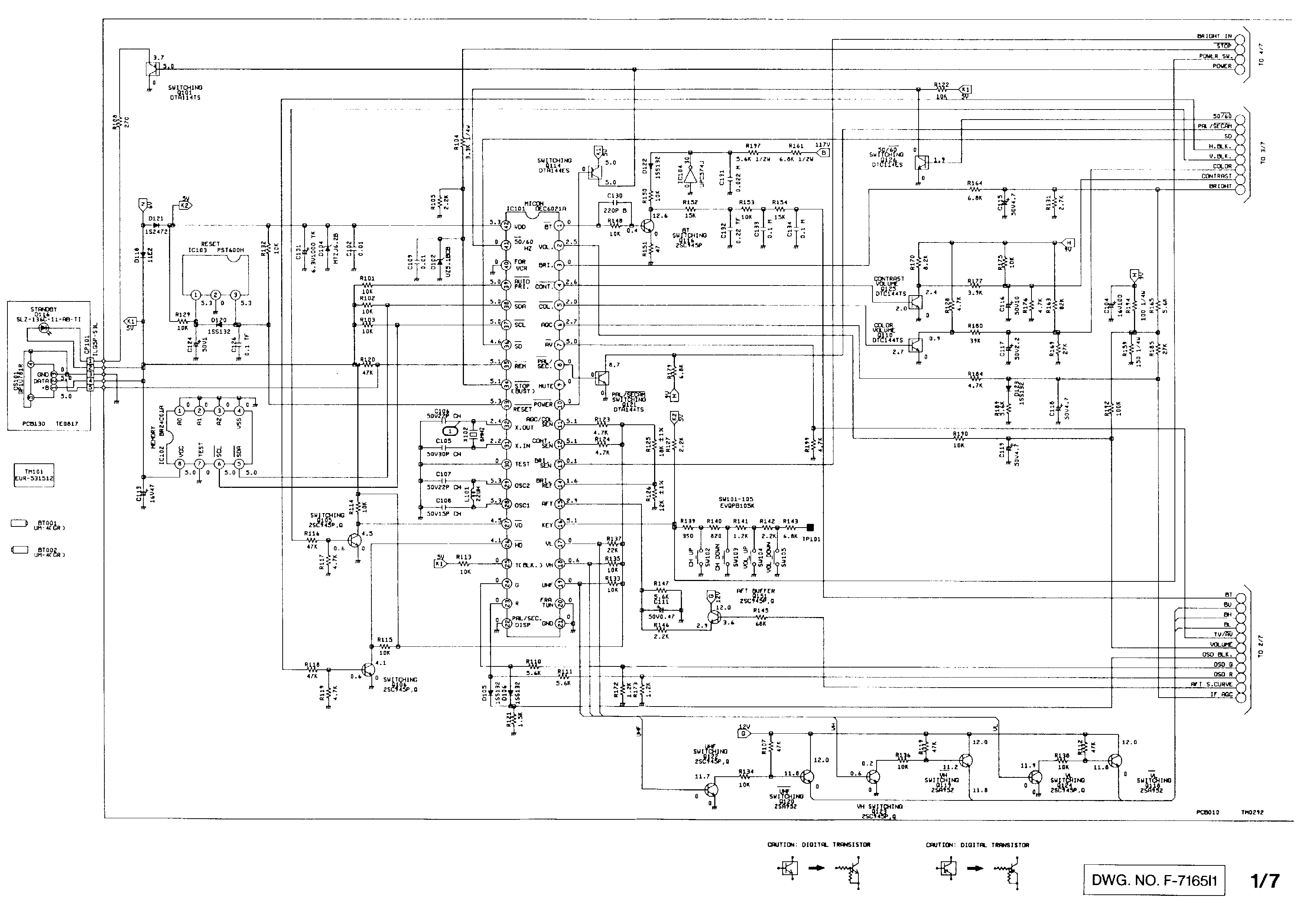

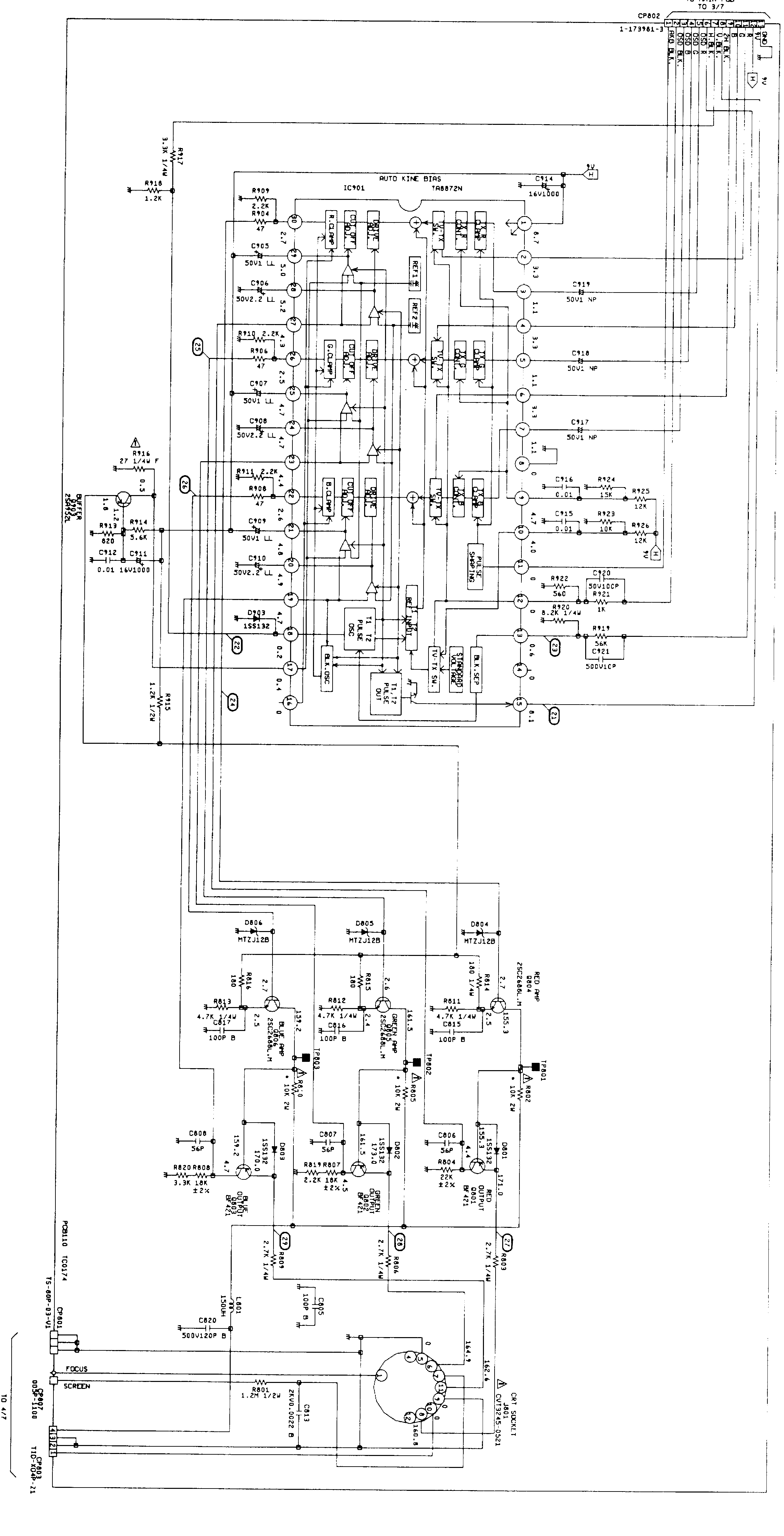

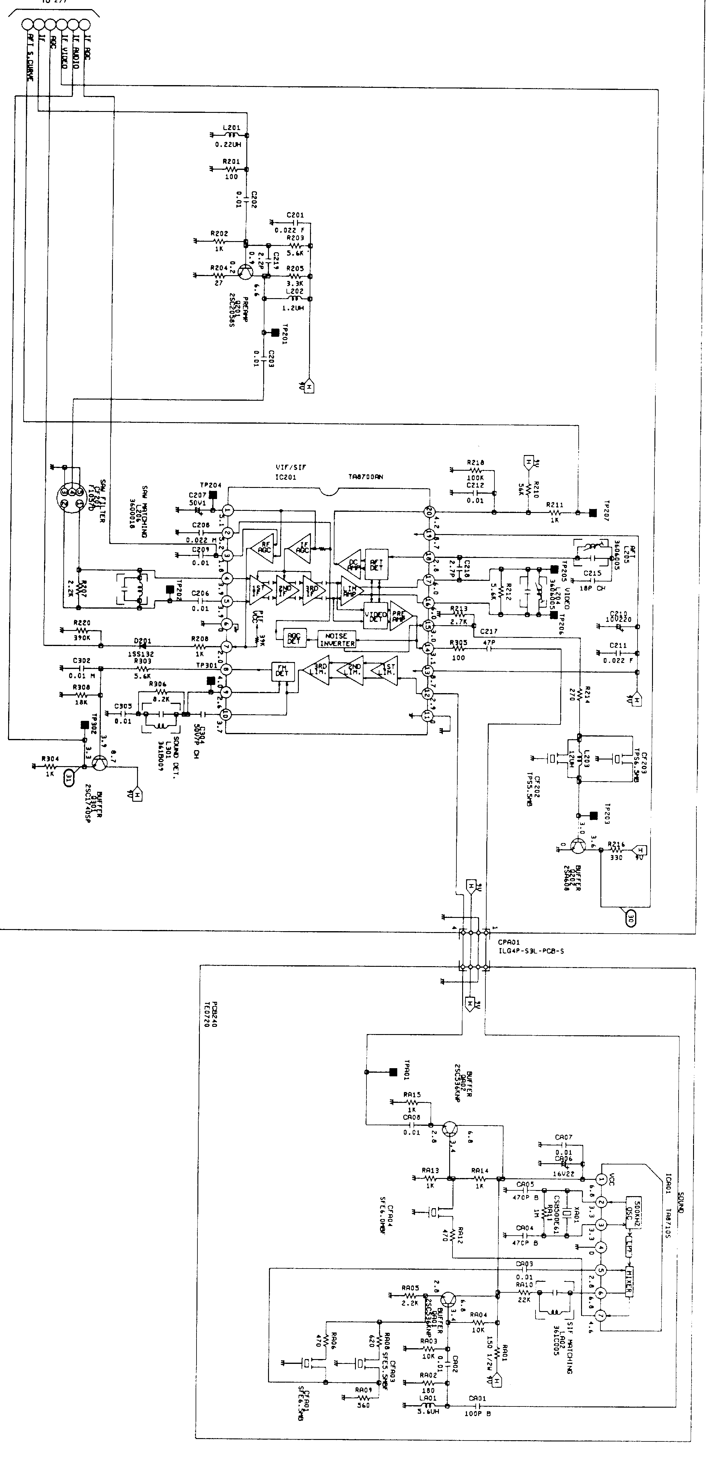

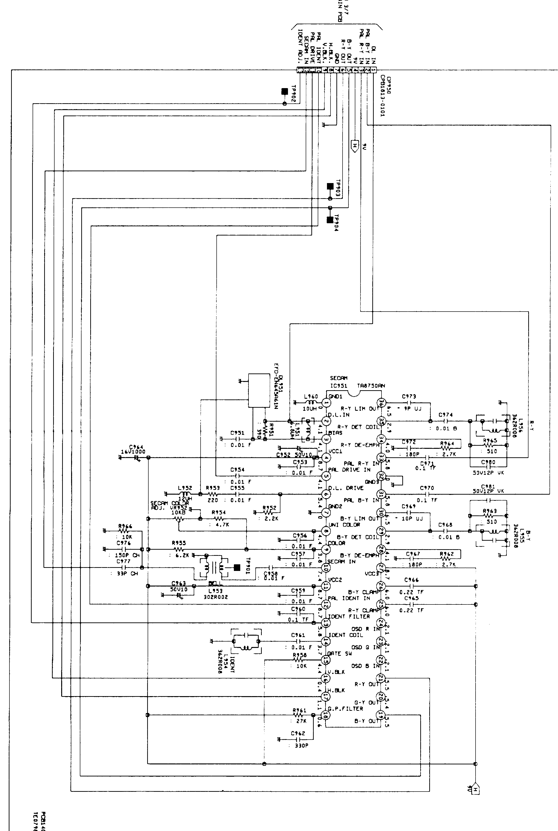

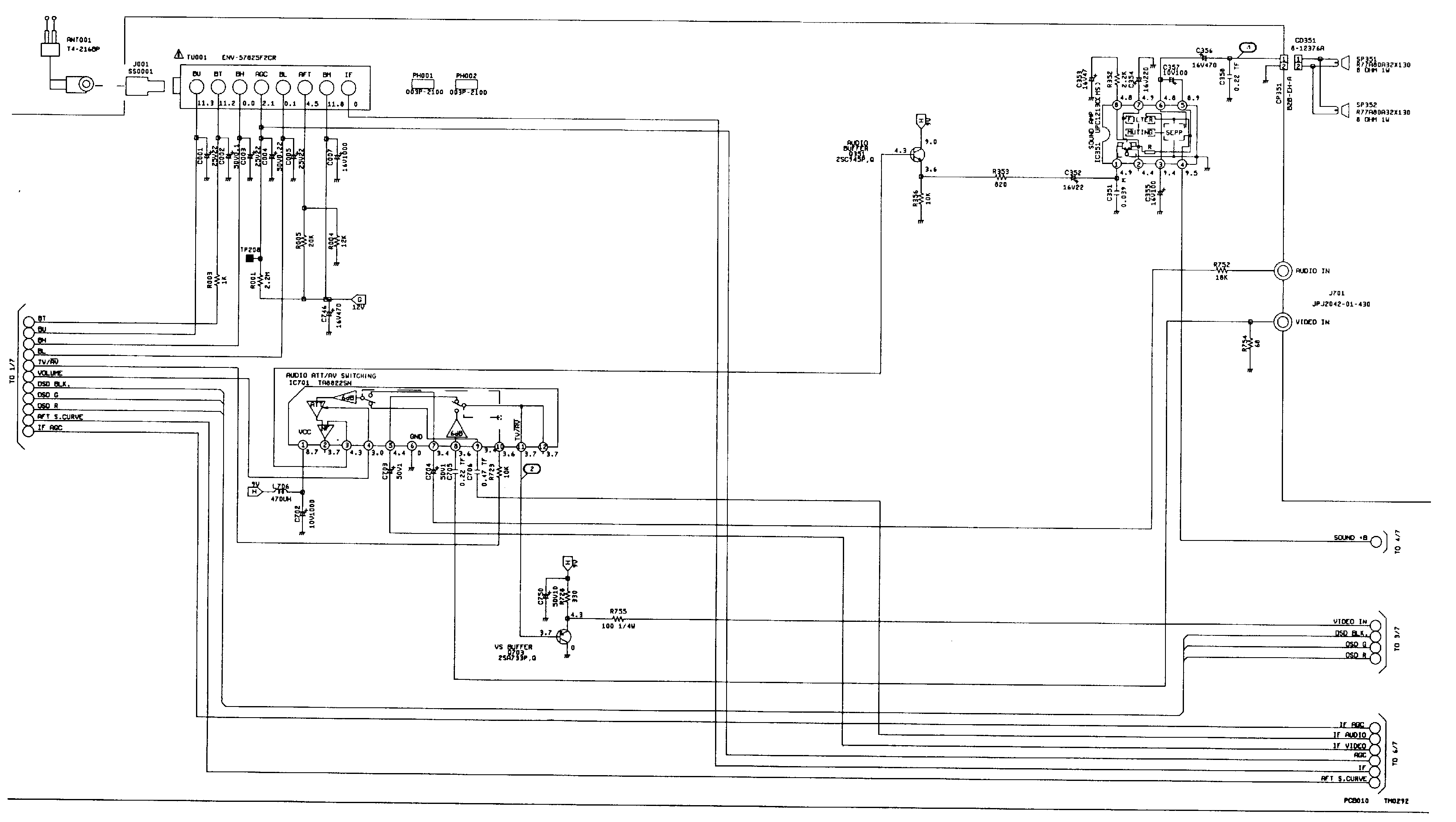

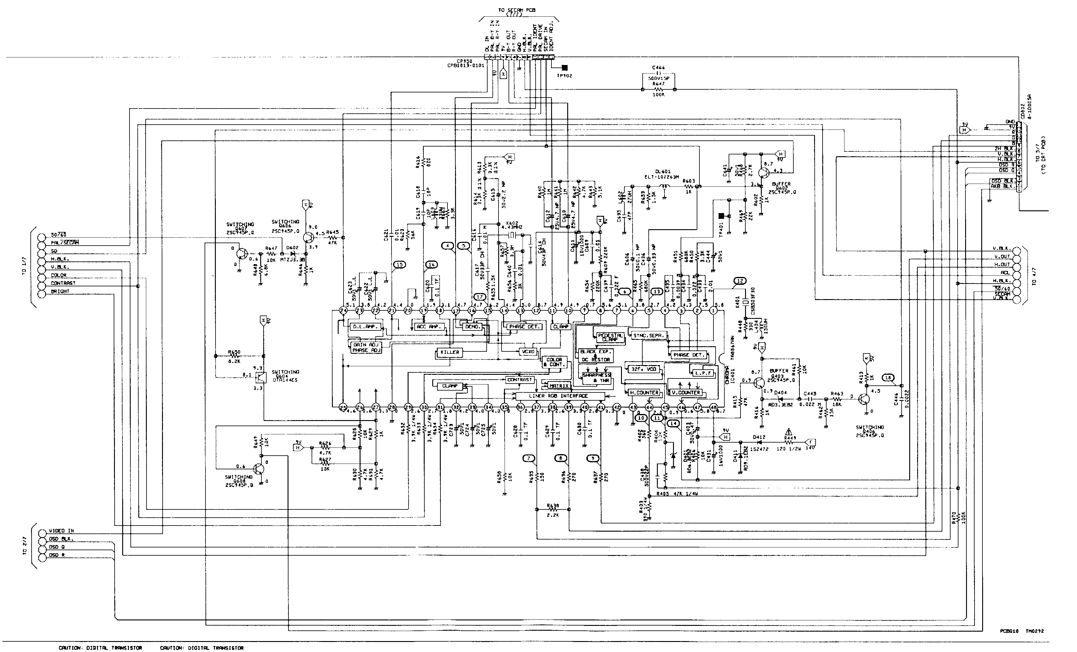

If you want to dismantle your tv.
Here's the schematic diagram of orion 14.
Hope it is the one.
