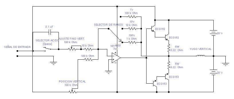

Question 1) What signal amplifier would be decent for the Job? I've found (and attached here) an schematic that uses a crappy 741 OP AMP. As Audiguru says, it's a lousy old amp!

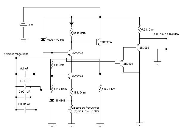

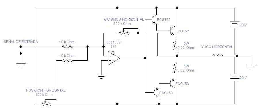

Now the horizontal coil. I understand that a Sawtooth generator is required.
Maximum left deflection: XX V
Maximum right deflection: XX V (Tonight I'll fill the missing values)
Coil Resistance: 4,65 ohm
Question 2) Can a 555-based circuit do the job?

EDIT: The schematics are in Spanish. I've attached them just as an example of what I found. First one is the horizontal driver, second one is the vertical amplifier, third one is the ramp generator. The original author is: https://www.yoreparo.com/foros/diseno_electronico/125029_0.html#461862

1. The problem in driving the vertical coil is the inductance of the coil. You need to know that before you can design an amplifier to drive the coil. Even then the obtainable vertical (input signal) frequency response is likely to be very low.
2. You need a sawtooth generator for the horizontal coil drive. Google that.
3. To sync you need a comparator circuit with an adjustable trigger point to trigger the sawtooth generator. You will also need a free run circuit to trigger the sweep when there's no signal. And you will need to blank the trace during the retrace of the sawtooth and when there is no sweep to avoid burning the tube phosphor (if there is no horizontal or vertical sweep the small stationary beam spot will rapidly burn through the tube phosphor and leave a permanent burn spot on the tube face.)

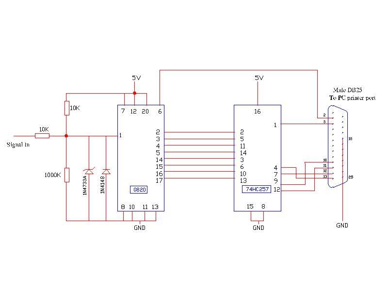

You're better off going with a PC scope. A low frequency scope is fairly inexpensive. If you are good with software you can build your own using parallel port on PC and an ADC chip.
TV deflection yoke coils are driven at a linear current slope (square wave voltage drive, V= L * delta I/delta t), with fast retrace on horizonal sweep. The inductance is designed to optimize a fixed scan rate of TV signal. The retrace creates pretty high negative voltage driver. A variable scan rate design requires a square wave amplitude proportional to scan rate. Faster scan rates can result in pretty high voltages. On top of all that it requires a positive and negative going supply relative to coil. The square wave tops have a slight slope to compensate for wire resistance of yoke coil to make scan linear.
To get the vertical deflection to accurately represent an input voltage is quite complicated involving voltage to current drive conversion. Again the resistance of the yoke wire will screw up linearity if not compensated.
I cannot remember any real oscilliscope that did not use electrostatic deflection CRT's simply because coil deflection for a scope is too complicated.

That's sad, I guess that's the reason behind using plates instead of coils on real oscilloscopes. Anyway, I'm not looking for a very high frequency response, just enough for audio or general troubleshooting. Do you think that the second schematic may be adequate for that?
Copy. The third schematic describes a ramp generator, but I don't know if a 555 based alternative would be better

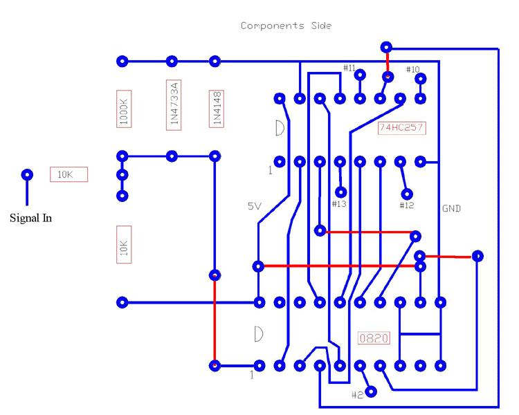

I really appreciate your suggestion RCinFLA. Other guy on the same forum posted this diagram, showing a computer based oscilloscope (see attachments). I wonder what would be the frequency response, using the ADC8020?
Here is the program to read the data
Windows version
DOS version
The credits for the schematics:
https://sites.google.com/site/scopeonpc/scopeonpc4

When I said "buy a scope" I wasn't joking, trying to modify a TV in this way doesn't give you any kind of frequency response worth having, and certainly no where near that required for audio. You 'may' be able to have a bandwidth of a few hundred hertz?.
For both TV's and PC's you do essentially the same thing - build a storage scope (minus the screen) and build an extra circuit to display the stored waveforms on the screen. Using a PC is easier, because you have the processing power of the scope to play with.
You could get a lot more bandwidth out of your TV if you turn it 90° and use the horizontal circuits (much higher bandwidth) to display your signal amplitude. However I wouldn't recommend using a TV at all : think about the lethal voltages, and the performance is going to suck anyway.
If you only need low sample rates, you can simply use your computer soundcard. This really is the cheapest option !... and it has more bandwidth than the TV scope (lol).
