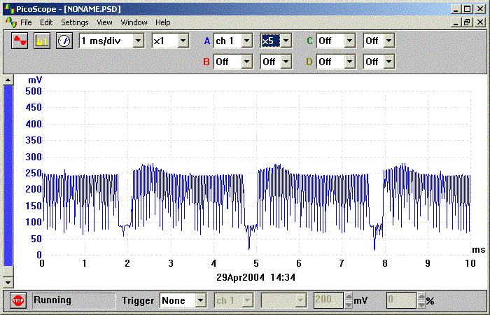

A while ago the voltages from my TV-out (Composite) on my ATI Radeon 9800 card dropped, with the result being a very dark and grey picture. Tops measured with a scope are about 250mV with white output, and they should be about 1000mV. This happened after connecting to the TV while the TV was on. The circuit on the card has both composite and S-vhs output on a 7-pin "enhanced" s-vhs socket. (the extra pins are for the composite signal)
First the composite signal went dark, but the s-vhs signal was ok, so i got a cheap converter cable that worked quite ok for a while, until i forgot to turn off the TV when i connected the cable one night, and the same thing happened to the svhs circuit. The luminance range was "squashed"
I don't have schematics for the TV-out circuitry on the card, but the contrast and saturation settings in my driver works a little bit, so the circuits handling the changes seem ok.
I don't know how these composite converter circuits work, but i guess some component has died, "zapped" by a strange grounding problem or similar on the tv.
Perhaps it would be possible to change a failing component on the card, if i just know which one it is.
(Attached is the signal viewed in PICO Scope, showing the levels. signal source is a white screen)
Please, if you have any information, give me a hint or two :(

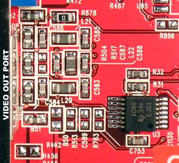

First take a look at your video card, and very near the composite or SVideo output connectors you should find R, and C's and diodes. These are generally for ESD protection (and sometimes for EMI filtering as well if you see some L's in there too). The diodes in particular clamp the output (2 diodes per line) so that the signsl cannot go one diode drop above VCC, or one diode drop below ground). You need to probe around to find out which one got zapped.
Also, looking at your signal, it appears that both the sync tips and peak video are about 1/3 their nominal levels. May be you could add a simple X3 gain video amp to bring the levels back up to normal. Won't repair your video card, but will mask the problem.

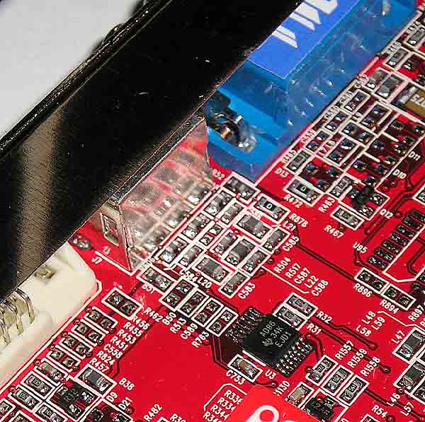

Got some pics here, this is what it looks like just beside the video out port, it's probably one of these buggers then. Got some L's as You can see L20 L21 and L22. Problem is i don't know what values they should have. How do i know if one is zapped? Sorry for being such a newbie:

Still feel a bit tempted to just replace one or two of those small components, I've soldered that type of tiny R's before, and know it's tricky business, but not impossible.... if i just could find out which one is faulty....

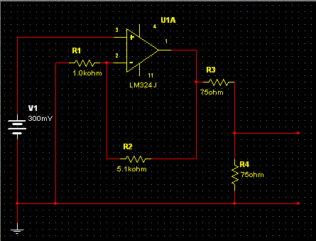

Actually I found I had an LM324 amp (4x1 amps), so I'm planning on making something like the pic below. Using Multisim 2001 I simulated this circuit, and it amplifies 300mV to about 900mV, so I should be quite close with that. However multisim achieves this level without any current sent to the LM324. Is this possible? Will the loopback still amplify without an external power source for the LM324?
Please tell me if something looks very wrong with my plans :wink:

Planned to make this amp now, but I'm going to need some more help. Where does a current feedback OP-AMP get its power from? do i need a transformer of some sort?
Also the link to the op-amp given above is dead now, so any more hints on how to build this thingy would be great!

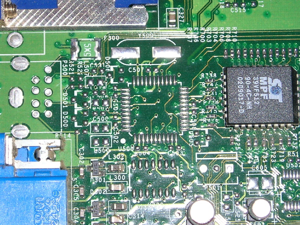

The U is a driver IC that delivers the NTSC or PAL format to your TV, if the U is degraded or damaged the signal produced gradually goes to nothing over time, since this is a multi-stage layer formatting for a PC monitor the layer extraction is minimal, but the drivers are somewhat complex as several can fail and still get a deminished signal from the U.
Usually abrev'ed U# and come in all kind of sizes, are extremely sensitive to ESD and are extensivly isolated. If those L comonents are bad they are bad, usually if one is bad the circuit fails to deliver anything, and the components are usually there for protection.
Since this card has circuitry for TV out, but not installed, you can easily see where the U goes. And the U just below it is not required either as this delivers or conditions the format to the top U.
Certain memory are considered U as well. Well most IC's are considered U's
'L' usually stands for inductor usually not marked.
'C' capacitor sometimes marked
'R' Resistor and are ussually marked value
'D' Diode, Diode transistor
'Q' Transistor or amp of some sort, dropout regulators
I used the Term UUT wrong it means nothing to the actually meaning of a IC placed on a PCB U###, I think it just means Integrated Circuit.

As I can see in Your picture, the Video output IC, or U, is connected first via some C's L's and R's, then it is connected to the TV-out Port. The C's L's and R's are for protection of the IC. If one of these components fail, the circuitry (IC+C's L's and R's) does not provide a good signal.
The card was probably damaged due to some kind of small surge from the TV as i connected the cable. This probably has damaged some of the protection components, and the IC might still be ok.
If i find the faulty L, C or R i should be able to replace it and get the circuitry working again. This, if not the IC itself has failed. If this is the case, how do i find out the values for the protection components? I have tried to mail HIS for schematics or more info, but the seem reluctant to help me.
