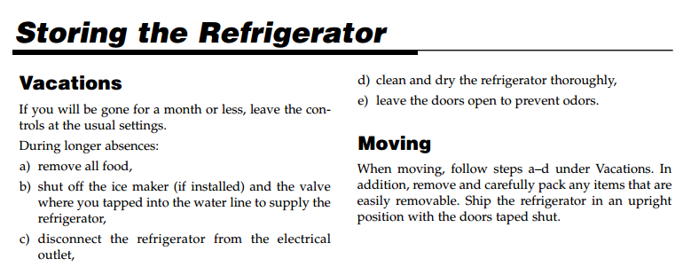

Direct from Maytag (**broken link removed** ):
I am sure the "month" is arbitrary and was chosen to balance the inconvenience of restarting and cost of running. In Nepal, considering the same factors, the period might be shorter or longer. Note the recommendation to keep the "usual" settings, not warmer. Most important, there is no mention of periodically starting the refrigerator every few days for whatever reason.
John
