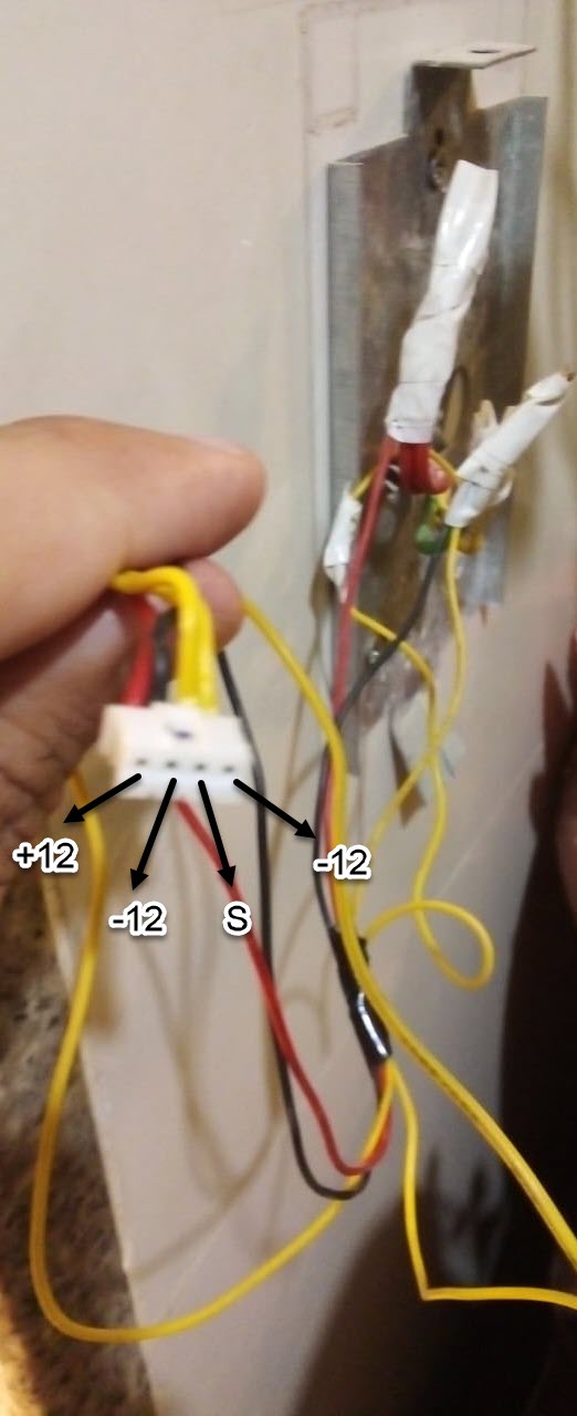

I want to turn on a fan(AC/220V/50H) using IR obstacle Sensor/NPN(NO) Output as the follwing:
1-)While the sensor seeing the object the fan will be on.
2-)If the object passes the sensor the Fan will be on for a certain time varies from (5 Min - 20 Min).
the following Figure show the available wires for me (+12v,-12v,S,-12v)
S: Sensor output(when it see any object the output become -12v)
could anyone help me to design the circuit to do what i need ?

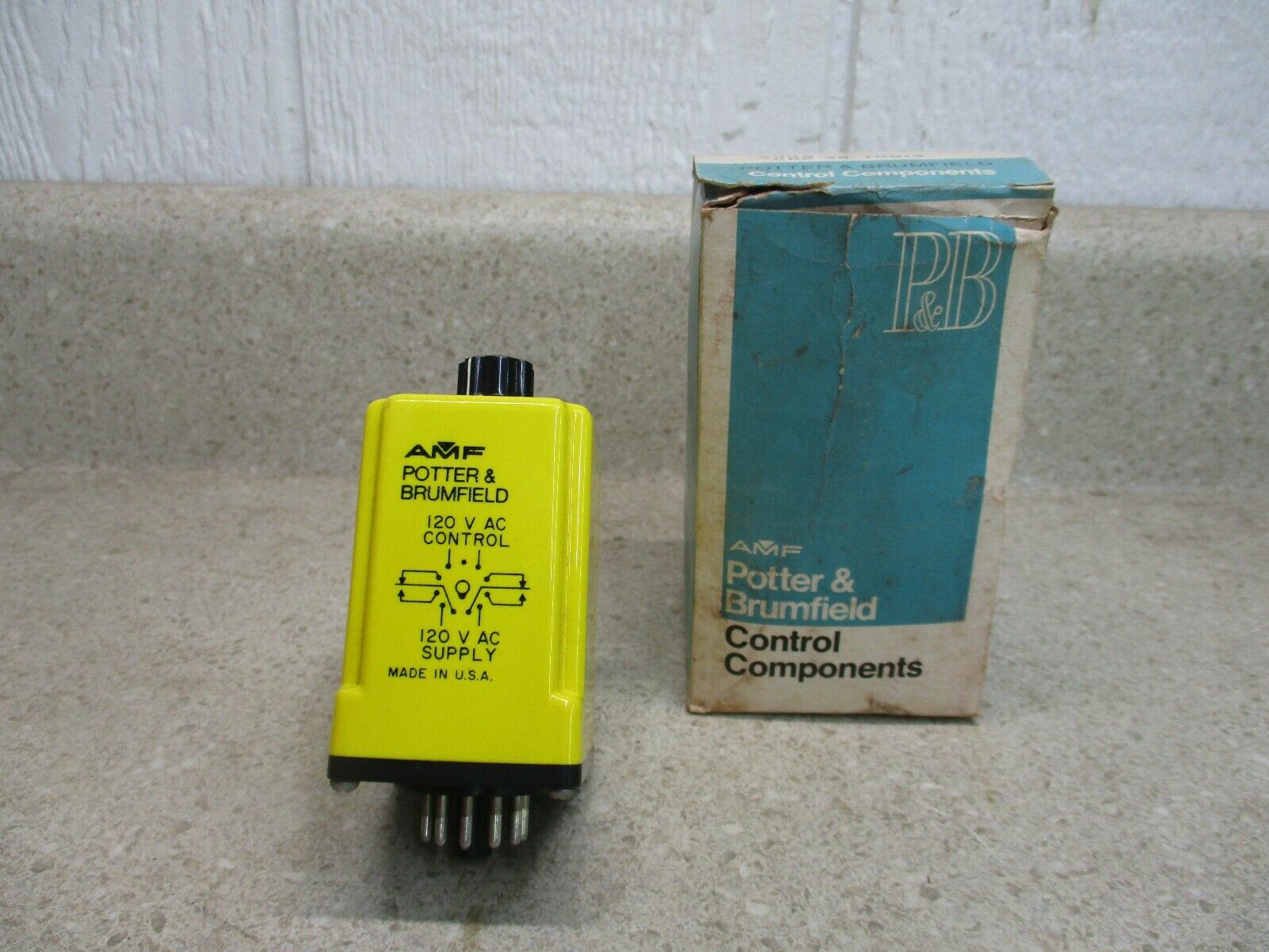

Buy an industrial timer relay. Several companies make timer relays they operate on 120v or 240v ac. They come in 100s of different time settings buy one that is 0 to 30 minutes. Use your sensor to turn relay ON when relay times out FAN turns off. Turn knob on top to set the time you want.
I have 74 of these timer relays. I have not found any good projects of these lately. This relay is OLD it is 120vac only, I paid 2 cents per lb for these at the scrap yard.
120754
According to post #1 there is no power or signal Ground connection. Where is the reference ground for the system? Some of the description implies to me that what you are calling -12 is actually Ground.
Please post a wiring diagram showing *all* power and signal connections.
that comes from.
