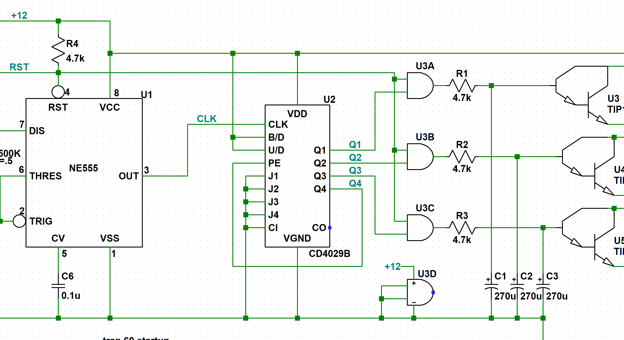

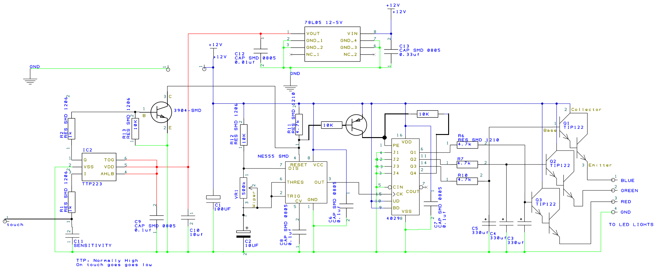

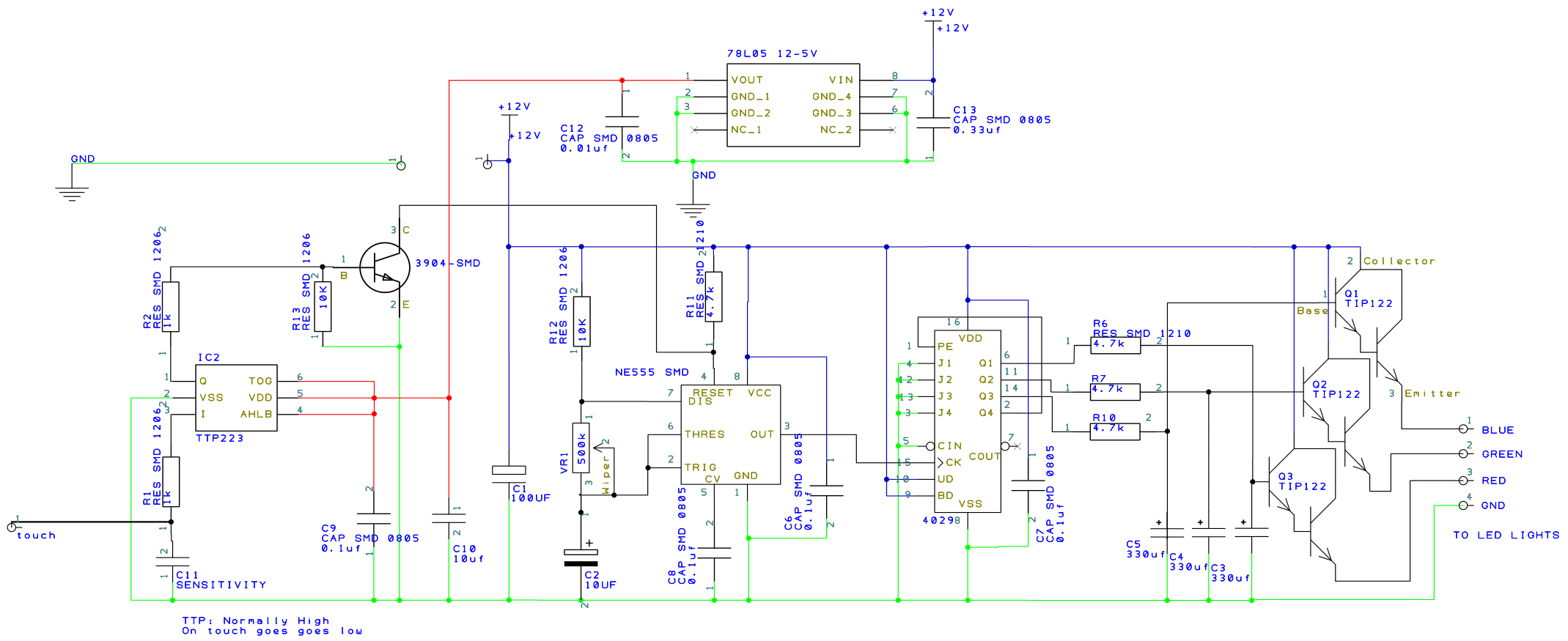

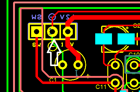

This circuit cycles a set of LEDs (red green and blue) in series (24 total leds)
12v power source with a 5v regulator for the TTP223 IC
A member helped me add this feature to this LED cycle circuit where a touch from TTP223 will take pin4 (reset) of the 555 from a high (4Volts) to low (short to ground) thus allowing the 4029 to begin counting and illuminating the LEDs in a pattern.
While initially when power is first applied it does work. The 4029 is not counting so no led sequence. After a touch pin4 of the 555 is taken from high to low and the 4029 begins its cycle but if you touch the TTP223 again to stop the process it does not turn off what ever leds happen to be lit at the time. It simply pauses. What could be done to also turn off the leds after the TTP223 goes high then turn back on when it goes low again.
Thank you.
