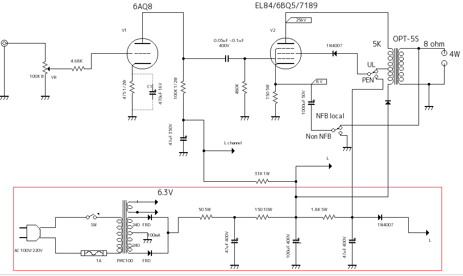

Diy, just one example for a power supply (within red square):
(From this site)
I modified the transformer configuration.
The amplifier schematic is a fairly common design for an audio amp, although possibly different than yours. But the power supply will, generally speaking, provide adequate filament (6.3VAC) and DC voltages appropriate for a tube type amp of this kind. There are many, many other power supply designs out there.
