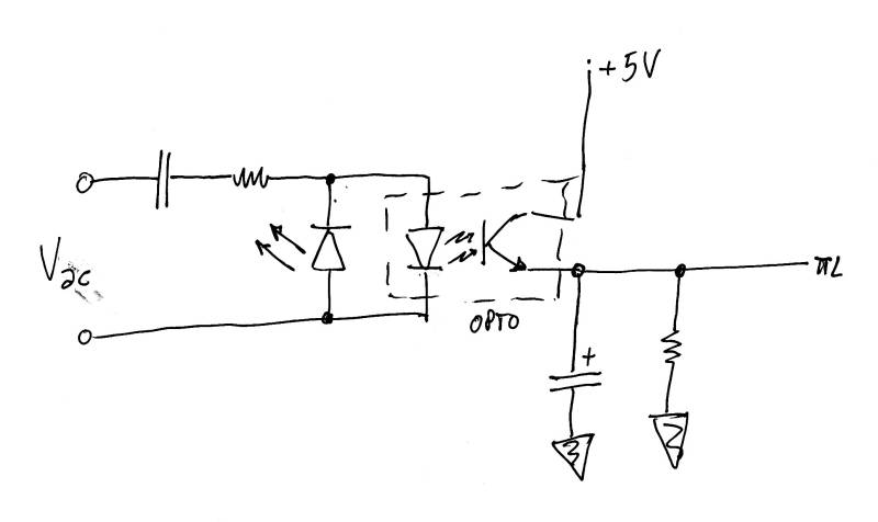

using a LED in the Vac section and moving the capacitor to the +5V side of the opto, you can have a simpler circuit and a "status light" on the Vac side too. See the attached scheme.

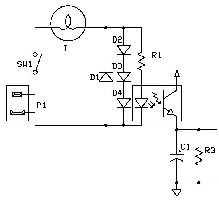

A slightly different approach. I saw this somewhere, but can't reference it, and haven't tried it. Rather than detecting the 120 volts AC, needing high voltage capacitors and high (relatively) wattage surge resistors, it detects "current" flowing in the activated 120VAC circuit. The diodes D1-D4 need to be sized to handle the peak AC voltage and current. R1 is a 1/8W low-ohm resistor.
Just another idea. ;)

I like that circuit. With out high voltage caps it should take up less space.
It is load dependent, but sometimes that is a plus, in that a voltage detector may tell your logic that the light is on, but if the bulb is burned out there is no light on ;)

I just got some miniature high voltage caps(.27mf), less then 1/2" and I used the 1n5338 zener diode which is plenty heavy. Threw it on the scope and got a 5.3v saw tooth waveform.
I have to admit when I turned on the isolation transformer I was half expecting blue smoke, but the led lit and everything is working fine.
I may play around with some of the other suggestions and ideas but I'm more than happy with the way this is working.

I think you are thinking backwards. The OP wanted to detect a 120VAC circuit and feed a µC. The input to an SSR is the low voltage side and the output is the high voltage AC side...mostly. I suppose you could call a optoisolator an SSR if that is what you were thinking, but it's not usually referred to that.
