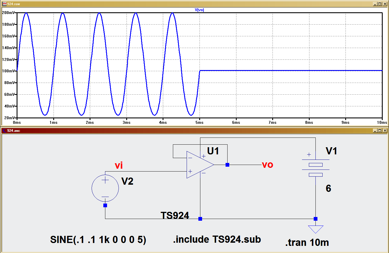

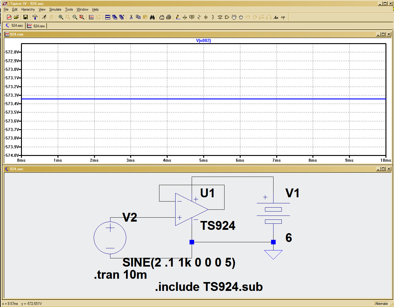

I'm trying to get this model to work and can't. :(I'm sure it's something obvious to some of you but not to me. :eek:
Thanks for the help.

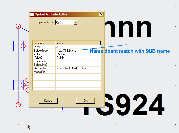

hi Ron,
Open the TS924.asy file and edit the new/TS924 to just TS924
Use the Edit/Attributes/Edit Attributes drop down menu in the menu bar
Its the 'New' thats the problem, double click that line and edit the text and Save when done.
NOTE: you may have to close LTS and restart it, it will run OK.
Also add the '.include TS924.sub' to the circuit,

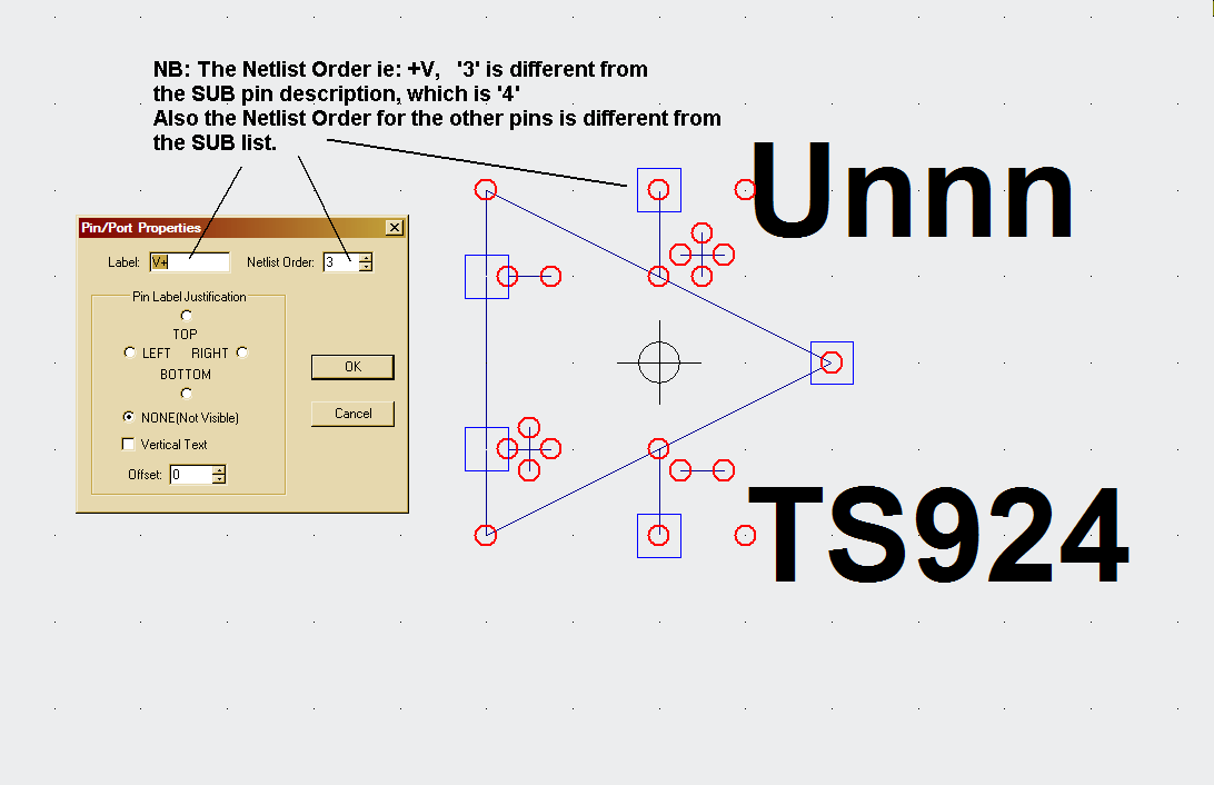

hi Ron,
Noticed the OPA was drawing 1A.!
The pins on the 'asy' digram were in the wrong sequence compared to the TS924.sub.
Corrected zip file attached.
  • Ron2.zip

hi Ron,
Some images that may help, ask if not clear.
Open the asy file by using Edit/Attributes/Edit Attributes drop down menu in the menu bar
Extract fro the SUB file.
NOTE:
the pin numbers in this listing, also the SUB name....TS924

Hi Eric,
I didn't know how to open the pin window until now.:eek: I thought I checked it against the 324 that I made it from, but I guess not.
I put both the sub circuit and the symbol in a directory I call "new". when I do that I don't have to do the include statement -- another thing I always forget.:p
