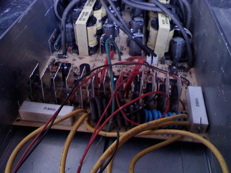

Hi there! I'm looking for assistance in identifying a part I have. Let me offer a little background first.
I have a 3kw/6300w-peak inverter in my Jeep.
Due to vibration (Jeep is off-roaded most weekends) two of the cement resistors have fallen off the board.
The resistors in question actually total 4 that were wired onto the board, but were stacked 2-high in two separate spots. The wires pulled out of the end of the cement on the top resistor on each 'stack'.
I THINK they are 15W 1ohm resistors, but other than that, I've got no idea. This is from info I've googled. Trust me, I've googled off and on for about three weeks now and I can't seem to find a 100% sure answer, so I thought I'd ask some folks that obviously know what they're doing! LOL :)
Radio shack sells 10W 1 ohm and 15W 10ohm, but neither are the same as what I think I've got. I really don't know the voltage that they are...
The 'top' resistor's (the ones that fell off) wires were simply twisted around the bottom resistors (still on the board with the wires wrapped around them and securely soldered to the printed board). So, because of this, I'm fairly confident that if I can find the exact replacement parts, I can just untwist the old wires and remove them, and re-twist CAREFULLY the new parts on to the board. Then I hope to brace them some how so this doesn't happen again... I haven't figured that part out yet. I still need to find the replacement parts!
Anyway, here are some pictures of the application and of the specific resistors I've got with the wires broken off just inside the ceramic.
in the first pic you can see the specific part. In the second, you can see the two locations where they came from, the wires that came out of the cement, still sticking up from the two that are still attached to the board.
Any help with identifying these two resistors (they're the same, so... if you can identify one of them LOL...) I'd really appreciate it... if you can point me in the direction of where I can buy them (radio shack doesn't look good...) I'd GREATLY appreciate it! :)
Lastly, would it be possible to replace the 'double' resistor setup at each spot to a single resistor that did essentially the same thing, lessening the chance that they are going to vibrate off again?
I'm decent with a soldering iron, but definitely not a master... I think I could pull off this solder job, it's actually pretty sizable on the printed side of the board so there's lots of room for errors by a novice (like me!)

With the R preceding the 1, I would expect it to be 0.1 ohm. Have you tried to measure the undamaged ones? Should be able to do that without removing them.
Caddock - MP821-1.00-1% - Allied Electronics
Take a look at these resistors, you can mount them to the side of your inverter and run leads to the board. looks like you have 15 watt 1 ohm resistors in parallel giving you 30 watts at .5 ohms. I would replace both sets with this type of resistor that is mounted to the metal sides of your inverter. get 2 20 watt, .25 ohm resistors and hook them up in series to get your .5 ohms (easier to wire than parallel) and if you need to, you can mount a small aluminum plate to the outside of the box to carry the heat away.
Kinarfi
If mneary is correct, and I think he is, Here's what would work, looking at your photo, the board doesn't appear to have gotten hot, so one 25 watt mounted to heat sink would probably work instead of 2 15s.

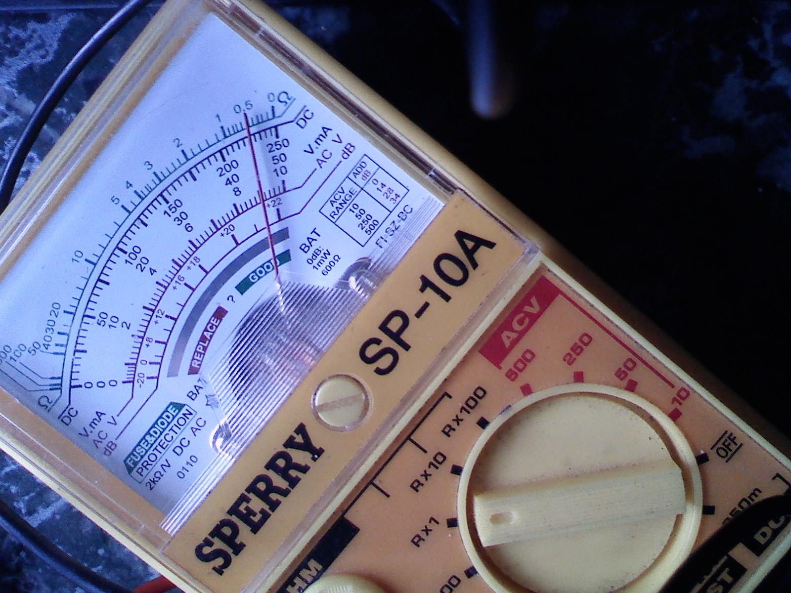

Lastly, I did test one still on the board just now. I'm not 100% sure about the meter reading, but I think it's .5 ohm. I attached a picture of the meter reading just so you folks could confirm it. :)
The original resistors are marked R1 which is 0.1 ohms and J which is 5% tolerance. They are 15W.
Kinarfi is wrong.
Your meter is measuring the resistance of its leads plus the resistance of the resistor. Short the leads together and see the reading of 0.4 ohms.

This is the one you want 2 of, yes, use the thermal grease,
Aavid Thermalloy - 530613B00000G - Allied Electronics
2 of these might be a good idea also. You'll need 4-40 screws, washers, lock washers nuts.
Solder wires from the board to the leads and silicone them down so they don't vibrate. put some silicone around the resistor leads to stabilize them also. the leads will break off if bent more than a few times so be careful with that.

Ok, I checked the tare setting on the meter. Unfortunately, it's zeroed as low as it will go... which gives the resistance in the leads as about .3 When I test the resistor it goes up a hair... to about .4ish.... so I'm guessing he's right... it's 0.1 ohms.

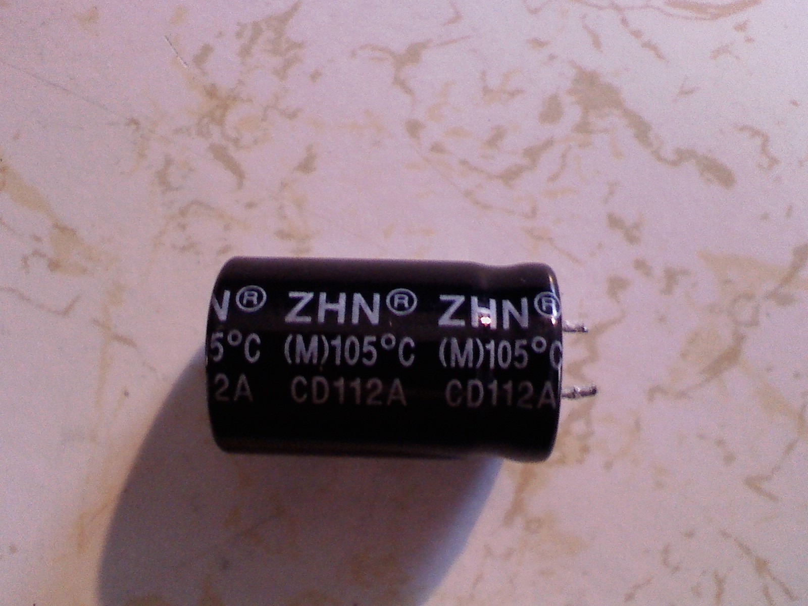

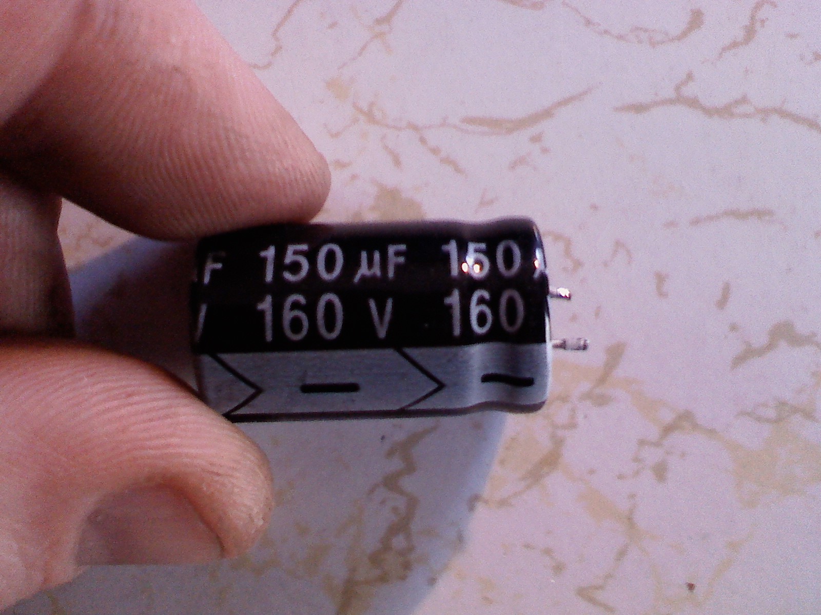

I got some pictures of the burn mark and the capacitor... suggestions? Is there a way to test this bugger? ... no, I'm not going to put a 9V to it, then touch it to my tongue! LOL :)
Once again, I appreciate the continued help with this project! I really don't want to toss my $200 inverter if it's just a few inexpensive parts!.... especially now that I've got another $20 invested into it... not to mention I bought a new soldering iron since my old one was really weak... so, make that $40 invested... even though I've got a decent soldering iron now. ;)
Ok, so here's the pictures I got of the burn and the cap:

That particular burn looks more like something fell on it or (more likely) The solder pad was disconnecting from the copper underneath and this is the arcing smoke, the nearly microscopic, cure would be just resolder it. Even better would be to scratch some of the green off to make a larger stronger solder pad. Did the tongue test pass? what volt meter do you have.
Kinari PM sent
Well, for what it's worth, the spots where it solders in is actually pretty large. This is nothing like a computer circuit board by any means. Most of the solder points are at least 3 MM or larger. There was a decent amount of solder where the cap was attached and it wasn't loose or anything.
Close inspection of the cap doesn't reveal that it's damaged... but then again, appearance isn't everything :eek:

Good way to check a capacitor is to measure it's resistance, I should start out as a low ohm resistor and the needle will climb to open resistor. the fast the climb, the smaller the capacitor & vise versa.
