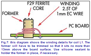

Did you shorten the former on the coil?
former currently stands at 12mm above the board surface, without trimming it
thought that was a bizzare instruction...
