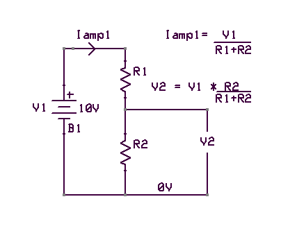

My advice would be not to use the 'Z' parameter until you fully understand the basic Resistive divider using the 'R parameter.
Also choose a reference voltage point from which to make your calculations, in this sketch I have chosen the -V terminal of the battery as the 0V/Common reference.
Look at this image.
dknguyen; I see now that it is clear that these Voltage measurements i.e V out is referenced to ground and being measured across the resistor, Z2, that makes a lot of sense now. I wasn't aware that if Vout just has a name w/o anything else by default it is referenced to ground.
File:Impedance Voltage divider.png - Wikipedia, the free encyclopedia
When i first looked at this image I never figured by default that V out was voltage measured across Z2 . I just figured it was a the voltage at that point, between Z1 & Z2. But I suppose when measuring voltage it is always measured across a component?
One thing I do find confusing with this diagram
is where would Vout be placed if you wanted to know the voltage across JUST Z1?
Would it be placed before Z1? Akin to how Vout is placed before Z2?
Also if one was measuring the voltage drop across Z1 and Z2 would that require a line enclosing Z1 & Z2?
