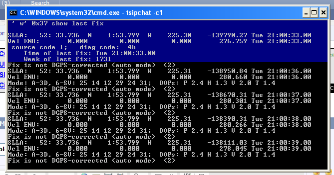

Hi.
I have one of these up and running with TSIPchat. - Took a while but I got there.
The system appears to be working ok. I can talk to it and get messages back from it.
The problem is it's miles out in it's reported GPS fix. Is there something I need to do to get the position correct?
I have attached a snap shot.
Can nayone help please.
Regards - Paul

OK I'm an idiot! - There's a difference between GPS co-ordinates and LAT LONG co-ordinates. Doh!

I reckon it puts you in the north Derbyshire peak district, just south of Huddersfield. However I see you are posting from Birmingham. Hmmm!
To convert lat & lon to Northern and Eastings, you need to put these values through the Transverse Mecarter Projection which is mathematically complex. However I have the source code in C if interested. It took a 68HC11 micro running at 8MHz nearly 4 seconds to do the conversion. On a PC it won't be a problem.
**broken link removed** may help.
I used the lassen about 20 years ago and don't remember any specific issues with it.
There is no difference between GPS co-ords and Lat & Lon that will give you such a difference. You may want to look at switching off any differential GPS offset that may be causing this offset before you got it.

I realised that the Lassen is sending co-ords in GPS format. When you do the conversion it does place it absolutely spot on to the antenna in my back garden. I wont bother converting in the pic as i'll just cut & paste the coordinates into a PC conversion before overlaying in google maps.
