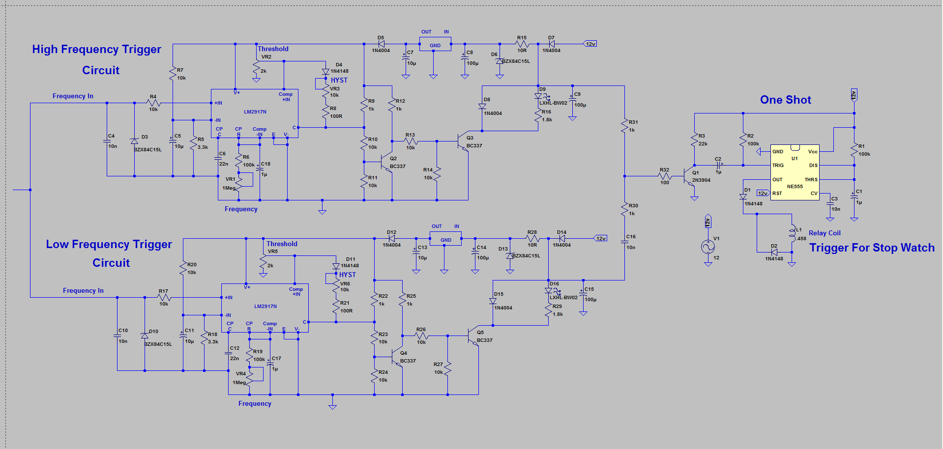

There is probably a simpler way to do this but I have pieced together what I think may work, would you be able to have a look at the schematic & see what you think?
Obviously on the Schematic the Low Frequency Circuit Triggers the Stop Watch ON & the High Frequency Circuit Triggers it OFF.

You left a lot of specifications blank.
Frequency range?
Voltage range?
and whether your looking at the time from e.g. 500 Hz to 1000 or from 1000 Hz to 500 Hz or both?
I now understand that the stop watch uses a typical start/stop signal.
A reminder that relays have an actuation time (10-20 ms typical).
At one time, I did a search for Arduino frequency measuring routines. Basically you have to chose either a time base method or a count method and use interrupts. You can look at rising or falling edges. Sometimes you have to clean up the edges with a schmidt trigger.
I'll wait for your answers first.
meanwhile: https://www.lmgtfy.com/?q=frequency+counting+arduino where you can see the frequency range matters a bit.

You could use your frequency to voltage converter and a comparator and voltage reference. Measuring and setting the voltage might be adequate for you.
So, yep, you do have to get it in sync. ut you do have:
a) greater than low frequency - pulse (one shot)
b) greater than high frequency pulse (one shot)
Linear technology has introduced these http://cds.linear.com/docs/en/lt-journal/LTJournal-V20N4-01-df-Timerblox-Andy_Crofts.pdf timers, but you probably have 555's hanging around.
Typically, you might get a voltage reference across say a 10K 10T pot and buffer the wiper with a low offset OP amp.
the turns-counting dial may be enough resolution for you.
If they are fixed points, then 10T trimmers might work fine. The important thing is to BUFFER the reference.
Thanks Reloadron & Kiss,
Ok you both mention the Frequency to Voltage method which is good as I have some LM2917N Ic's.
I have some LM311P comparator Ic's as well.
Also 555 Ic's
Just so I understand this correctly, I have the frequency into the LM2917 which obviously converts the frequency to voltage.
I set a reference voltage on the LM311 & when the input voltage to the LM311 is the same as the set reference voltage the comparator switches On triggering a one shot circuit that triggers the Stop Watch On.
So I need a second LM311 circuit for the higher reference voltage which triggers the Stop Watch Off--Yes?
Does the LM311 comparator circuit for the Low frequency trigger remain in the ON state after it has been triggered?

Yes to both questions. You want an edge triggered monostable. This https://www.jameco.com/Jameco/Products/ProdDS/13611FSC.pdf does nicely because they can be used to detect both a positive or a negative edge. The max timing interval is restricted. There is another in the family that may have a longer interval.
How you get your reference though can be different. Many times you can buy and OP amp, comparitor and or reference together.
The LM10 https://www.ti.com/lit/ds/symlink/lm10.pdf has been around for years So has the LM311.
You end up with a lot of tradeoffs because of supply issues. e.g. You generally need something larger than 5V to get a 5V reference. If you use a single supply OP amp, you have issues with the low end. The reference may have low output capability and an OP amp adds offset. For the comparitor to work, the OP amp must be driven from a low Z source.
So, lots of options.
So, in one scenario, I could envision say a 5V reference then buffered. To that buffered output, drive two 10K pots. Then buffer the wiper to apply to the comparitor. It's not a good idea to use the power supply.
You see a lot of 1/2 Vcc as an artificial zero. This is done a lot in automotive sensors. They also make the reference "ratio-metric", so they don't need a precision reference.

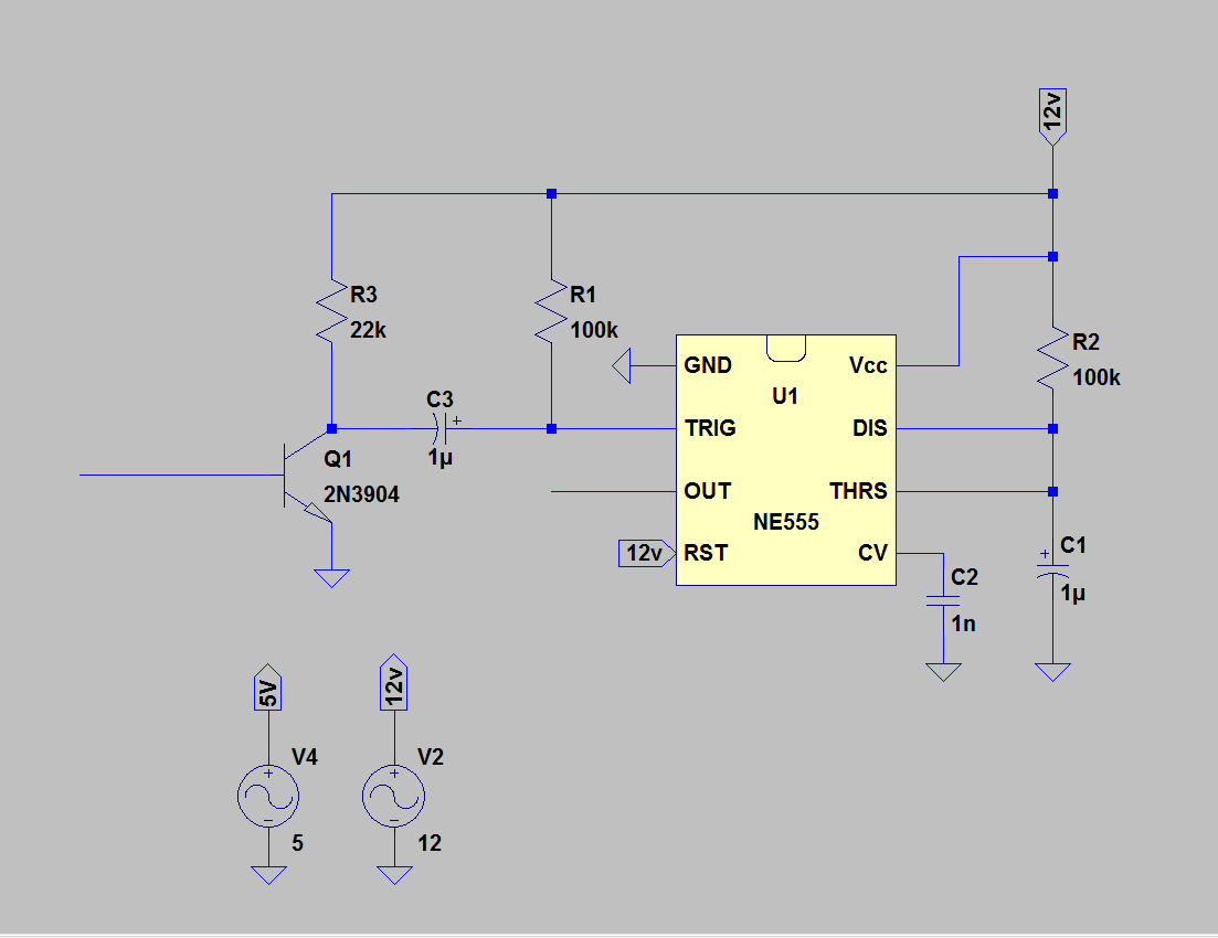

Obviously the CD4528 is best as you suggest but until I can get some can I just use a 556 connected as shown in the attachment-(555 shown) just to test things out?
I get what your saying about buffering the reference voltage.
The LM339 is ok to use?
Thanks for the help, sounds good!
Cheers

Thanks Kiss,
It's probably not a good choice because of the output time period. There is a 4098, 4028 and then this one; http://www.onsemi.com/pub_link/Collateral/MC14538B-D.PDF which would go to 10 s. The latter is equlivent to the CD4538. http://www.google.com/url?sa=t&rct=j&q=&esrc=s&source=web&cd=1&cad=rja&uact=8&ved=0ahUKEwjYzZT_hJzKAhXHSyYKHXOEAvEQFgggMAA&url=http://www.fairchildsemi.com/datasheets/CD/CD4538BC.pdf&usg=AFQjCNFbs1iE4ZwBIUTKeZMZTL7atwoDUA&sig2=r6CDN3JRwLD0HA1MqaIpdQ
There's a few minor differences. One is geared for precision.
Then, of course, there is this one (LTC6993-x): http://cds.linear.com/docs/en/datasheet/69931234fc.pdf but the power supply is limited to 5V.
Pick your poison.
