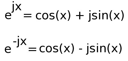

The next time stuff like this comes up, or anything that involves differentiation or integration of sin(x) and cos(x) functions, your best bet is to use Euler's Identity:
Where:
e= Base of natural logs, 2.71828...
j= sqrt(-1)
These are complex numbers where the real part gives answers related to the cos(x) function, and the imaginary part gives sin(x) related answers.
It is much easier to manipulate exponentials than it is to mess with sin's and cos's. That is especially true where differentials, integrals, and powers of the functions are involved.
