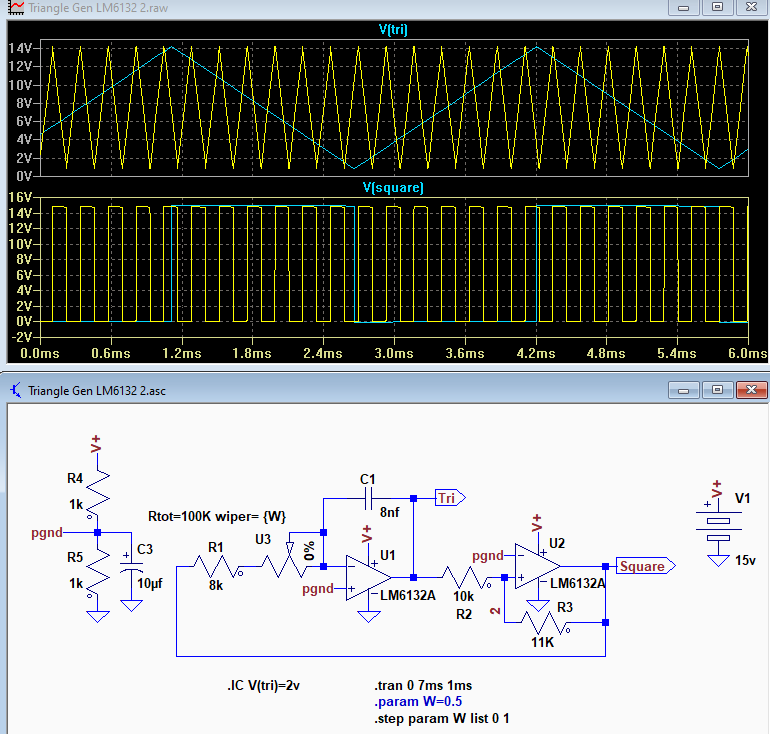

how can I create a triangular and rectangular signal generator that has a frequency between 1000 and 5000 Hz, the amplitude of the triangular signal between 4V and 10V and the amplitude of the rectangular signal between 0.5 and 7 V .I would at least need a circuit. I could also calculate the values of the components

Below is the LTspice simulation of a square/triangle generator using two high-speed RR op amps.
The outputs are shown for the two limits on the pot setting.
For a variable output, you can add a pot at each out.
If you need a low impedance output, you can buffer the pot output with the two spare op amps in the package configured as non-inverting buffers.
