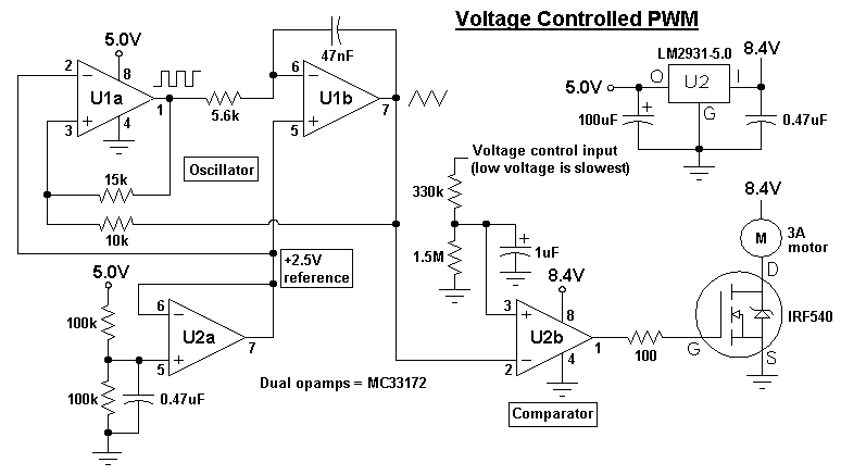

A PWM circuit does not need a triangle-wave that goes from 0V to the supply voltage. I
ts voltage swing from an ordinary opamp just needs to have enough amplitude to switch the switching transistor or Mosfet on and off.
I used the standard one opamp as a positive feedback square-wave oscillator that feeds a second opamp as an integrator.
My PWM frequency was about 3kHz which is very audible, it could have been ultrasonic.
I used this circuit to drive a 4A motor on an electric model airplane:

A PWM circuit does not need a triangle-wave that goes from 0V to the supply voltage. IView attachment 81267 ts voltage swing from an ordinary opamp just needs to have enough amplitude to switch the switching transistor or Mosfet on and off.

Nice circuit, couple of questions:
1)what does the reference voltage do or why d reference voltage.
2)how do you determine frequency.
Opamp circuits always have a reference voltage that is a bias voltage. In this circuit it is at half the supply voltage so the square-wave and triangle-wave can swing symmetrically with equal up and down amplitudes, using the symmetrical opamp I used.
The 47nF timing capacitor is charged by and is discharged into the 5.6k resistor. The current in the resistor is constant and is determined by the square-wave amplitude provided to the resistor by the first opamp (0V plus 0.7V and the supply voltage minus 0.7V).
My PWM circuit compares the triangle-wave to a DC voltage, not a sine-wave.
My description before wrongly said that the triangle-wave drives the Mosfet gate. Actually, the triangle-wave is compared to a DC voltage and the output of the comparator drives the Mosfet gate.
