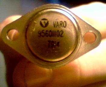

i would like to know what type of transistor this is

Heathtech, I don't know how you're going to get him a datasheet, i cant even read the letters and numbers in the picture.
Could you type out the letters and numbers daniel?
I would suggest it might be an 'in-house' number, which is a private number placed on a device for a manufacturer of a unit - in which case the number won't have a datasheet.
For an example Daniel, you are manufacturing high power audio amplifiers, and you want to source your components from a number of different semiconductor manufacturers to help prevent any potential shortages.
Now it looks bad if you use different transistors during production, so you ask for 'in-house' numbers on the transistors - as you're buying large numbers the manufacturers are quite happy to do this.
So you order devices from Texas, Toshiba, and Motorola - and you ask ALL of then to print 'Daniel1' on them, rather than the manufacturers number. Now YOU know exactly what transistors they are, but no one else has a clue - as 'Daniel1' won't be listed in any datasheets, and could be any one of three different transistors.
Anyway, that's an example of 'in-house' numbers, and of course they might be nothing of the sort - but I've never seen any manufacturer numbers like those.
you must be right but
it look just like any other transistor and has a logo on it.
it is a circle with a triangle in it and a little dash pointing top left,
to the center.
I put the picture in the photoeditor to brighten it, and I was able to read all the numbers and letters, so I'm one step ahaead. I believe the manufacturer no longer exists, but the rights to the parts are owned by this company:

"Tower International Transistor Selector", which is an essential book to have, lists details on over 32,000 bipolar transistors - but nothing faintly resembling the numbers on that device.
It lists Varo as a manufacturer, but only as "Ceased Production", I'm presuming from the date code that it's from 1979, week 14?.

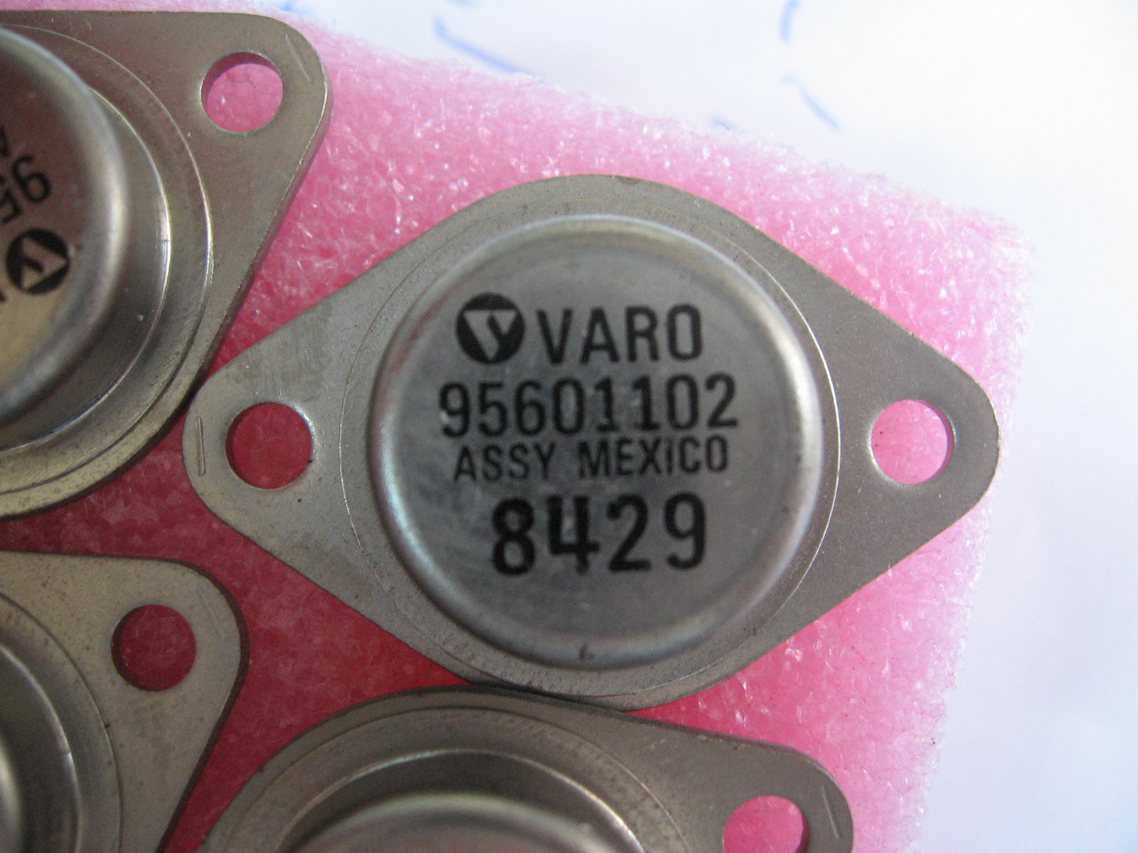

All, right, making progress. The internet is a marvelous thing. Summit is trying to obtain the datasheet at this time, and they sent me a photograph to verify the part. I'm going to post the photo and give you the datasheet when I get it.
Oh, you won't like this information: There are only 6 of these left in the whole universe, and this is the price they are quoting for them:
95601102 1 Wks 6 $155.00000 each

Well, I guess the company that has these six transistors must be having a hard time finding the datasheet, because I haven't recieved it yet. At any rate, at least you know how much it costs to buy another one. I am guessing it isn't worth it. However, if they do get that info to me, I will still post it, because with the datasheet you might be able to find a suitable replacement with similar specs.
Well, evidently a datasheet is not available anymore on this , as stated in the last e-mail I recieved:

THERE IS NO WAY I CAN ID. THIS WAS A HOUSE #. HOWEVER, VARO ONLY MADE RECTIFIERS IN A TO-3 PKG.
SORRY, BUT WITHOUT A SAMPLE & TEST EQUIPMENT I CANNOT HELP.
