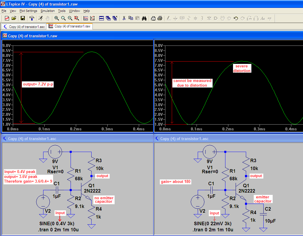

What? I understood that he meant the emitter bypass cap...and so could you?
He said, "what the use of byepass capicitor in voltage divider bias of transistor."
He did not mention the emitter. He also did not mention a bypass capacitor (because of his poor spelling).
Usually the base of a transistor is biased from a voltage divider, and does not have a bypass capacitor unless it is a common-base amplifier.
You are right in common emitter across emitter resistance, my teacher say to reduce voltage drop across resistance in high freq. but i don't know why they have connected if losses occur..?
The AC voltage gain of a transistor is the collector resistor value in parallel with the load resistance divided by the unbypassed emitter resistor value in series with the internal emitter resistance. The emitter bypass capacitor bypasses the emitter resistor creating a very low impedance for high frequencies which will have high voltage gain.
You can calculate the frequency where lower frequencies have less gain because of the reactance of the bypass capacitor.

The emitter resistor is part of the correct DC biasing of the transistor. The capacitor is added in parallel with the resistor to increase the gain of the transistor at frequencies higher than its calculated cutoff frequency.
Didn't your teacher teach you how to use a simulation program?
Here is a transistor that is properly biased. Without a emitter bypass capacitor its gain is 9 and its distortion is low. With an emitter bypass capacitor its gain is about 180 but since there is no negative feedback the distortion is extremely high.
