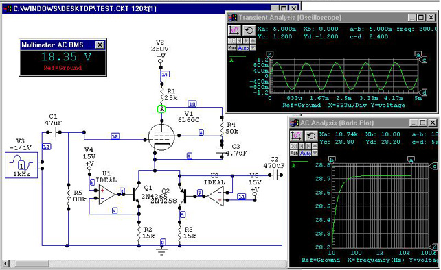

Hi Nigel,
Thanks for coming to the rescue, the main the reason I asked is because I am trying to implement my own gimmics to the traditional way of building tube amps and have had some major set backs, which made me question about my basic foundation of biasing......... :oops:
I have tried placing a jfet at the cathode of a triode and it seem to work ok and simulated ok as well, however when I tried the same trick with a pentode it seem to clip the top peak of the signal. I have then tried using an opamp with a transistor as a voltage controlled current source and got the same result, in the simulator as well.
Therefore, with some more hair pulling I have incorporated the following circuit at the cathode, I have yet to build this circuit but looking to do so. The simulator do not have a pentode model so I used a tetrode instead, it seems to simulate ok but I've found flaws from this simulator previously. Such as running a DC voltage into a step up transformer at the primary and got step up DC at the secondary :shock: , this has made me lost confidence in the simulator and was wondering if you guys could check it out and advise me if this would actually work with a pentode? or even a tetrode as shown in the simulation?
I would probably wire the supressor straight to the cathode and screen as shown in the tetrode below....
I donno what I'll gain by adding all these extra bits at the cathode, I was hoping this would condition the current and may be increase the life expenctancy of the cathode by using transistor as the current source. It could be just a pile of BS since I have absolutely no proof of any benefits and have yet to find a way to proof it, however it does provide some satisefaction for myself knowing that I can make things work by applying what I have learnt so far from college and by overcoming these challenges it makes me learn more.
I can't use any of the available tube circuits because of the tube I want to use are not the readily available 12AX7s etc.... and by using existing circuits just defeats the purpose of design which is what I am trying to practice doing. I would like to build things that has not been built based on my own ideas/imagination, aiming to practice my skill of problem solving....
Seems a total waste of time, particularly considering you're usually aiming at a constant grid voltage, this is setting a constant cathode current, which will change the grid voltage accordingly.
What an earth is R6 doing!!!.
You certainly SHOULDN'T have a resistor from anode to gate, the valve is going to seriously melt down!.
You're also using an output tetrode as a low signal gain stage, which seems rather bizzare to say the least?.
Valves are very tried and tested items, there are many successful circuits about which use them - try studying some, you will see the types of designs that work - you can't just start randomly connecting components together.
What sort of amplifier are you wanting to build?, and what valves/tubes do you have available?. Your biggest problems are likely to be transformers - VERY expensive!.
BTW, I built my first valve amplifer back in about 1968, it used an EF80 preamp, and a 6BW6 output valve (giving about 3 watts), I used a metal rectifer for the HT supply.
I happen to have a book that I found in a second hand shop a number of years ago, "Quality Amlifiers for A.C. mains", it's dated 1958 - it gives full details of five valve amplifiers!.

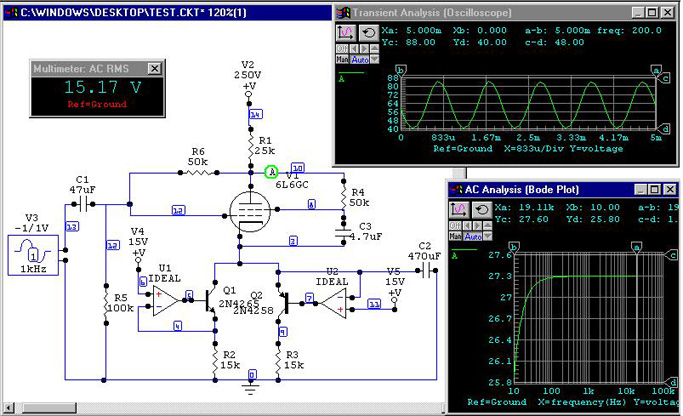

hehe, yes I know its bizzare. I have been reading on a lot of tube schematics and the Radiotron Designers Handbook 3 & 4 and have never seen that been used ever, however I thought I would try that in the simulation since I have seen it been used to bias BJTs. I was under the assumption that by using this as a feedback may be it would decrease some distortion at the cost of gain?
Is it because instead of working like a negative feedback it is positive feedback and it would draw too much current? but doesnt the plate resistor limit the current? I am very confused, I know I must be missing something....... Soorry about my newbieness again, since I have not been taught anything on tubes except some minimal reading on my own.....
I am actually aiming to use this as a second stage of my amp, with the first stage consisting of a 6SN7 differential amplifier. I can not have the source signal bigger than 1V p-p or I'll get clipping in the simulation, thats why I've only used 1V p-p as the source.
A valve isn't a BJT, you won't have seen it used because it wouldn't work, a valve requires negative bias (because by default it's permanently ON), applying massive positive bias is making really sure the valve is absolutely hard ON!.
It's simply biasing, the grid must not be positive - in fact a common fault with valve stages is the coupling capacitor from the previous anode leaking, causing the grid to go positive.

The actual operation of a valve is EXTREMELY simple, based purely on the attraction of electrons by a positive voltage, and the repulsion of them by a negative one.
