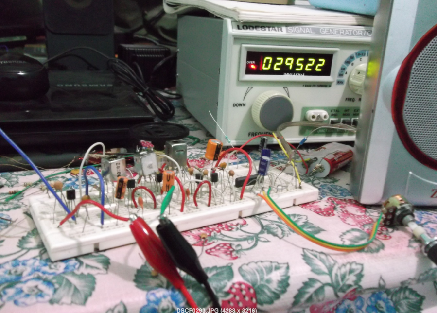

G'day guys!:)
I've carried out some quick experiments after the arrival of my new RF Signal generator/counter. This is one of that. A transistorized FM superhet receiver which can demodulate and output broadcast band FM stations.
But the interesting thing is that I have started with a basic Medium Wave receiver circuit with 455KHz two stage IF and basic germanium diode AM detector. This one was a big success and I could receive the local AM stations clearly and apparently I got surprised a bit on how beautiful is the so called 'superheterodyne' principle!
The next stage was to remove the oscillator/mixer and detector part from the working receiver to actually convert it to an FM receiver. So I've added a simple charge pump FM demodulator consisting of 2 BC547's and a BF494 wired before the IF stages as a simplest mixer. Being connected with just a 5" antenna at the emitter of the transistor and Signal Generator output injected to the base in place of LO, let me say I'm quite surprised that the system could clearly receive couple of strong local FM stations nearby.
For 102.3MHz, I've injected around 102.9MHz to tune in the station clearly.
No tuned input circuits employed as of now and the whole circuit is powered using 3V(2xAA cells):)
Next part would be to add an RF amp and LO so that to achieve a stand alone working FM receiver and I feel pretty confident that that would be so simple actually!
Below is the current status on breadboard;), and you can see the signal generator outputting 102.9MHz used for ~455KHz down-converting for the receiver.
Cheers!
I'm amazed you've got anything out of it, breadboards aren't suitable for RF - and the layout looks really awful! :D
Thanks for your warm concern Nigel :)
I would expect the breadboard may create problem while implementing the LO and RF stages because it can certainly affect the desired band coverage. Other than that, the current setup is totally running on the 455KHz IF stage with external oscillator input injected, it seems almost fine. When we move on to higher frequency stages things will become worse I agree. So I may sometimes try the LO part on a separate pcb.
Regarding the worst layout and look, hey this was a very quick experiment actually done for testing my new signal generator, though it worked :D

Well, not that easy :)
I was having a hard time getting this one working though, I had some results with severe overloading and lots of stability problems.
Within a 5 meter circle, I can move around to get a somewhat clear reception, I had noticed this with other portables also, but in my case its much severe, I've attached front-end RF amp though.
But all I can say now is I got the basic superheterodyne principle working for FM demodulation, but need more experiments to prove a nice working receiver. Also I'm running bit out of time.

A breadboard is usually not used for radio circuits because its stray capacitance between the many rows of contacts and between all the wires is far too much. The many long wires cause interference within the circuit and they pickup all kinds of external interference.

I was getting into the track by doing a simple AM Superhet by using a single BF494 mixer+converter and a YS414 IF amp+detector. It works fine. This can be one of the simplest Superheterodyne designs. It has built in AGC provided by the chip. Audio is clean but it lacks the full punch which I assume because of YS414 has only output for a crystal earphone. I may need pre-amplification of the audio before sending to the power amp. But the current setup is still acceptable though.
Very quick experiment. Thanks for looking, cheers :)
