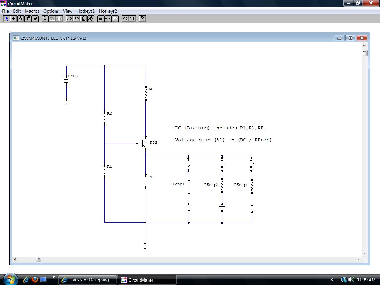

R1,R2,RE is used to set the bias voltage at the base, and the emitter current for the transistor, while the REcaps are switched in with different values of caps, and resistors, to change the AC gain of the stage variably.
By doing this the DC bias point is not affected.

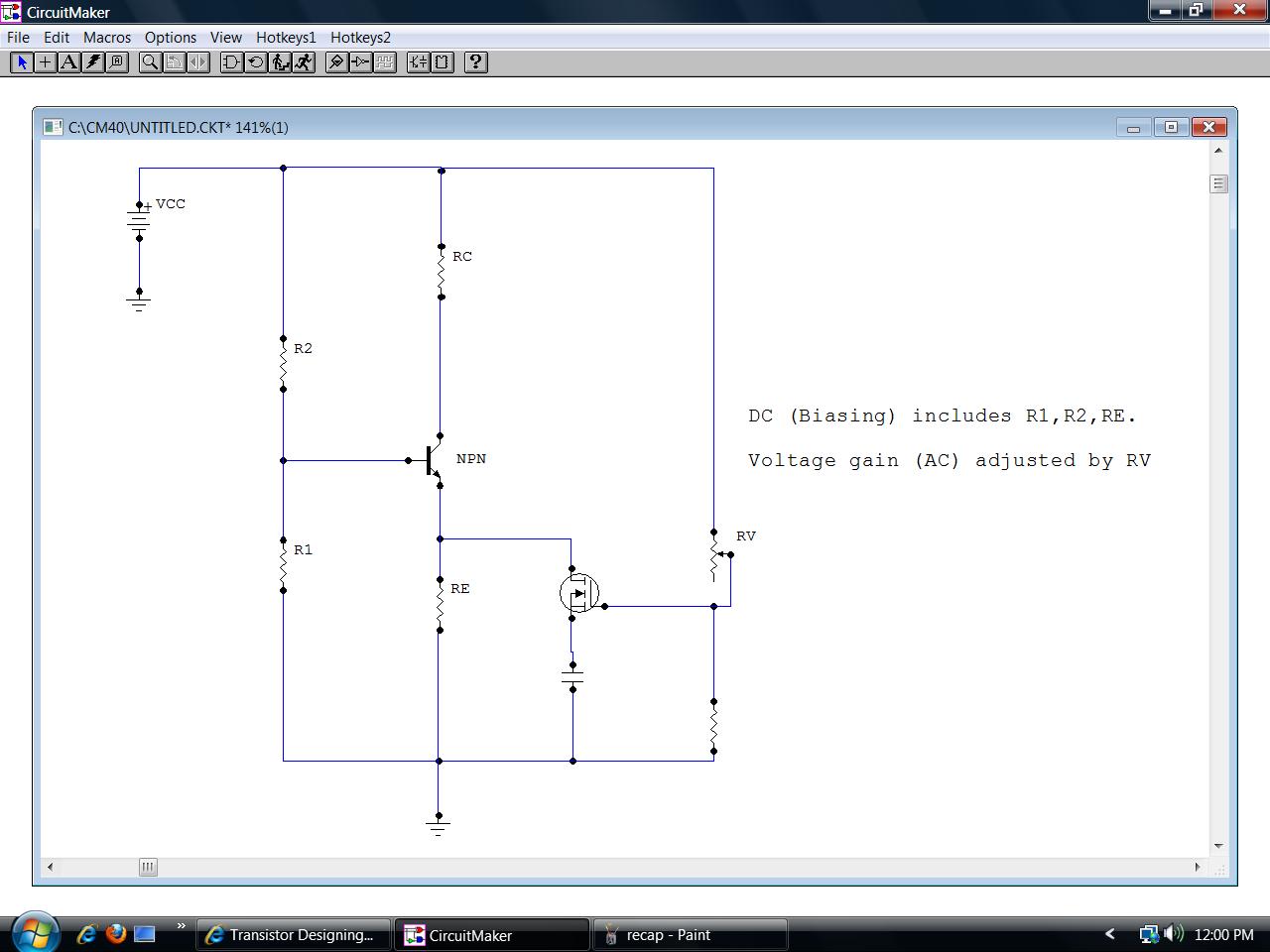

And if you want the gain to be variable with a single dial, using a mosfet acts as a variable resistance to switch in a cap. to ground the signal, allowing the gain to be increased, the mosfet changes in resistance, as the RV pot. is dialed in.

The circuit "tries" to use a Mosfet to vary the emitter resistance to change the voltage gain of the transistor circuit. But the Mosfet doesn't work because its source is in series with a capacitor instead of being connected to ground. The capacitor should be in series with the drain.

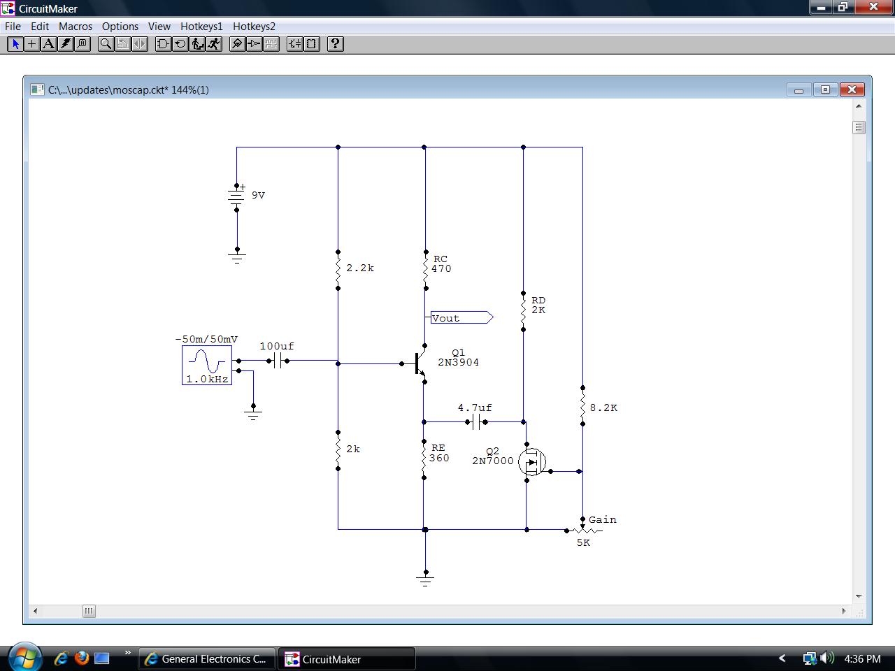

Here is the circuit refined to actually work.
Without the drain resistor RD the mosfet causes distortion on the output waveform UNTIL the mosfet is turned on harder to make it work more linear.
By putting RD in there causes the mosfet to be biased on also before the mosfet begins to have influence on the emitter circuit, it is conducting more heavily with a higher input to its gate. so the small nonlinear changes are swamped out, the output waveform remains at zero change until a large enough linear signal from the mosfet is felt at the drain to have a much more linear affect on the emitter lead.
Sorry ,I just went back and read your very first post of this thread,
you were asking how to design for a specific gain, not how to vary the gain.
I will still leave this schem. post here, just in case you find it of interest.
