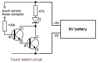

Hello, I am trying to make the Darlington pair circuit found on http://www.kpsec.freeuk.com/trancirc.htm (The one under the dotted green box)
I think the problem is simply that I am reading the schematic wrong. I have the +9v connected to the 470 and 100k resistors. Then the 100k connected to B. Then E to B. Then I cannot figure out what to do. I dont understand why the LED goes from +9v through the resistor and then after the +9v comes through the two transistors it is connected to the cathode because the voltage is still positive, right? Then what is the 0v for at the bottom? To me it looks like both positive and negative flow through the transistors. Could you clear this up for me? Thanks a lot!
The Circuit is basically correct.
The Zero volts is the negative of the battery.
The 470 ohm resistor is a Current limit for the LED.
The 100K from the Bast to the 9 Volts is just supplying a Temporary signal to the transistor to light the LED.
I would also put a resistor (somewhere between 100K to 1M) between the Input Base and the Zero volts. To pull the Base Low with no Signal.
So both the positive and negative go into the transistor? The +9 into the base of transistor 1, and the negative into the emitter of transistor 2? Thanks.

No. The circuit doesn't have a negative 9V battery. It has only a single battery that supplies +9V and 0V. You need two 9V batteries to make + and - 9V.
No. If you connected +9V to the base of transistor 1 it would blow up.
The +9V connects to one of the touch contacts and the base connects to a 100k ohm current-limiting resistor. When you touch both contacts with something conductive then a small current flows through the 100k resistor into transistor 1, turning it on and it turns on transistor 2.

aah, thanks it is starting to make sense. I'm still lost on the 0v. I think I'm making it harder than it needs to be! There are two connections on the 9v battery. One is +9v, and one is ground (negative) correct? Lets say you used a battery pack with a red positive and black negative wires. Which would connect to where on the circuit. I am lost on the LED because you need a positive and negative to make it light, then how is it connected to the circuit but there is no negative in the circuit? Thanks, I hope I didnt confuse you.
Hi Mike,
I showed how the battery connects to the circuit. One battery terminal is +9V and the other battery terminal is marked "-", but it is actually 0V.
The anode of the LED is connected to +9V through the 470 ohm current-limiting resistor. The cathode of the LED is connected to the collectors of the darlington transistor, which is connected to 0V. When the transistor turns on then it connects the cathode of the LED to 0V and battery current flows in the LED.

ok Thanks for the help! So 0v goes into the Emitter of transistor 2 and that is the only thing connected to the negative on the battery. Then the positive goes through the 470 ohm resistor to the anode of the LED then to the 'touch' switch? Thanks a lot, it is comming together now. Does anyone have any other easy transistor projects I can try out? Thanks!
According to audioguru's circuit, yes.
yes
