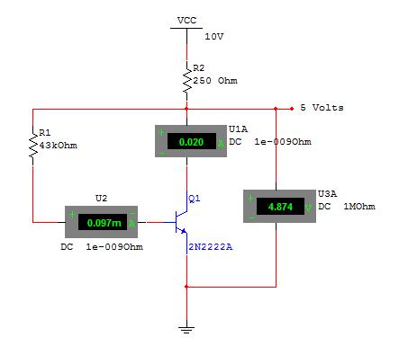

Dear All,
I am currently working through a useful web document on transistor biasing by Harry Lythall - **broken link removed**
One of the early examples describes a basic biasing technique (see attached) using two resistors.
My Goal = to bias the transistor so the collector voltage equals 5 Volts with a current of 20mA.
Heres how I did it (feel free to correct)
Assumption 1= The gain of this transistor is 200 (ok I appreciate this isnt perfect in real life).
1. Ib = Collector Current (20mA) / 200 = 100uA
2. Rb = (Source Voltage - Required Collector Voltage - npn drop at base) / Ib
2a. Rb = (10V - 5V - 0.7V) / 100uA (0.0001)
2b. Rb = 43k
3. Rc = Required Collector Voltage / Required Collector Current
3a. RC = 5V / 20mA (0.020) = 250Ohms
I have tried calculations for a number of different current voltages and the calculation appear to hold up.
Here's my question (at long last!), let say I am diagnosing this diagram with just the knowledge of the resistors, voltage source, transistor and transistor gain(?) but i do not have a DMM, how could I work out the Collector Voltage and Current based only on this information?
Many thanks in advance.
Mark
This formula will give you the collector current. The rest should be easy:
Ic = (Vcc - Vbe) / ( Rc + (Rb/Beta))
Of course you can calculate the collector voltage and current. But the hFE is anywhere from 100 to 300 so your calculation will be approximate.

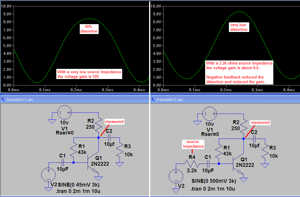

The datasheet for a transistor shows a curve of its base-emitter voltage at various collector currents.
Your circuit uses a transistor with a current gain of 100 to 300. Its voltage gain is not determined by the transistor's current gain, it is determined by its internal (plus external) emitter resistance and its external negative feedback.
I simulated your circuit:
1) Near max output its distortion is terrible at about 40% and its voltage gain is 100 if the source impedance is very low so that it doesn't have any AC negative feedback.
2) I added a source impedance of 2.2k ohms so that it has plenty of AC negative feedback. Then its distortion is very low and its voltage gain is reduced to 8.6.

UTMonkey said:
Impedance?
Your circuit has the 43k resistor providing negative feedback from the output to the input. Then its voltage gain is affected by the impedance (AC resistance) of the source that feeds it.
Distortion?
Distortion is impurity of a signal. Good audio amplifiers have a distortion of about 0.05% or less. Some opamps have a distortion that is 0.00008%. Your circuit has a distortion of about 40% so nearly half the output is impurities.
40% of what? how are you measuring it?
A distortion analyser measures a signal's amplitude then filters away its fundamental frequency then measures the remaining level of the impurities. The ratio of the impurities to its original signal is its percentage of distortion.
I use experience in looking at sine waves to judge the amount of distortion. Most people can hear 0.5% distortion and more. It sounds like the signals are buzzing and are harsh. Guitar 'fuzz" circuits manufacture high distortion amounts.
Voltage gain. The input signal has a peak voltage of 500mV (0.5V) and the output has a peak voltage of 4.3V.
4.3/0.5= 8.6.
I understand a little of what the capacitors are for - to (de)couple the source from the circuit though to be honest at the moment i dont know why you picked that value (or the value for the output cap)?
I selected the value of the capacitors to have a low reactance at the testing frequency to avoid signal loss.
What did the 2.2k resistor do? why that value?
A source impedance is usually a few k ohms. Your circuit is very much affected by the source impedance so I selected a few k ohms (2.2k).
