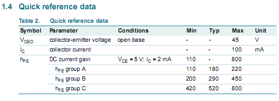

The BC547 has a Ic max of 100mA.

Also you do not need a 50mA base drive current to saturate a BC547 with an Ic=100mA.
It has an hFE of at least 100 at 100ma, so I would use a base drive of say 5mA max.

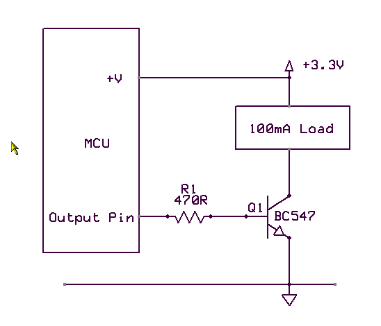

So, from 3.3V, allowing a Vbe of 0.7V = 2.6v/0.005 = 520R... pref value say of 470R.

I dont understand what you mean by that 3.3 v 50 ma is from my micro controller are you talking of the MCU pin output current rating.?
If so use a 470R from the MCU pin to drive the base of a transistor.
When you say switch the LCD on/off do you mean the lcd backlight or the actual lcd display.??

eric,
your circuit is right but. i need just a wire coming out from the collector.
shall i replace the load in ur figure with some resistor and take a o/p wire from the collecor ....

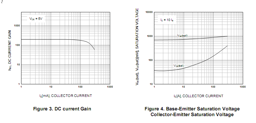

I have looked at the lcd spec, it says its 7V.! at 40 to 50mA for the backlight its normally controlled by PWM.
The lcd logic power is so low 2mA, IMO its not worth the power saving
