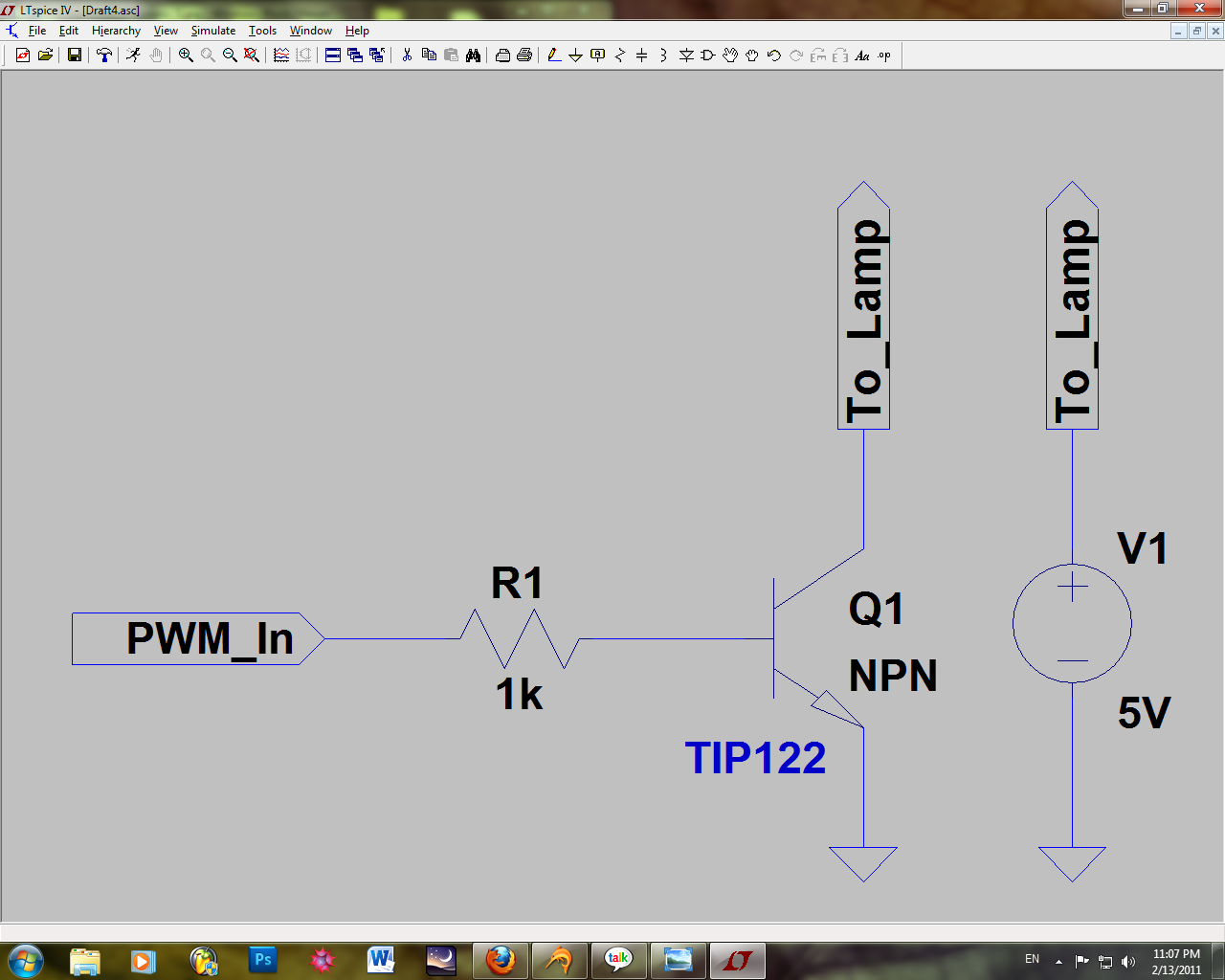

Now, a logic level mosfet is unavailable in my place. So, I'm trying to do my job (to control a DC lamp (of 4.5V) from 0V to 5v using PWM from a PIC uC at atleast 0.1V resolution) using NPN darlington transistor TIP122. Will it do my job well?
I've tried the following schematic.
What should be the optimal PWM frequency for this purpose?
In my first test I've failed. My PWM is running at 20KHz. At 1% duty cycle I'm getting 4.63V output and 3.83V at 99% from TIP122 collector. What's wrong with it?
Am I wrong with frequency 20KHz? Is it too high for the TIP122 to turn on and off?

It could be too high a frequency for the TIP122. Darlingtons are generally rather slow. Why are you using such a high frequency? Try 1kHz or so.
Should work, but I have a feeling we are missing something. Can you post a block diagram of your circuit?
Yes. I too think we're really missing something.

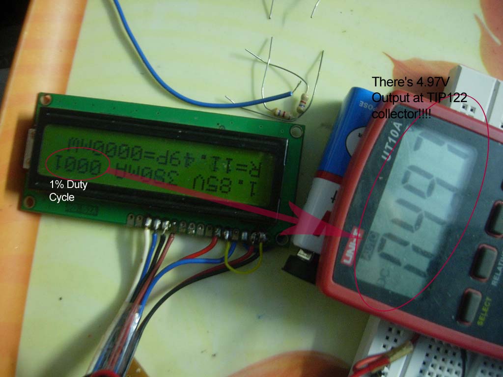

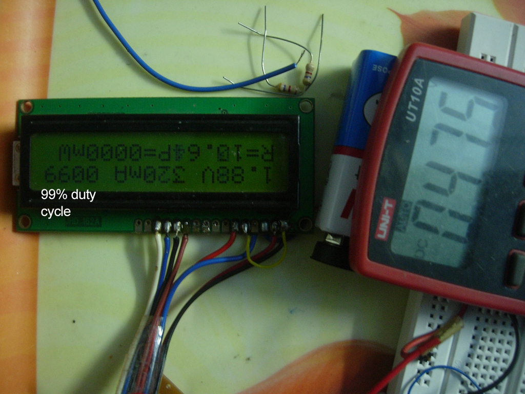

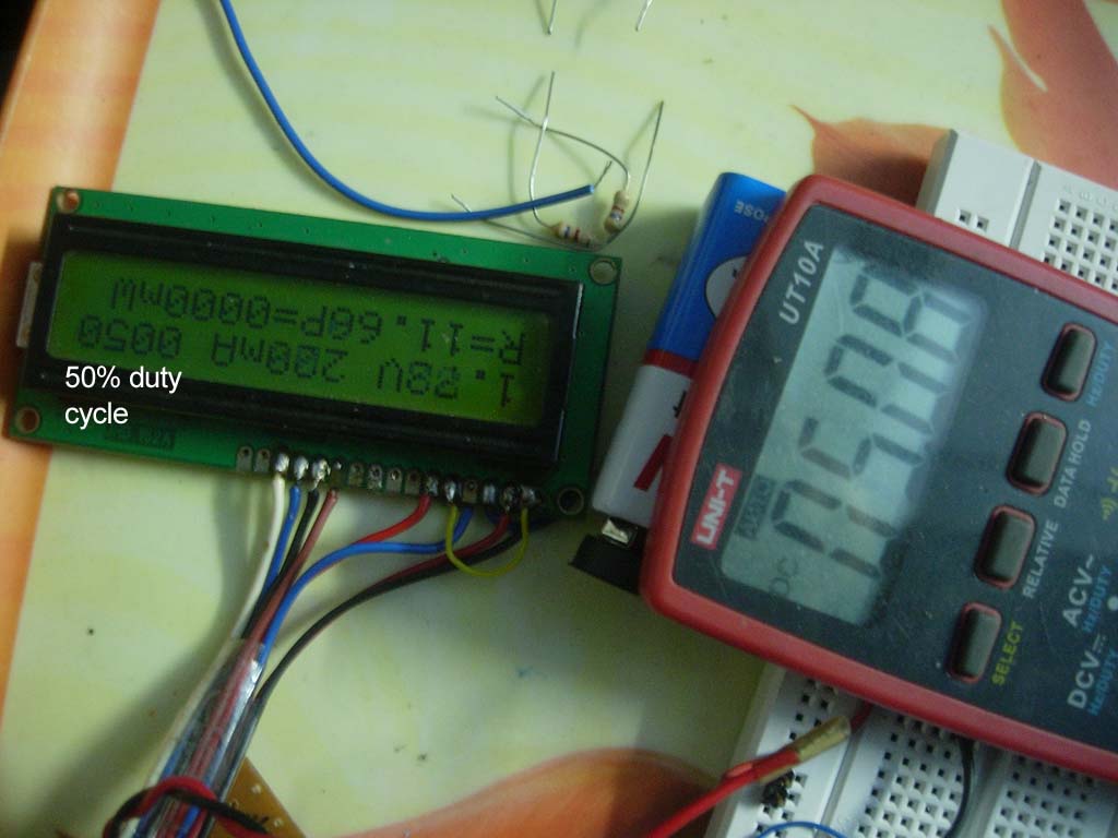

Now, I've changed something.
Changed the PIC clock freq. to 8MHz instead of 20MHz to generate lower frequency using PWM.
Now using 1KHz PWM frequency with 0-99% duty cycle.
But, anyway my problem is not being solved. still at 1% duty cycle I'm getting 4.97V. At 50% it decreases to 5.08V and it keeps decreasing then with increasing duty cycle, at 63% the output is 5.03V and finally at 99% it is 4.75V. How strange is it.

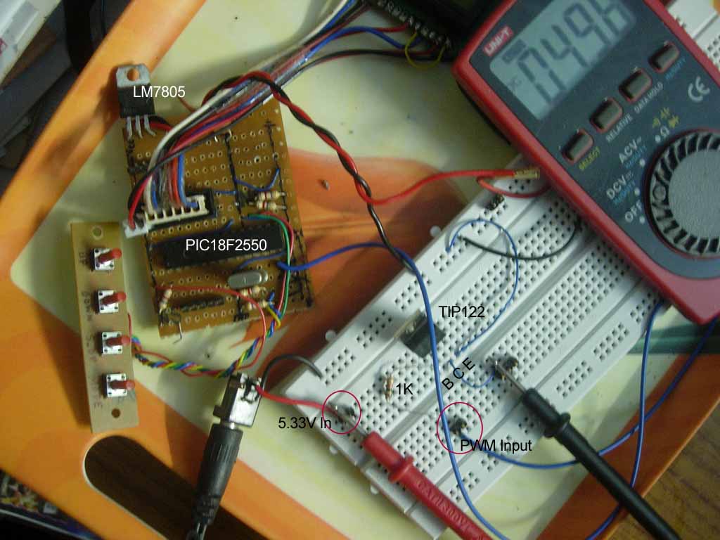

The PIC is running from a 5v source regulated by 7805 from a 9V battery. And the load is running (I mean what the transistor switching) from a power of 5.7V (meter showing 5.33V) of 1A.
Instead of block diagram, I'm uploading some images of the setup in real world.

Are the grounds of the two supplies tied together?
Where is your low pass filter?
Yes. The grounds are tied together.
Actually, I've removed the low pass filter. Well, I'll test it adding the low pass filter and then show you the results.
Is there a load? Don't forget that "PWM" signal will just peak charge any capacitance on the output and hold it waiting for paracitics to discharge it. You can't just set a certain duty cycle and expect a certain voltage... other considerations come into play.
