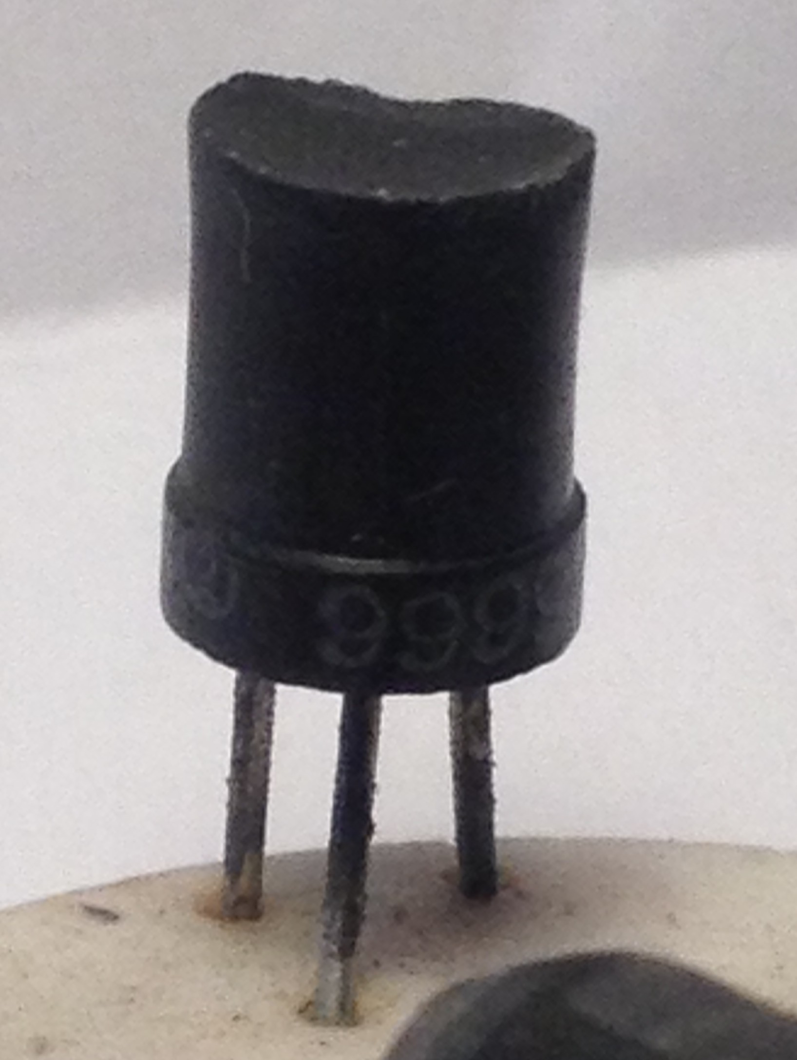

Can anyone identify this transistor. I'm looking for a Datasheet on it. I can't seem to find it in any of my books. I've never seen a a number with a circle around it. I tried looking it up as 2N9999 and still nothing. 2 9999 Transistor.jpg
Can anyone identify this transistor. I'm looking for a Datasheet on it. I can't seem to find it in any of my books. I've never seen a a number with a circle around it. I tried looking it up as 2N9999 and still nothing.View attachment 74562

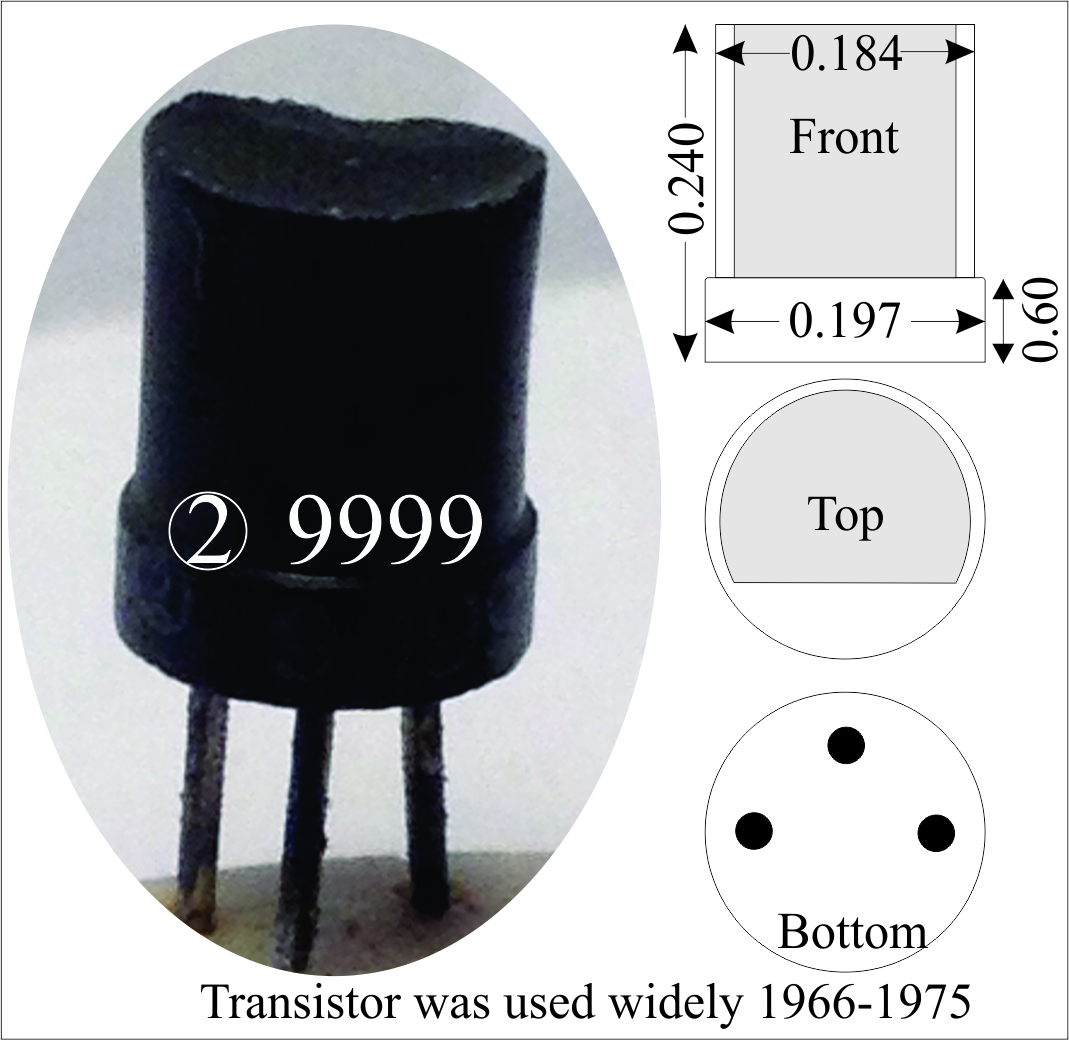

The numbers have obviously been added to the photograph. They are not printed on the transistor.
I added the part number text because its hard to see. Look across the lower section.
Also if you click on the first photo posted it has the actual dimensions of the part.
Here is the actual photo.
This transistor was used from 1966-1975 by GM. I cant afford to guess at a replacement because it could set my 69 Z/28's electrical harness on fire. I've had the car 37 years and it would be nuts to experiment with it. Someone must know exactly that this is.

The number is probably an "in-house" number from the company that made the circuit board.

It stopped lighting up the Low Fuel lamp on the dash and I'd rather try to fix the original which is better to have and only a few cents for a transistor then to pay 55 dollars for a Chinese replica that a lot of friends have said burn out on occasion and take the fuel gauge with it.:confused:
The 2Nseries ends at about 2N7xxx, and those high numbers are more modern parts, so it's very unlikely to be a 2N9999.
It will be easy enough to find a replacement if you post good photos of both sides of the PCB so we can work out the circuit. It's most likely just a small signal NPN.

bs, any low-level switching transistor will work. First thing you need to determine is if it is NPN or PNP. As long as the Vce is > 20V, there are probably are hundreds of general purpose transistors that will work...
That is the JEDEC TO-98 package which is obsolete---used back in the 70's.
"electrical harness on fire" Hu? It takes a LOT more to set the harness on fire than a simple shorted transistor.
