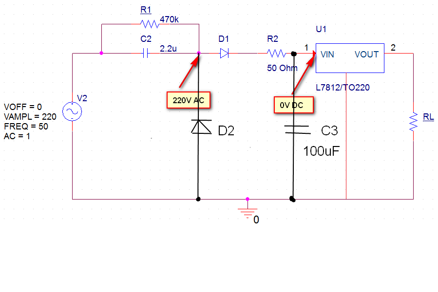

Hi ronsimpson

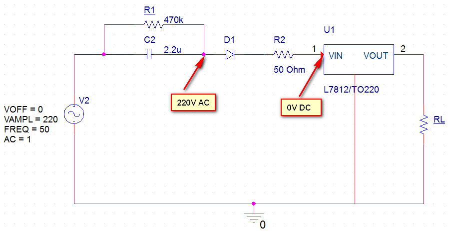

pls with respect to the capacitor 100u ,i think the max voltage to applied on it in the range of 10v to 25V or less,how could i make sure that the voltage across it will not exceed the rated values
Thanks for all of you who's modify the circuit and warn me about the dangerous of it,but really i want to build a sunlight detector and fixed at my house door which use this concept for providing the power to the circuit and i found it on the web,but when i execute it the output voltage was drop to low value (at sunlight) due to the design of the power cct so i decide to modify it to be suitable for the circuit
There are far better ways to implment this.
First define what output you need.
e.g. Logic 0 or 1 isolated or triac drive output non-isolated or contact closure isolated or Optoisolator saturated output?

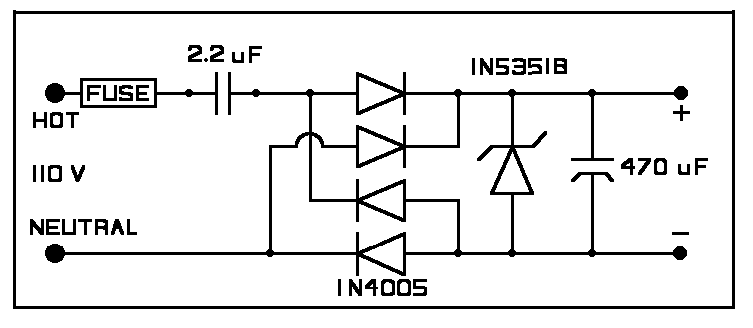

Hello there,
The original circuit is improved with the addition of another diode because the capacitor can not function on AC with one diode rectifying the current into DC. The capacitor charges and stays charged and therefore can no longer pass AC. So the second diode is mandatory.
In spite of that improvement, you really should use the full wave bridge version. That's because for one thing you already know now that you need two diodes, so for the price of two more diodes you get to use a capacitor value that is one half of what it would need to be if you only use the two diode solution. This is because with the two diode solution the cap only passes current that the circuit can use for one half of the cycle, so you need a cap twice larger to pass the same average current as you could with a full wave bridge. This becomes more important when you try to draw a little more current than a few milliamps.
So start with a full wave bridge and go from there.
The only time this doesnt work is when you need a circuit connection that is common to one side of the line, but when that is not needed then the bridge rectifier is the preferred method.
You also need a relatively low value series resistor to limit inrush current when the unit is plugged into the wall. That will limit the max peak current through the circuit. Only catch here is the resistor should be rated for the expected power, and the expected power could go up if the cap shorts out. A fuse is also a good idea.
By now you have seen the precautions when using a circuit like this. It is not isolated from the line so it MUST not be used in equipment that has ANY circuit node that can possibly contact a human body part. That said, these circuits are quite common.

What you called "ground" on the schematic is not ground. It could be neutral or line. NOT ground.
As others have mentioned, transformerless power supplies seem simple at first but end up needing many components to protect other components. The power consumption of a tranformerless supply is the same whether or not there is a load, so your zener diodes will get hot. You need to allow 2 W of heat in the zener.
Tranformerless supplies are not isolated so all points could be at mains voltage.

If you use a transformerless supply, you have to consider:-
Capacitor inrush. The 50 Ohm resistor is for that, but ronsimpson's circuit has D2 placed where there will be a huge current through D2 and C2 if the circuit is turned on near the middle of the negative cycle of the mains.
Reverse current. Now handled by D2
Capacitor discharge. R1 is there to discharge the capacitor when the circuit is disconnected.
Excess current. This is handled by the zener voltage of D2, but it will get hot.

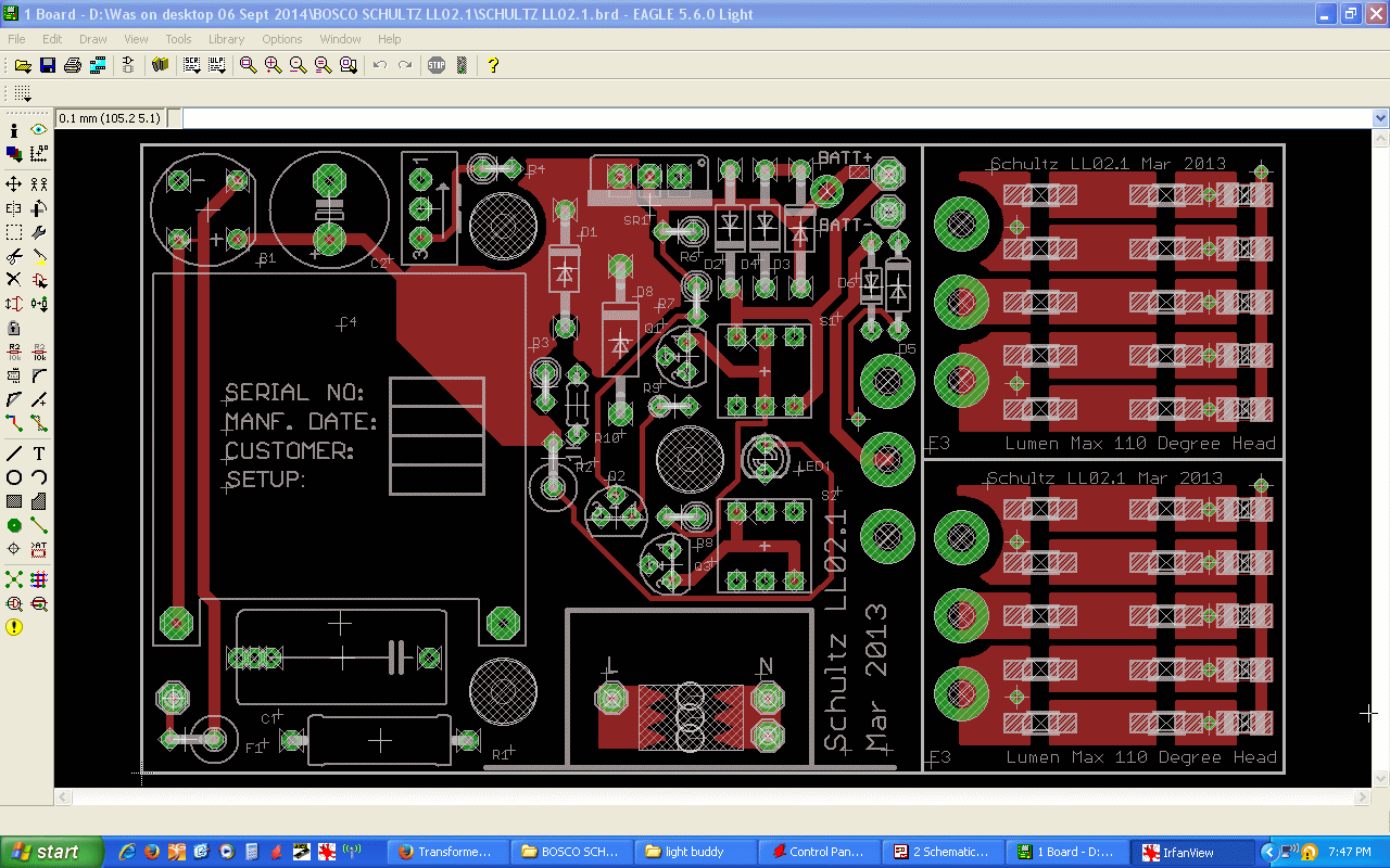

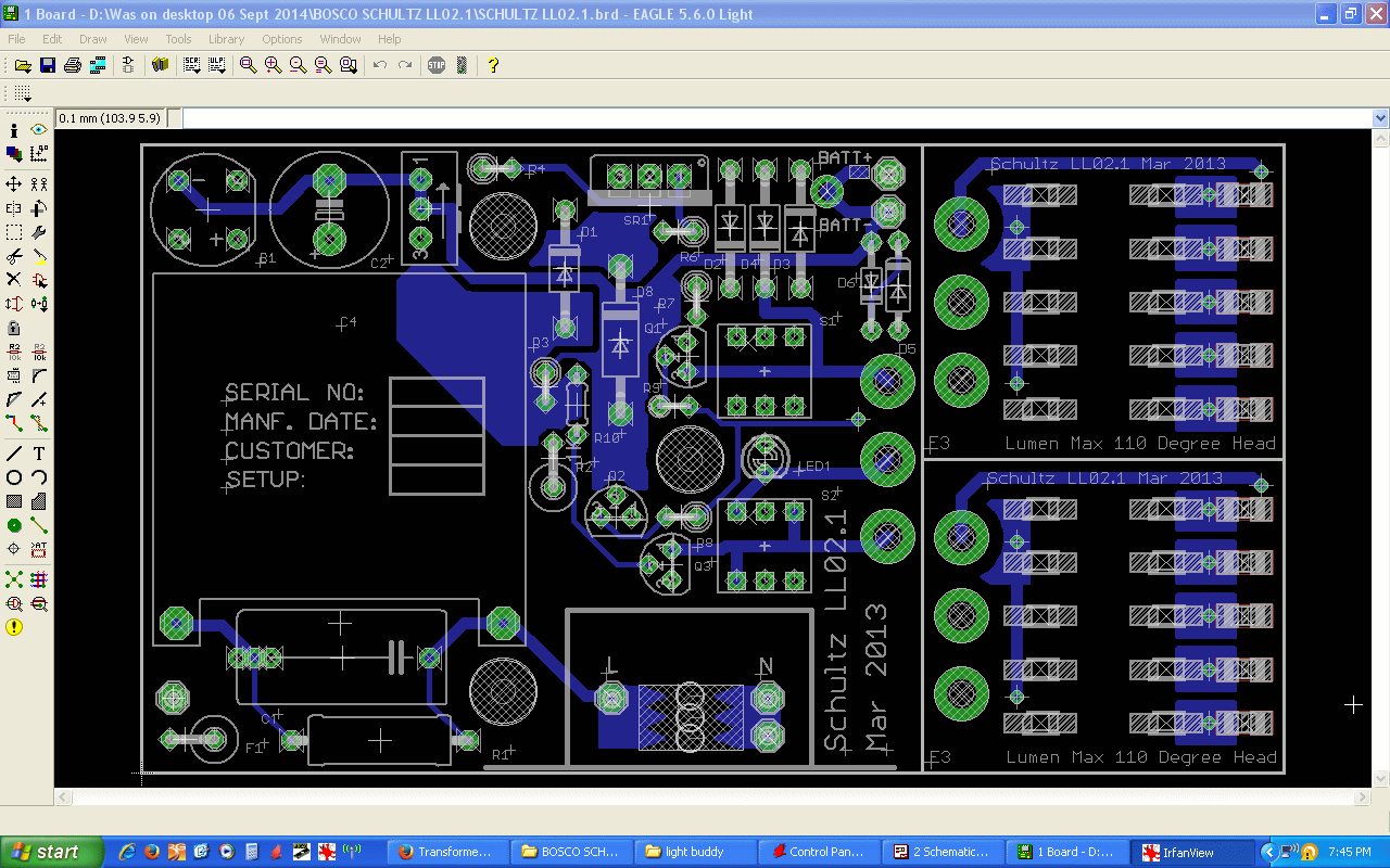

I never thought I would do this...but what the hell.
Bottom and top traces here..this is as reliable it gets.
Same layout that seems to survive anything thrown at it. SMPS go to hell and burst Main Smoothing caps...this one thrives on Crap.
Anyway, my design, my layout and my little project. Sharing it with the World here you can all learn stuff.
