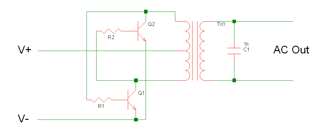

You need a power oscillator driving a transformer.
You can use a huge, heavy, expensive, low frequency transformer or a small, ferrite-core, inexpensive, high frequency transformer.

The simplest inverter method I can think of would be this. Two transistors or mosfets and two resistors with an optional output smoothing capacitor built around almost any decent ferrite HF transformer core.
The 100W resistor is allowed to dissipate a max power of only 30W at an ambient of 25 degrees C with a 1cm square heatsink. Then I think its temperature is 200 degrees C which is extremely hot. It will seriously burn you and melt plastic.
