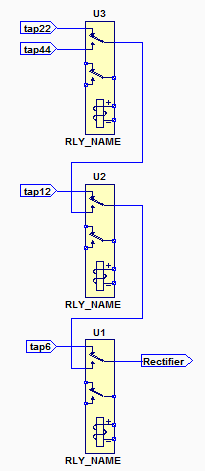

I'm in the process of building a variable bench power supply. 0-50V @5A.
I have wound the transformer secondary for 0-6-12-22-44 taps. By doing this I can geep the dissipation through the output transistors to a minimum.
I would like to build a circuit that can automatically switch the taps in and out as I advance the voltage pot etc.
Obviously only one relay should be on at any given time, otherwise two of the taps may be shorted. BOOM!!
I will have to power whatever circuit and reference voltage from one of these taps as I don't have space for another auxilary power supply to power this circuit too. I was thinking 4 comparators driving npn transistors, switching 4 relays in and out.
Any ideas? Anyone build something similar before?
You can get round the problem of shorting taps by using relays with single pole change over contacts. The first relay (RL1) will have it's common to the rectifier and its NO contact to TAP 1 on the transformer. It's NC contact goes to the common of RL2. RL2's NO contact goes to TAP 2 on the transformer. Just repeat this sequence for the number of taps required. When more than one relay is energised the tap connected to the lowest number relay will be selected. The relays can be driven from comparitor chips and transistors connected to a potential divider chain connected to the voltage setting pot (Via a buffer.) You could also use the difference between input and output voltages to select a higher or lower tap but this might have a tendency to jump between taps.

Here's my take on Les's idea for connecting the relays.
You only need 3 relays for your 4 taps.
With no relays energized, tap 6 is connected. You then just turn the relays on in sequence (U1, U2, U3) using three comparators, to sequentially connect each of the other taps without having to turn the previous relay off.
Thus there's no concern about having more than one relay on at a time and shorting two taps together.

The peak current in the relays will be high. Don't use small relays.
Yes, there will be a large surge current to charge the filter capacitors whenever the tap is switched to a higher voltage, which can weld the contacts of a small relay.
A small resistor in series with the relay output to the rectifier-capacitor would help reduce this surge.
crutschow, Your schematic is exactly what I thought. I agree with all the above comments. dr pepper makes a very good point about the situation when the power supply was in current limiting mode. If the relays were controlled by the input / output differential (Rather than the desired output voltage.) then this problem would not occure. Overnight I was thinking about the contol methods using comparitors for window detectors (So some hysteresis could be put in the system to avoid relays clicking on and off near the changeover levels.) I decided if I was doing it I would use a micro controller. I would use 3 analog inputs. (Via potential dividers.) One to voltage setting pot . one to the regulator input and one to the regulator output. This would make adding hysterisis simple and would allow changing from the set voltage method to the input / output differential method just by changing the firmware.) One other point is I don't think the OPs idea to use one of the transformer taps to provide power for the contol circuit is posible unless only half wave rectification is used to power the control circuit.

Thanx for all the help. Got a little comparator circuit going with Crutschow's relay diagram.
Works a charm!!
