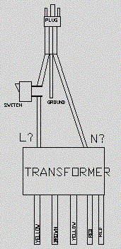

Hey guys, me again. I figured I would post a sketch of the transformer in question. I just need to know how to test the secondary wires with my multimeter. Again, I really don't want to fry the poor thing.
RED and RED have continuity
YELLOW AND YELLOW have continuity
Any suggestions how I would go about finding the voltages and amperage for each secondary wire? Thanks a million!

Quite often the windings are independent of one another so there is no common - but not always. The potential you are trying to measure is between at least two of the leads (there could be a center tap). Sometimes the two leads on each winding are the same color - but not always, as Dean indicated.

The illegible vertical figure states BROWN. This brown wire has continuity with both of the two yellow wires. Center tap?
So the wires from left to right are
1. Yellow
2. Brown
3. Yellow
4. Red
5. Red
Sorry for the small sketch, I thought that it would appear larger on this posting, since my previous posting sketches were huge!

Okay,
Voltage across yellow and yellow is 5.7 volts
Voltage across red and red is 26.7 volts
Voltage from brown to yellow (both first yellow and second yello) is 2.7 volts.
So I have a 120VAC primary, 5.7 VAC and 26.7VAC secondary? Using center tap, 2.7 VAC (3 VAC nominal?) and 26.7 VAC secondary.
Cool stuff!
Because of the voltage being measured on the brown wire, we'd call the yellow-yellow winding 5.7vct (5.7v, center-tapped). However, the actual voltages of these secondaries, had the transformer been marked may have been closer to 5.0v and 24v. Unloaded secondaries will show much higher voltages than fully-loaded secondaries.
As to the current you can expect from the secondaries? That's a trial and error deal. If the resistance of the yel/yel secondary is less than 1/5 the resistance of the red/red secondary, it will probably have a higher current capacity. If you can see the actual wire used to wind the two secondaries, it might be an indicator of current. There really isn't a good way to tell how much current they can handle other than by trial-and-error, seeing how hot the transformer gets under load. Still, with two secondaries, you don't know which is causing the heating!
