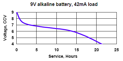

A 9V alkaline battery is made for supplying a few milli-amps, not 100mA. A carbon-zinc or "heavy-duty" 9V battery is made for almost no current.
Here is a graph of a 9V alkaline battery with a 42mA load, yours will last less than half as long:
