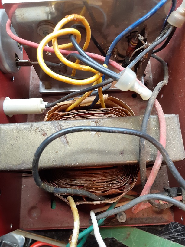

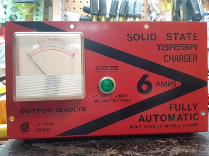

I have an older Torcan 12v battery charger that has a center tap transformer, on the secondary, one wire has 14 volts while the other has only 7.
The total output for the charger is only 11 vdc.
Should both secondary wires have 14 volts?

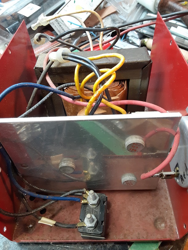

It only has one diode .
The diode looks good and two resistors are also good.

Tested the two rectifier diodes and one is .44nF while the other is .76nF.
One is 88 ohms while the other is 57 ohms.
Would that make much of a difference?
I'm now reading 14 volts on both secondary's.

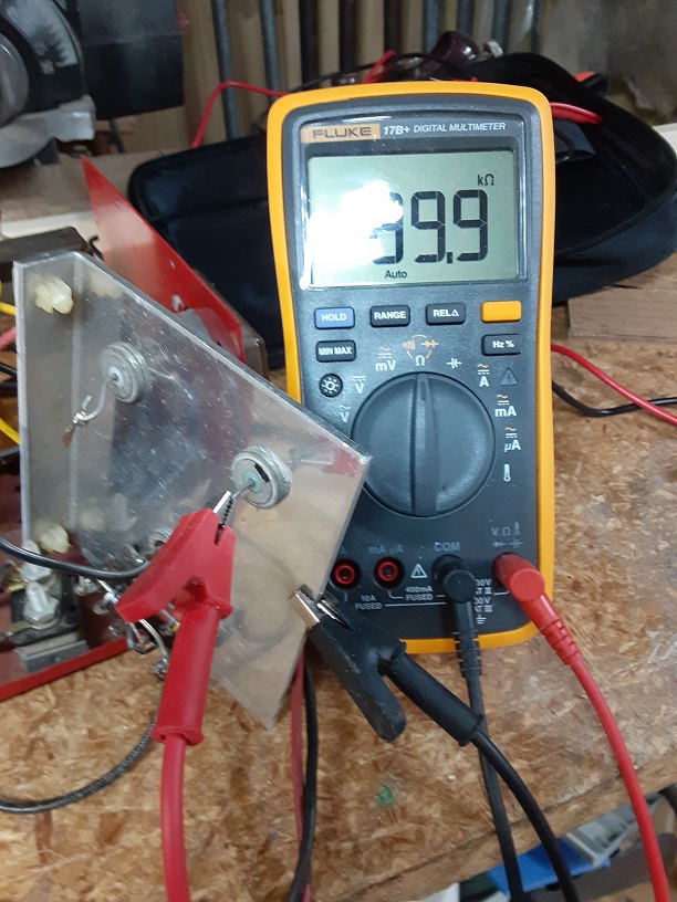

What meter range did you use to measure the resistance?
Most modern VOM's cannot test a diode on the resistance range, only the diode test where the diode is forward biased and the volt drop is measured.
You cannot measure the resistance of a diode/rectifier without passing enough forward current.
Which if the result was Kohms then that would confirm it.

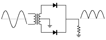

The basic transformer - rectifier power circuit is probably like this; the resistor represents whatever load it feeds.
As there is no smoothing capacitor, the output is "rough" DC and a voltmeter will show the average voltage - but the peaks will be rather higher and the battery would take current in pulses at each peak.
If you connect a suitable capacitor across the DC out side, it should allow the meter to read that peak voltage, if needed.
With the diode test both diodes are .467 volts so they look good.
Thanks for pointing that out, new meter just learning how to use it.

The output is 11 vdc, it was 14vdc a couple of years ago.
I don't think a 12vdc battery will fully charge at 11 volts.
