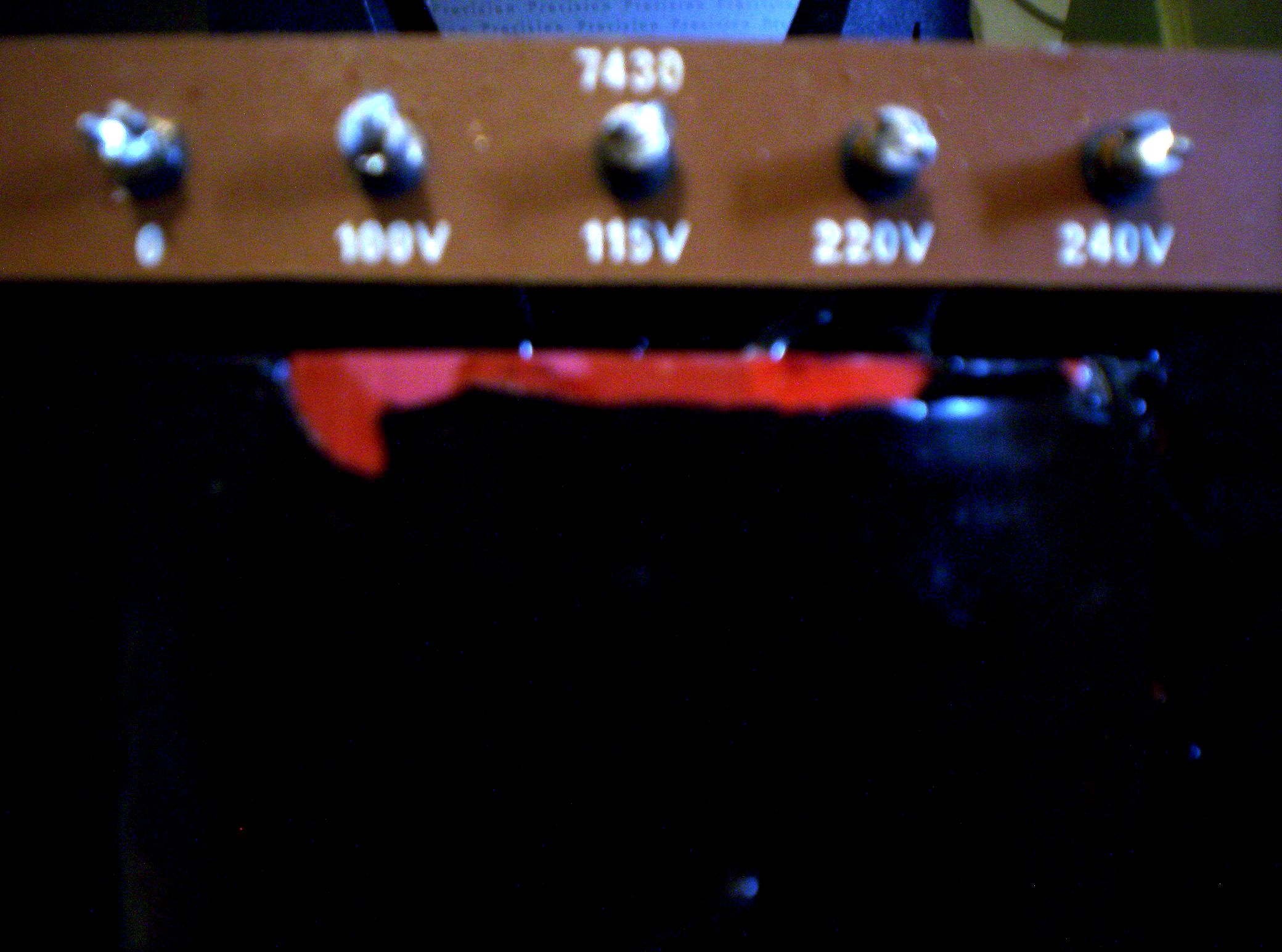

I have purchased a cheap secondhand transformer for an experiment that i hope i have chosen correctly?
If i am wrong please belt me across the ears at any stage!
I need to make sure i have the right thing not being sure about transformers & need some advice & also to make sure i have the wiring side of things correct before i go ahead.
I am hoping this is a Step-Down Transformer with the Output 12v AC 150amp as marked on it.:confused:
I have attached a couple of blury pictures of both sides of the transformer to show the connecting poles.
On one side --- Input side of the Transformer there are 5 poles marked:
( 0 100v 115v 220v 240v )
Our Mains power is 240v AC so, for the correct wiring as i see it, i connect:
The ACTIVE wire to the 240v pole,
The NEUTRAL wire to the 0 pole,
& the EARTH wire to the Chassis.
Is this correct?
I actually want to control this Transformer with a 240v AC 10amp VARIAC so i can vary the output.

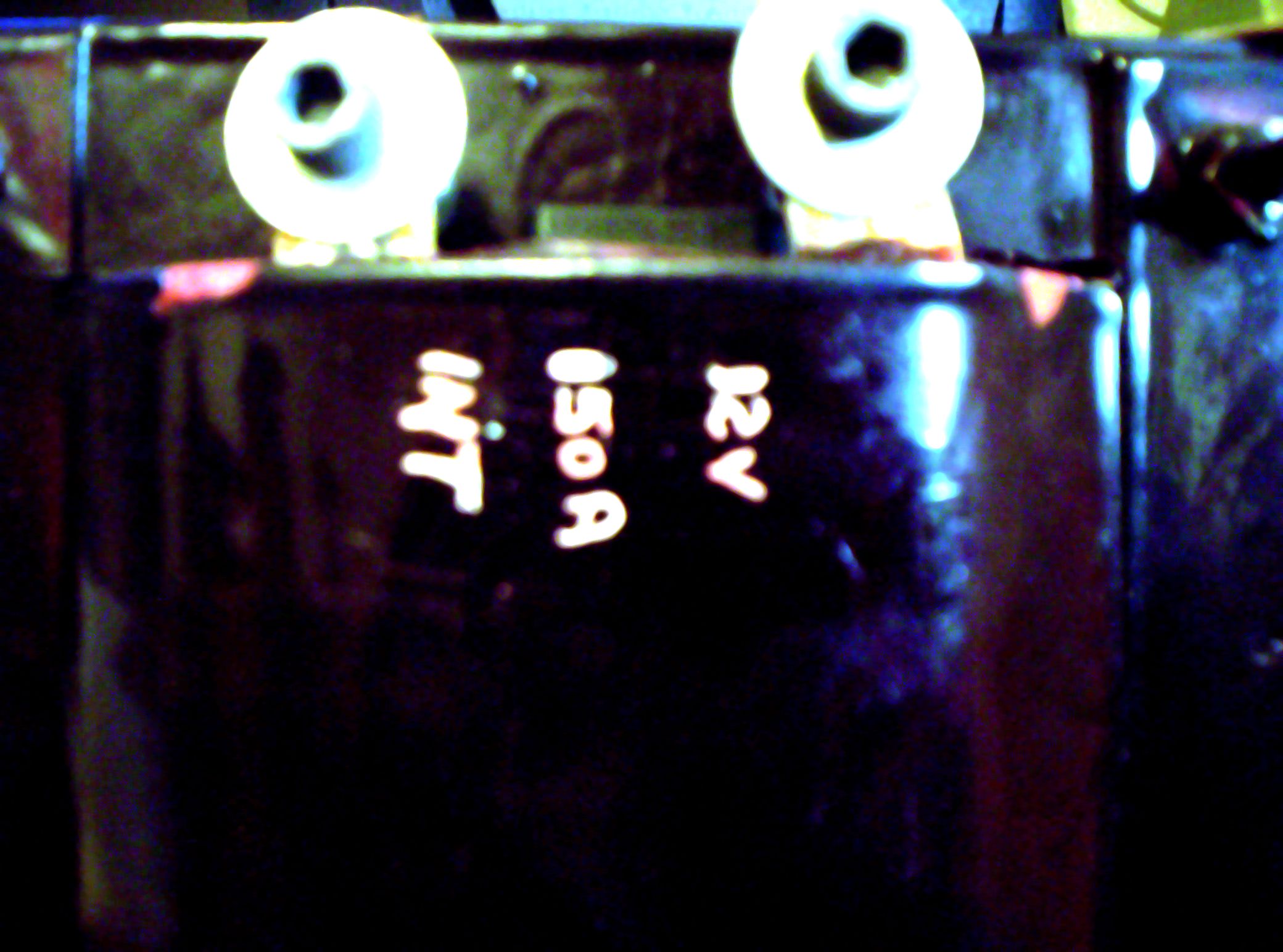

On the other side --- output side of the Transformer there are two poles, for the ACTIVE & NEUTRAL wires. If this is correct doe's it make any difference what the ACTIVE or NEUTRAL poles are as they are not marked?
That is correct.
The output 12 volts at 150 Ampères equals to 1800 VA or Watts
Your primary current will be 7.5 Amps at 240 Volts.
A 10 Amp variac should be fine.
We call the (poles) Taps in the trade
Regards, Raymond
To check the secondary voltage, use a voltmeter.
It may be a little higher than 12 volts with no load connected to the TX.
The polarity doesn't matter here.
It pays also to check that the primary and secondary coils are insulated properly from each other. It looks as a TX with 2 separate windings from your photo.
And it is a step down TX according to the data from the photo.

Though I would test the used tranformer first -to assure it is working properly. An ohm-meter will let you know if there are any short circuits between any winding and the transformer core. Though testing for any possible short circuits between wire windings will have to be done by monitoring the power in/out-which is approximately equal (assumming high 90`s efficeincy). Using your variac set low (slowly stepping up), with no load attached measure the output voltage. If all is good, attach a load and test again. Also, the output is isolated from the hot and neutral-therefore they are electrically the same.

on the secondary side, it says 150A INT, so it is not continuously rated. It may well give 100A continuous though. It really depends how intermittent the 150A loading was intended to be. Ideally you need to know the duty cycle and time frame.
it's a big beastie though, so will warm up slowly. just keep an eye on how warm it gets. if you can't keep your hand on it, then kee both eyes on it ;)
