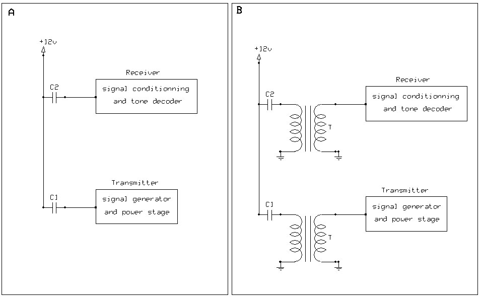

Is this how it may be done?
i draw that circuit, please tell me if my approach is correct..
Am i missing some important components like diodes or transistors somewhere... (seems like a stupid and ugly question, i know! :D)
Also, i included two versions.. can you tell me which one is better and why..?
and at last, would that work at all?
thanks a lot

hi ika,
Basically both your circuits are capacitance coupled to the power line.
The power lines are very low impedance and require a low impdance driver, that is, inductive coupling using a transformer.
What frequency are you going to use.?

hi ika,

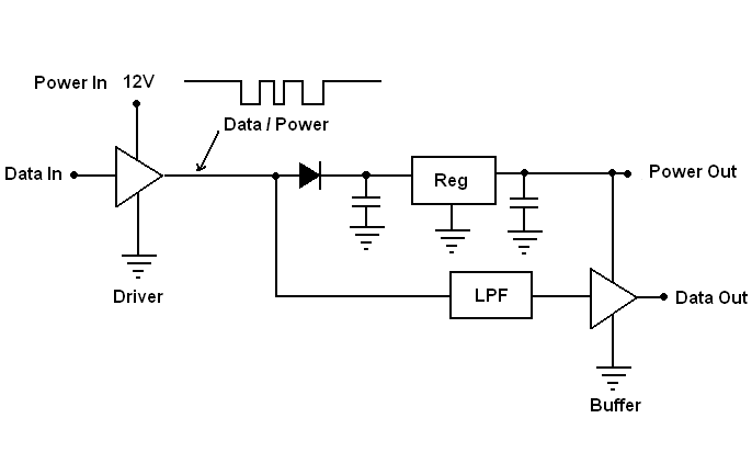

The reason these work well on the 50/60Hz AC line is that the impedance of the power line is relatively high at higher frequencies so it is fairly easy to superimpose a carrier on the AC line.
Compare this to the 12V DC bus of a car where most of the electronics have a capacitor across the DC input which presents a low impedance path to ground for any carrier you try to superimpose.
As I alluded to, and dknguyen stated, the best way is something like this:
