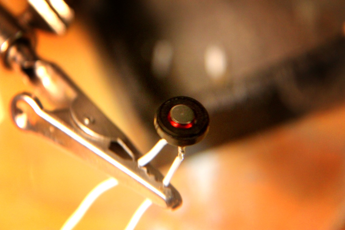

i am wondering if it would be possible to use a buzzer / transducer as a guitar pickup. right now i have crack open one and put a small magnet on it: i can read 30mV rms when playing a string. i guess it would be possible to build a preamp to bring that closer to 1V / 2V but what about the impedance? the buzzer i am using is 50 ohms, like this one https://www.digikey.ca/product-detail/en/GT-111P/433-1020-ND/479666

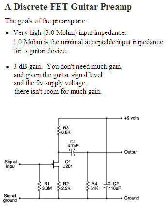

EDIT: I see you posted a schematic. Why does it use so many Jfets? Usually a guitar NORMAL magnetic pickup feeds a single Jfet like this one:

Hum pickup is caused by using unshielded wiring because then the wires are antennas that pickup hum and other interference. ALL audio signals use shielded audio cable.
The simple guitar pickup preamp I posted says that its gain is low because the output level of a guitar pickup is pretty high.

Does the mechanical buzzer have its own magnet? Did you remove the armature from the buzzer? Does your guitar have steel strings? Will you use a separate buzzer for each string? Will each string fit close to the magnet and the coil?

Yes here's the buzzer:
My goal is to use a buzzer for each string and i am trying to design a PCB that will hold the 6 buzzer as close as possible from the string (using more coil resistance = more sensible but the higher i can get is around 140 ohms). My soundcard is a recording interface (10 inputs - XLR - line input) and when connecting directly the buzzer: i can almost hear it when cranking up input / output. 40mV rms is not enough for line level i guess.

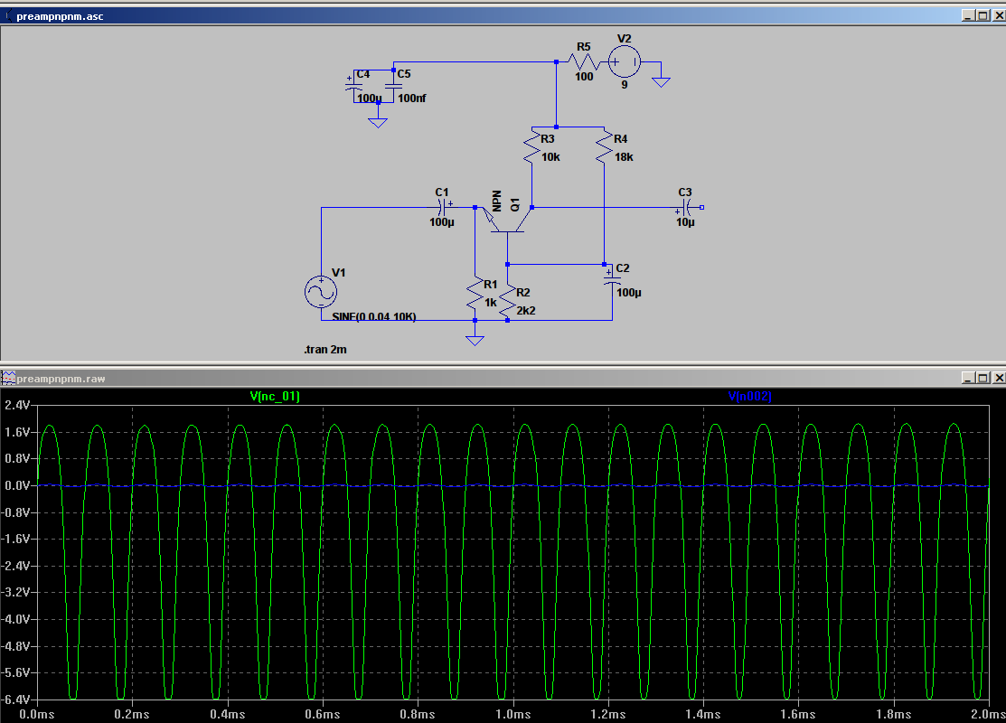

Here's a preamp that i found on the web:
Single-transistor pre-amp for very-low-impedance Guitar Pickups
https://www.joebrown.org.uk/wp/?p=7225
But I ran the simulation in ltspice and the signal is more towards the negative side no matter how big the caps is at the ouput:

A buzzer with a DC resistance of 40 ohms might have an AC impedance of 4000 ohms or more. You NEVER match impedances because you want to keep the small signal voltage produced and not throw it away. For a 4k ohms pickup then the preamp should have an input impedance of at least 40k ohms.
The transistor preamp you found has an extremely high voltage gain (and very high distortion) because the impedance of your signal generator is ZERO ohms. If the source impedance is 4k ohms (parallel to the 1k input of the preamp) then the voltage gain will be much less and the very low input impedance of the preamp will kill the output level of the pickup. Use a non-inverting opamp (it has a high input impedance) instead.
Yes the little disk is a weak magnet. Do you think I should try to use a rare earth magnet to increase sensibility? Well, i just made a test and the string is too much attracted.
