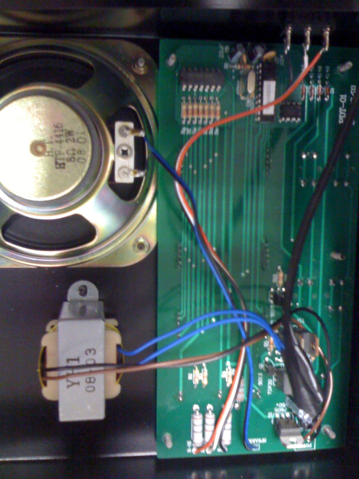

I recently purchased at a not small expense from the U.S. two LED boxing / sport interval timers with a sound feature. Presuming (one should never presume) that being an internationally accessed website. that these timers would be fine for our 230/240 volt output? (why advertise or sell them without a warning) I stupidly after much deliberation a talking to our resident electricians plugged one in. Yes it worked for about 15 seconds then died a horrific death well the LEDS leaked and smoked a little. :-/

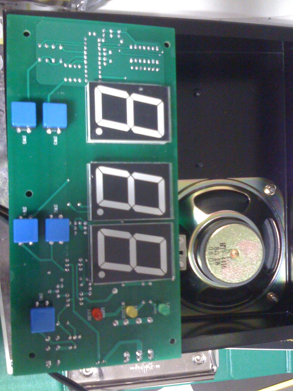

Now there were no labels on or in the case nor are there any switches to change voltage. there is really very little inside it other than a small PCB a speaker and a small copper wire wrapped transformer? :confused:I have pics of the internals for anyone that maybe interested enough to take up my cause?
I contacted the company and they were almost monosyllable in their reply and that reply was "220 volts"!
I want to know if I can convert the existing timer that still works to suit 240 volts and not have a total loss of over $300.00 AUD.
I am also quite willing to build one myself with my limited electronics knowledge if someone has a schematic I can follow.
Oh, they are capable of up to 10 rounds with breaks of 30 seconds or a minute round times are from 1 min to 3 mins. FYI

Hi searcher,

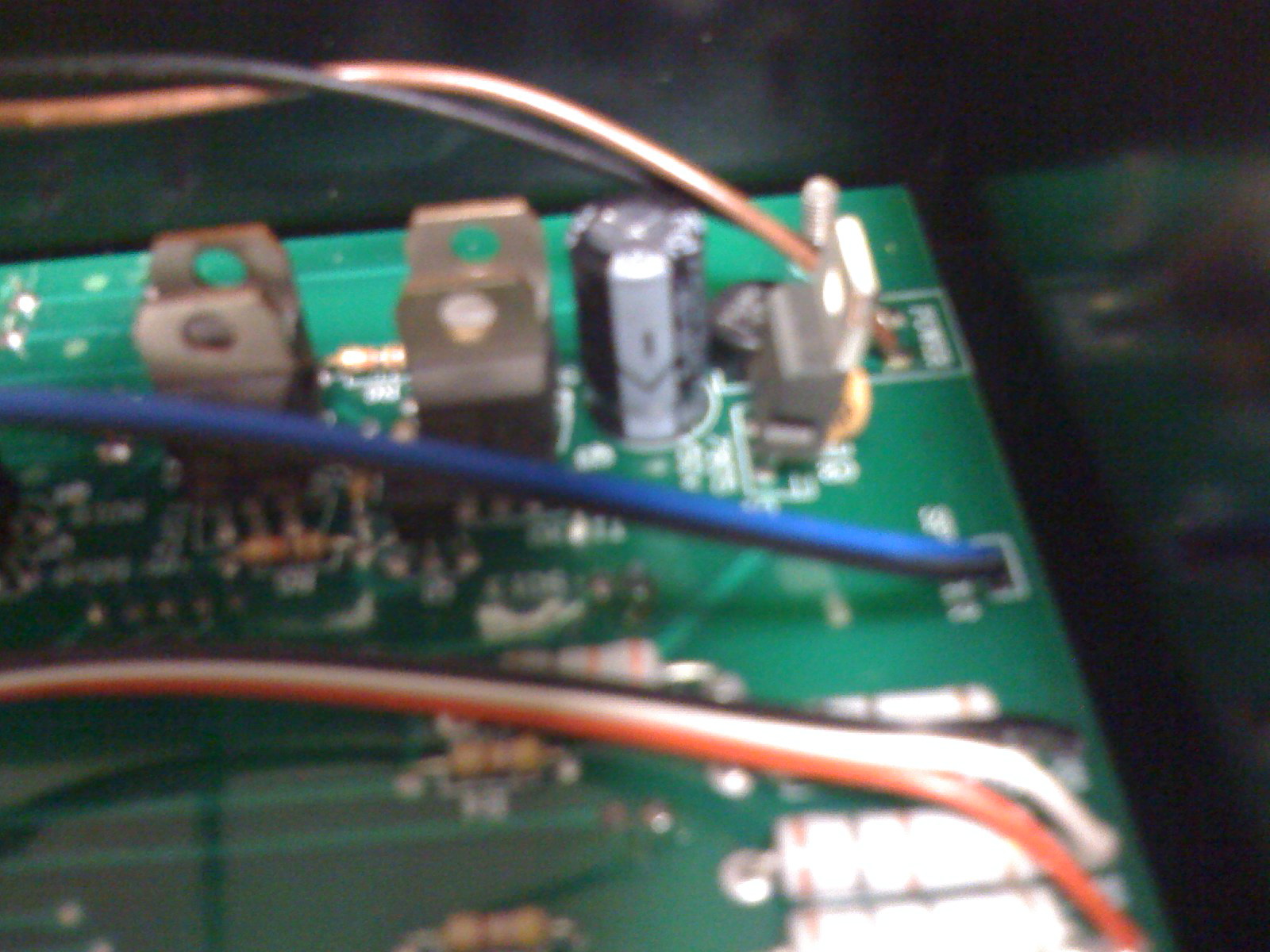

it would be good if you could identify the two vertically mounted ICs (pic.3)which should be voltage regulators.
They should be labelled XX7805 and/or XX7812. The XX is any combination of letters, probably LM or µC.

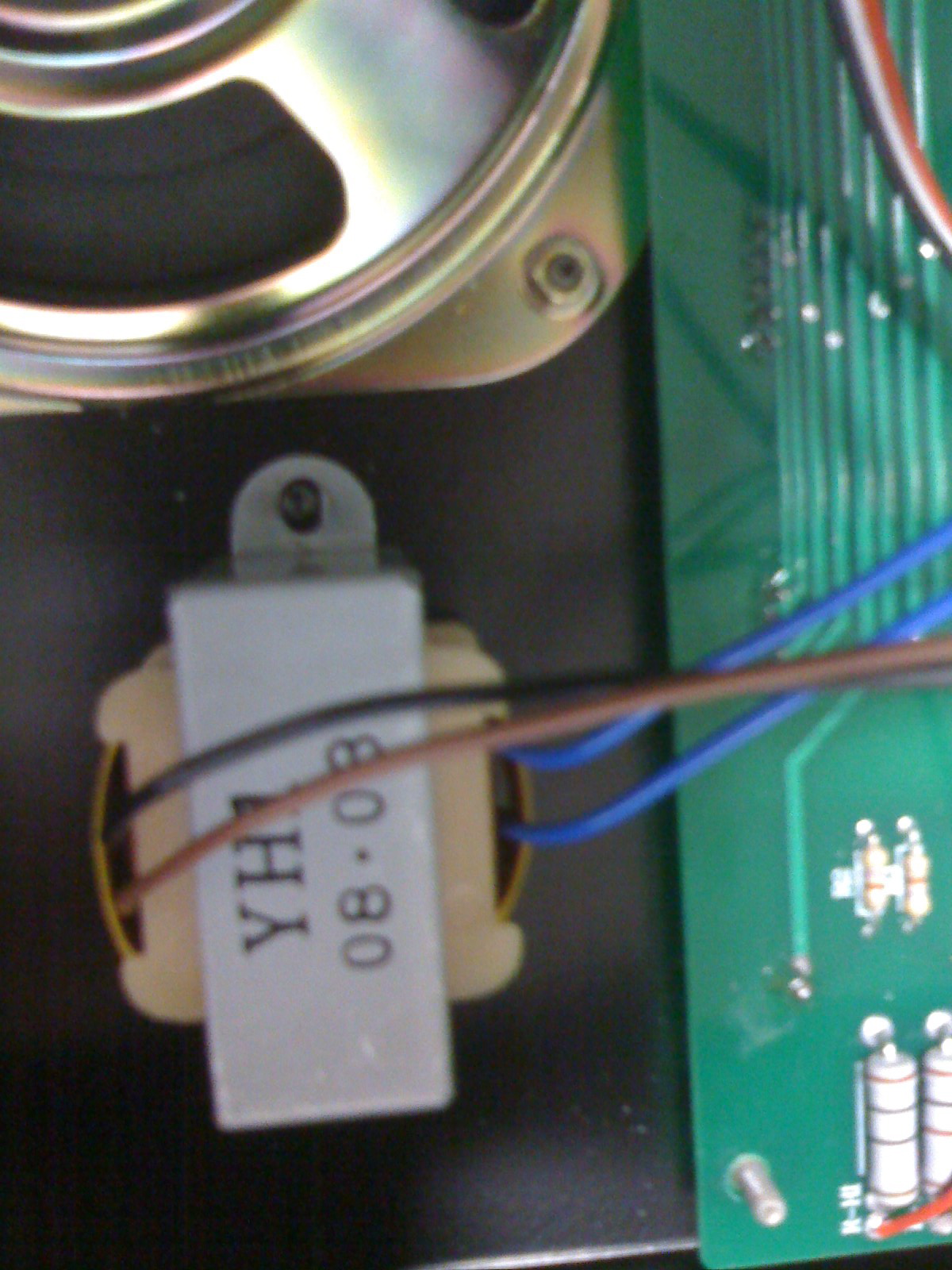

The mains transformer is the "thing" next to the loudspeaker. According to the size you could find an equivalent at your local electronics shop.
If you have a chance to measure the AC output of the transformer you could get an exact equivalent rated for 240VAC primary voltage.
If there is no chance to measure you could go by the highest voltage of the regulators and add 3V which will give you the secondary (output) voltage of the transformer.

As Boncuk says, if you can establish the secondary voltage of the transformer then getting a replacement should be very straight forward. If you're near Brisbane then I have a step down transformer that could be used to measure it.
