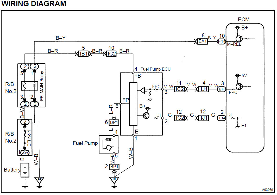

I am trying to replicate a Toyota fuel pump ecu from a 1990's soarer.
It's function is to run the fuel pump on 12V whilst the motor is cranking and under load/high RPM's. When at smaller throttle positions/idle it runs a 9V output to the pump.
I have done some auto electrics before, but, generally simplistic stuff. If anybody could help me by showing me a way of doing this, it would be brilliant.
I have thought about using a tachometric relay or circuit opening relay, but, cannot fathom how to make on change a voltage output....
I've been reading about comparators, but, I don't understand their function well enough. I have attatched a scematic diagram of the so called ECU.

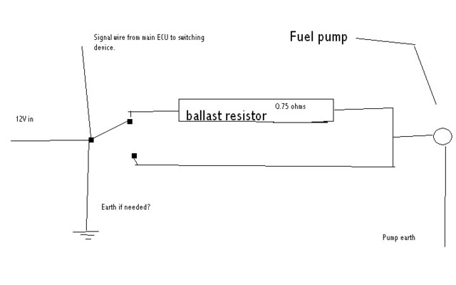

One thing that eliminates alot of trouble, is the signal wire from the main ECU is still correctly functional. So I can still use that signal, which is exactly what I want to do. All I need is a wiring scematic or a good explanation on how to make a switch to trigger at a given voltage, then I can throw the voltage through a ballast resistor. Reasonably simple and not much room for error. =)
Here we go, who can suggest a switch that would fit in here?

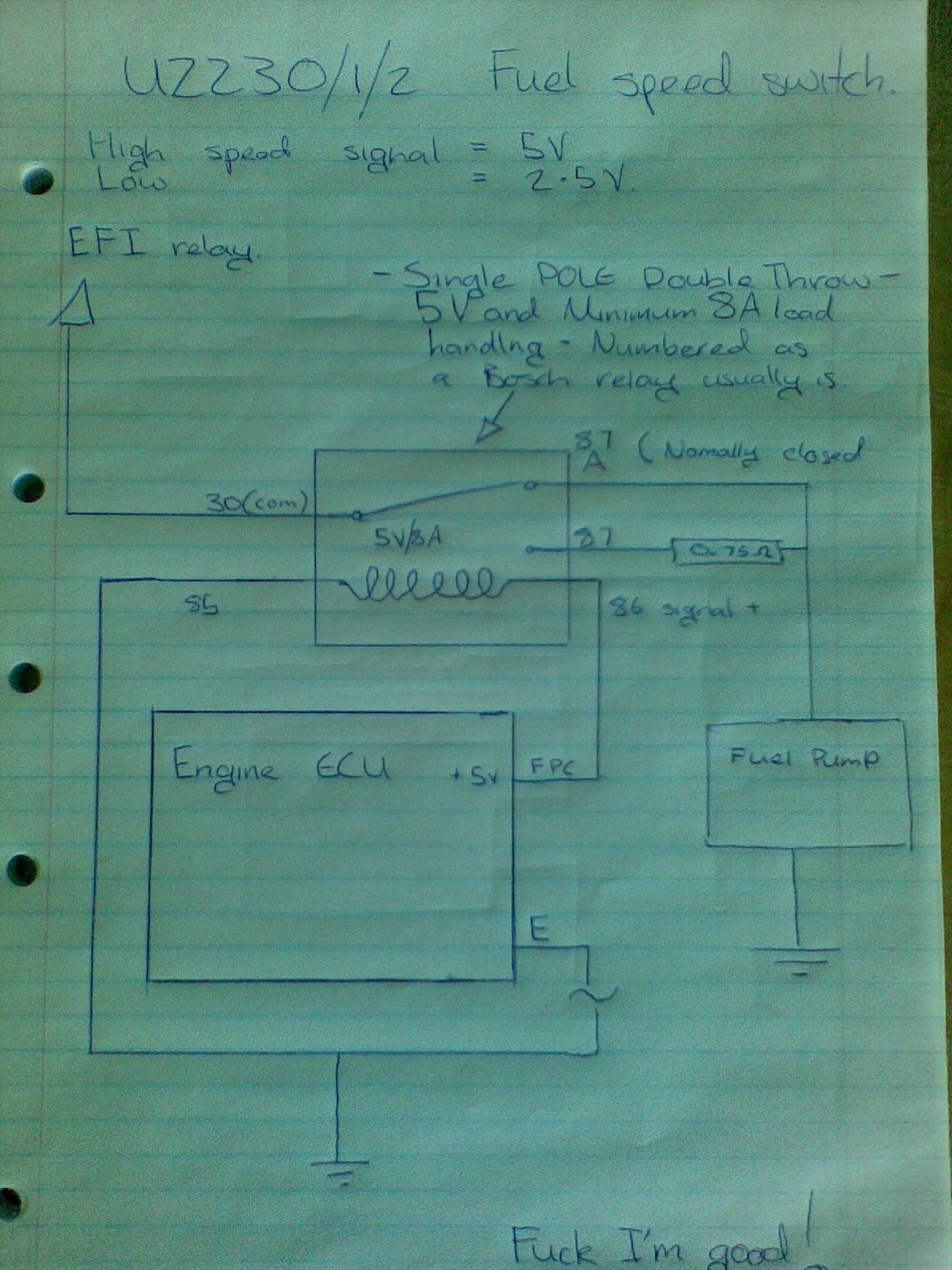

Big questions:
will your ECU output pin drive a 5V relay coil?
does the E terminal on your ECU put out 5V? If so, how much current can you draw from there?
The FPC input to the fuel pump ECU is provided 5V from the main ECU when the output should be at maximum (12V) and appx 2.5V when 9V is requested. If it works like other Toyota multi-speed pump drives, the 2.5V output is really a 5V square wave with a 50% duty cycle. It's a low current output and I doubt will drive a relay.
Same thing with the pump output. I think by 9V they actually mean a duty cycle of perhaps 75% which averages out to around 9V.
The DI line from the fuel pump ECU back to the main ECU is a diagnostic line. I couldn't find any information on this signal, but it's used to send information back to the main ECU about pump operation. You'd need to find out what signal represent "normal" operation or else you may have problems with how the engine runs or have the engine go into a limp mode with reduced power.
I think it would be important to see a working vehicle and put a scope on the FPC, DI and actual fuel pump supply to se what they are doing, but I'm confident you'll find they are PWM signals.
Big questions:
The current draw is really the issue, there is a 5V signal from the E wire when the fuel pump is to be switched to 12V.
Yes, the duty cycle is what is changed, but, effectively by setting up a lower voltage input [9V ofcourse] it should still push the correct PSI or Kpa? I have a friend with a good computer in his soarer[ I'm doing this for another mate] so I will try find the out put voltage/signal on the DI line. As far as it is explained on this link https://www.autoshop101.com/forms/h42.pdf
The DI signals only when the pump is non operational and this brings up error code 78, so by isolating DI perhaps that will eliminate this? The car doesn't go into limp mode with error code 78. It is the twin speed with ecu in the above link. I was thinking, perhaps dropping the power from 12V by using a DC to DC converter? All the bloody Voltage drop and current draw calculations have gone from my head.
