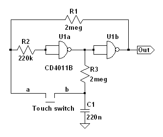

Hello,
I am trying to build the touch switch linked below. I want a touch switch that needs only one touch pad and this seemed ideal.
I just can't get it to work. It is always on.
I was trying to build it with just an npn transistor in place of the darlington. I'm just trying to turn on an LED so don't need a lot of power running through it. I thought that might be my problem so I improvised a darlington with 2 npn transistors. That didn't work either.
HELP!
Any ideas??? Should it work?

You could try this form of touch switch (which requires points a and b to be bridged by a finger). R2 provides some protection against ESD.
To use components you may already have, use R1 = 2 x 1meg, R3 = 1meg, C1 = 470nF.

I don't have two contact points available to me on my project. I want to be able to turn on the LED on an LCD by touching the frame. At least that was my hope.

Maybe it's me, but this one doesn't work for me either.
The schematic calls for a BD679 as the transistor
The symbol is confusingly not that of a Darlington, however :confused:.
That's a pity. Skin resistance is a major factor with that contact-bridging type. Also, did you have the inputs of the 2 'spare' gates in the 4011 package grounded? CMOS circuits with floating inputs can misbehave.

Whoa! Unused inputs must be tied to ground (or the +ve rail). Leave unused gate outputs unconnected.

Before I try the one I posted again, does it even look to you like it should work. No use in trying again if it's complete junk.
It seems temperamental. In simulation the assembly of gates oscillates at high frequency.
