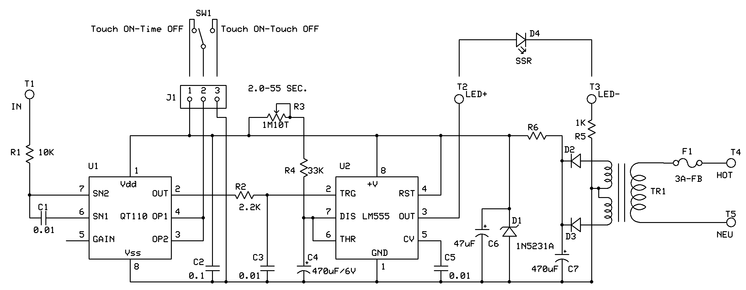

Attached is the circuit I used for the display. T1 was connected to a aluminum foil sheet on the back of a sign on the inside the 1/4" thick glass display window. D4 is the LED in a solid state relay that controlled a motor. SW1 allows you to select a "Touch ON/Adjustable Timed OFF" or a "Touch ON/Touch OFF" mode. Putting you hand up to the glass at the sign turned on the display.

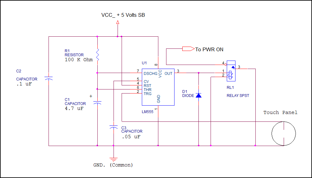

When you say you plan to use it on a scratch build of a computer case I will venture a guess that you want to use it to turn a computer on? Should that be the case then the attached circuit may work for you.
The circuit uses a simple 555 configured as a one shot with an output duration of about 1 second. That would simulate the momentary push of the front panel power button. The circuit would be powered off the computers 5 volt SB (Stand By) power line. The circuit relies on stray AC (50 or 60 Hz.) in the air. Sometimes it will work fine by just touching the lead connected to pin 2 of the 555 or better like drawn bridging pin 2 to ground. You make the touch pad.
If something like this is what you have in mind for a PC I'll provide more details on the connections.

Sounds about right, but here's the main problem, the scratch build of the case will be totally smooth (styled minimalistically) which is why I don't want to use a normal PC push button switch, so the switch will need to work through about 15mm of steel or so, basically I want to be able to brush my hand over a particular part of the case (which the switch will be under) and have the thing power on
Case modding huh? Good luck on having it below the steel case. Glass or Plexiglass as was suggested but steel is another animal. Another trick I have seen case modders do is a wireless remote using a key fob (like automotive). You got me as to touch or prox with a steel case unless the sensor is exposed.

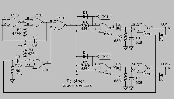

I've made a really simple touch switch that works using just the resistance of your body for use in my power supply. It uses a 555 with a PNP transistor connected to the trigger pin, when your hand touches the 2 exposed wires that go to the base of the PNP, it applies a negative pulse to the trigger pin so the 555's output goes high.

Ron,
If you are referring to my circuit, it does nor rely on stray AC in the environment. Is works on the added capacitance of the hand to de-tune an internal oscillator in the Qprox chip. It's generally very reliable.
https://www.atmel.com/dyn/resources/prod_documents/qt113_105.pdf
OOPS, I missed your schematic (it was below the screen). Never Mind!. :(
