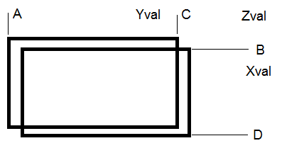

I write my own touch ( resistive ) driver... Two analogue pins and two digital pins are used..
If A = 3v3 and C = 0v then B will see 0~3v3v. ( Called Xval )
If B = 3v3 and D = 0v then C will see 0~3v3v. ( Called Yval )
BUT!! The read sequence is usually only initiated when the Zval is above a certain point.
So when reading the live points you will need a scope...
A will be 3.3v D will be 0 v and the two analogue pins C and B give the pressure ( Zval )
This all happens quickly as C and B are tri stated several times during the reading process..
