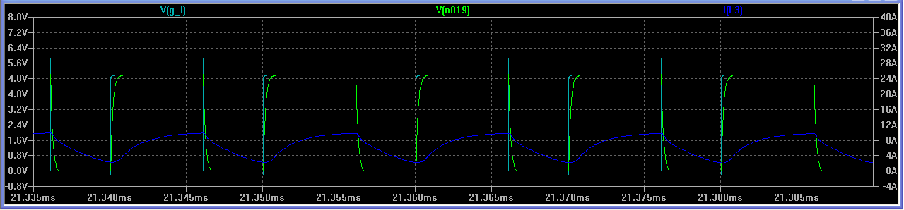

Hi..
I am trying to simulate a Totem pole Boost PFC circuit using GaN switches on LTspice. I am unable to achieve the DC output and the circuit is also not boosting up the input voltage. Any suggestions to make my circuit work will be a great help. I have attached my circuit here.
Thanks in advance!

The circuit is meant to work like an AC-DC boost converter (like in a bridge less boost PFC) here the 2 GaN FETs switch complimentary at 100 KHz and the two Mosfets M1 and M2 switch complimentary at line frequency (as the rectifying switches). The diodes D2 and D4 (the bridge) are used for bypassing the inrush current and charge the bulk cap in the first cycle. I see the inductor current going very high upto 400A which should be:( even after adding the bypass diodes.

D1,D2,D3,D4 -- ????
Why is there 190uH on the gate of U2 & U6?
-- U2,M2 . . . U2 won't close no matter the "point" G_H does +
+ PC817B opto has max transition frequency 80 to 135 kHz and that with 50% (or -50dB 3%) output !!! in addition to this 190µH -- you obviously didn't plot the Nitrofets side ...
I changed L6 & L7 from uH to nH and the gate waveform looks much better.
The L3 current looks OK.
