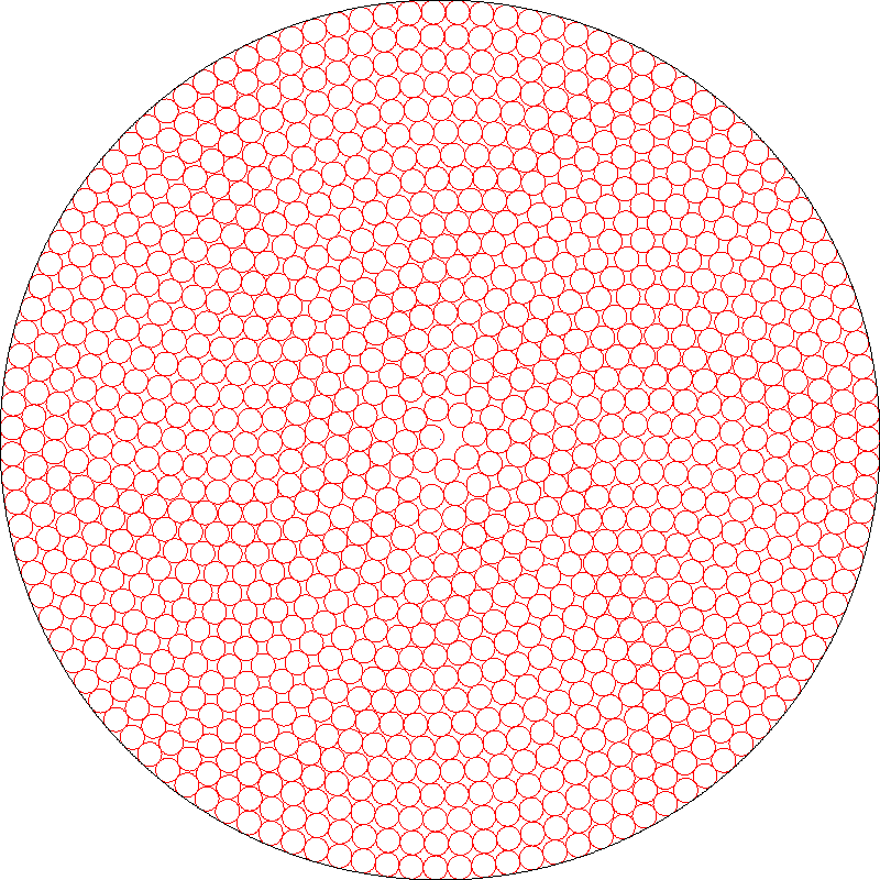

Hi there,
My favorite cores where toroids and a while back i wrote a program to
calculate the turns of wire that would fit in the core window of a toroid
and actually draw it to a file also. It's kinda cool to see this drawn out
so here's a picture of a core filled to the max with 1080 turns of wire.
Part of the goal in designing a toroid transformer or inductor
is making sure the turns will fit in the window area.

Hi there,
is it necessary to fill in the entire core window of a toroid or it depends upon the calculation of the number of turns
