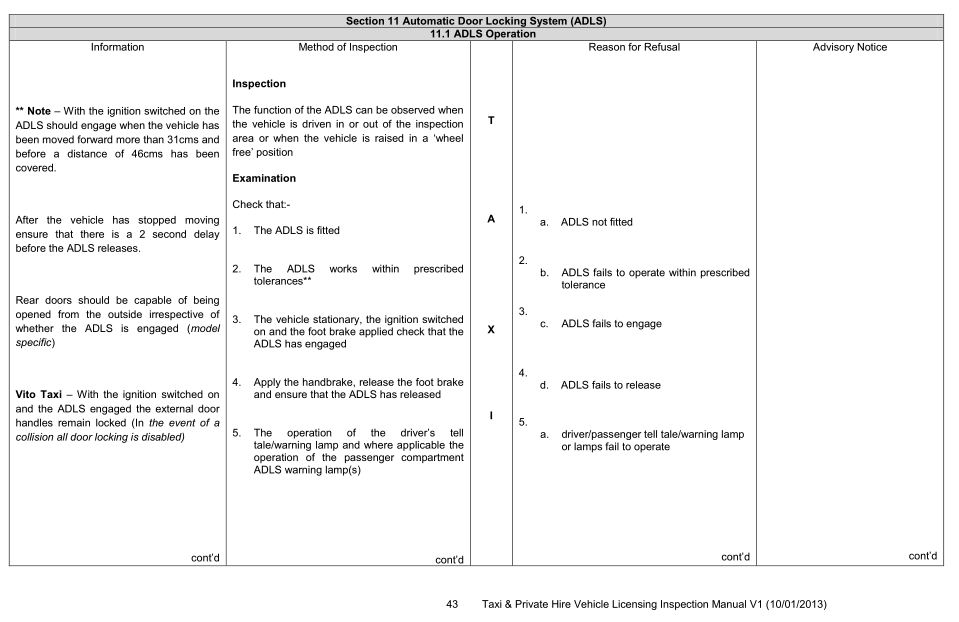

Edit: I found online a manual relating to London taxis and their automatic door locking system (ADLS) requirements.
This is page 43:
Are these the same requirements as yours? If so, how will you implement this bit:-
"With the ignition switched on the ADLS should engage when the vehicle has been moved forward more than 31cms and before a distance of 46cms has been covered. "

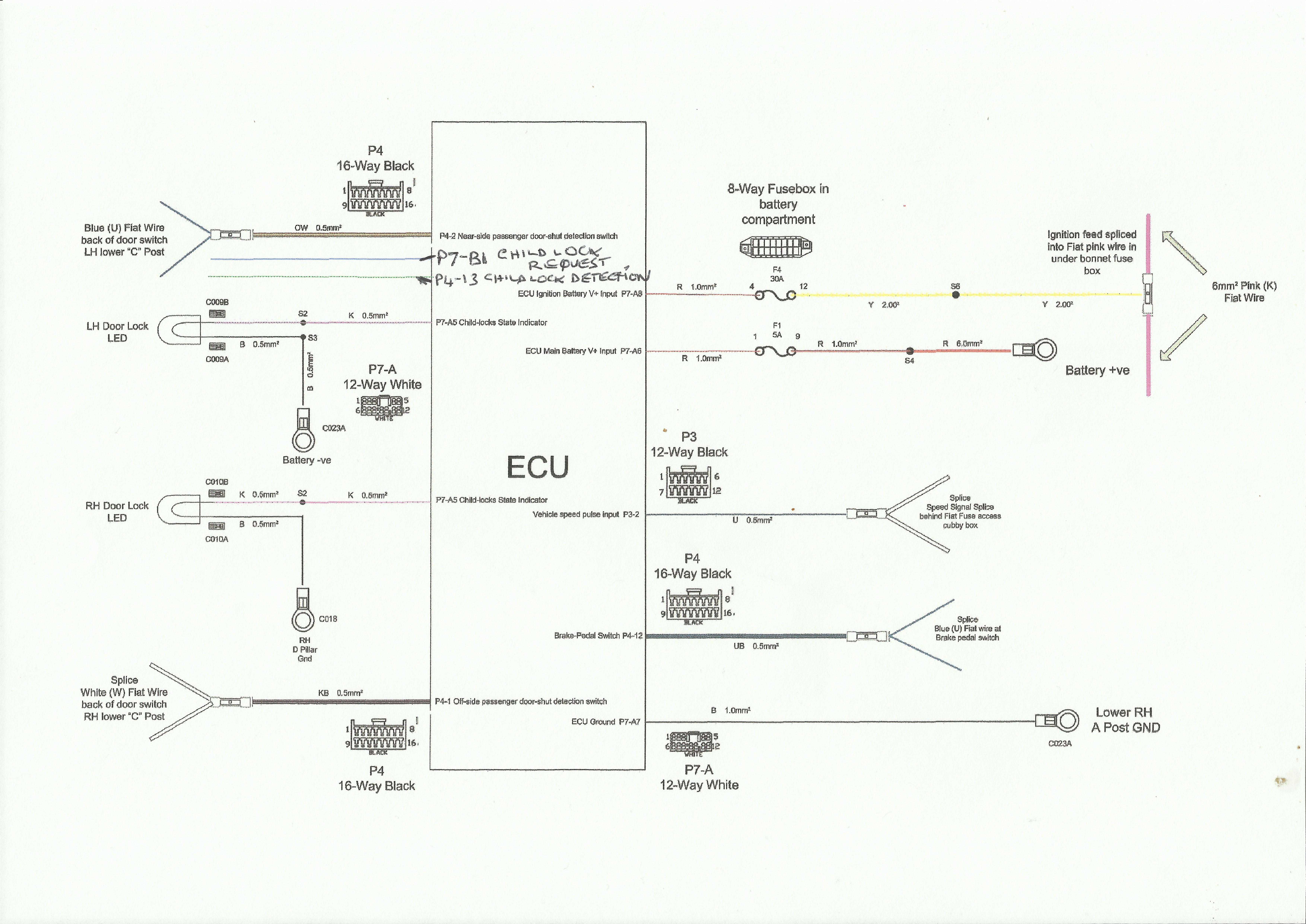

I managed to get an ecu that is used on the converted vehicles and connected the 10 wires that were needed to work the motion lock side and all is working fine. The connections needed were as follows:
12v constant battery supply
12v ingition supply
Earth
Wire from n/s/r courtesy switch(12 v when door closed)
Wire from o/s/r courtesy switch(12v when door closed)
Speed signal wire
Wire from brake switch(12v when pedal pressed)
Earth output to vehicle body computer to engage child lock
Wire from body computer informing state of child lock(12v when locked,earth when unlocked)
Wire to LED(12v when child locks on)
I noted that if the lock state wire is not connected ,then when the brake was pressed there was an earth switched 4 times at 1 second intervals on the output wire and the locks ratcheted on and off 4 times.
I will post a schematic in a couple of days
Thanks for your advice and help
With the lock state wire connected are the locks now controllable from the brake pedal as required?
I'd be interested to see the schematic.
Everything working as it should. I was trying to design something that would stop me having to fit the conversion ecu because it is a very large unit containing many circuits that wont be used on this car. I will post the schematic in a couple of days. Unfortunatley it isnt a full schematic,only the pin numbers that the wires go to and a description of their function.
