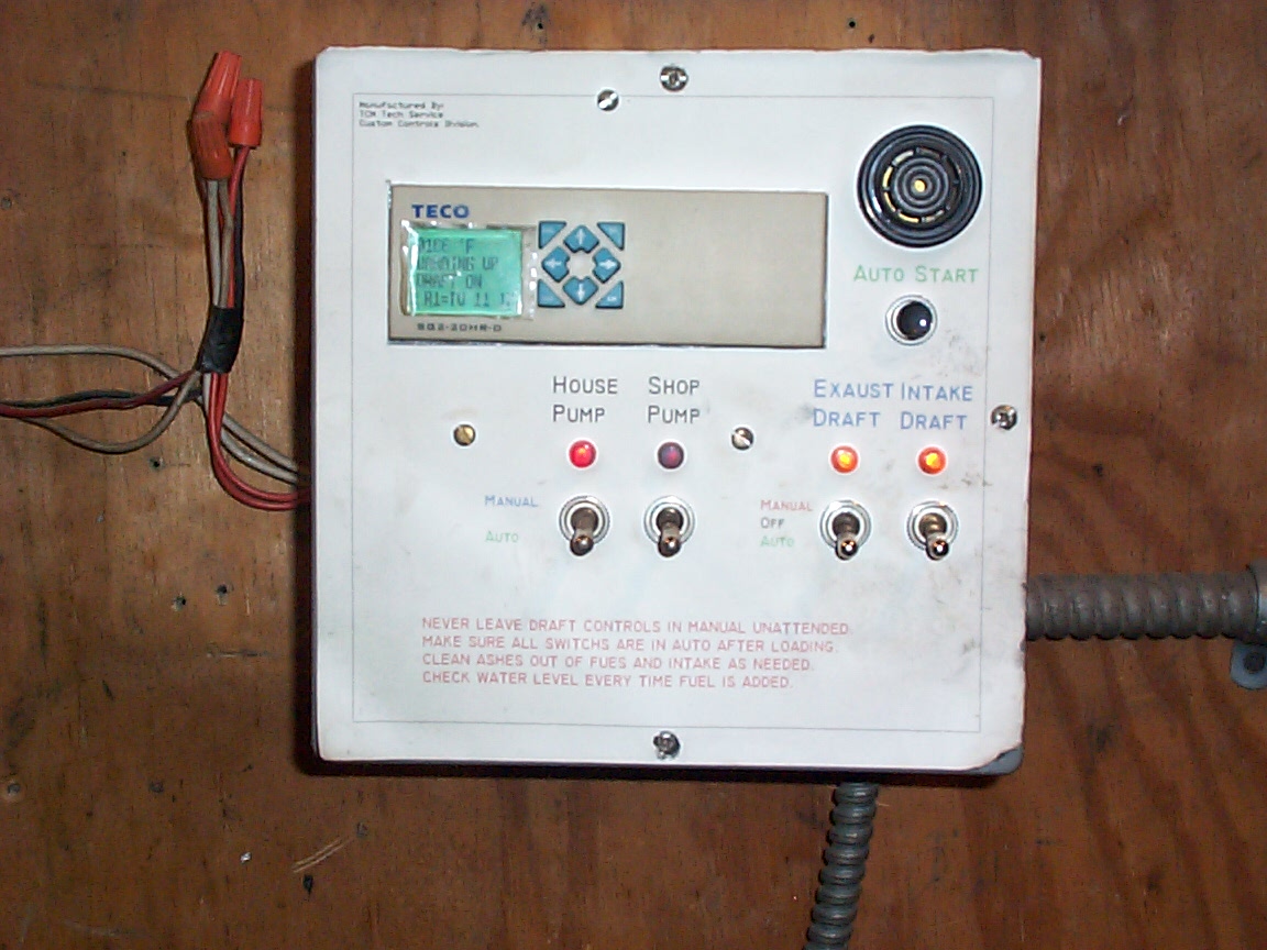

The picture is of my digital boiler controler system that uses one.

I was hoping someone would see this and think about it. If your a big corporation with a ton of stuff to monitor then you definitely need the big gear.
But if your more like me then its far different.
Why pay $500 for a pool filter timer when you can put a PLR on it for far less and have way more function and control over it.
Its why I used one for my own boiler control system. With 8 relay outputs and 8 line level inputs plus the 4 analog inputs its still over kill. But I have high good repeatable accuracy.
Plus once I wrote a basic wide range function program it can actualy figure out what the BTU content of it current fuel its burning is and adjust to it automaticaly.
From garbage to high grade coal and anything in between it can find that ideal burn rate so it burns clean!
Granted it took an entire winter to revise and adjust to program to get to that point!
